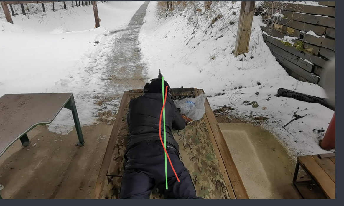

Several things (I’m sure there’s others, just first glance).
First video, you’re not straight behind rifle. You’re twisted up and also have your head rolled over.
Second video, you’re pushing/rolling your shoulder forward and it also appears to be a heavy load on the bipod on that lip. You do *not* need a lip or edge to load a small amount of slack. You’re liking tensing up and giving the rifle nowhere to move which causes the big hope.
Red line is what you’re doing. Green line is what you want:
Thank you sir. Good to know my mistakes.
I will provide some feedback after my next range visit. Really appreciated your comments.

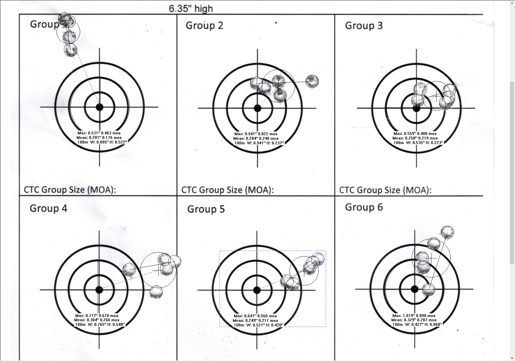

I don't have a video, but I've got a bunch of targets that look like the one below.
The three shot group on the left involves some blading and my left hand on the fore end of the rifle, pulling it into my body. The group on the right was an attempt to get square behind the rifle, manage the rear bag, etc. That's pretty typical for me - shooting off a bipod gives me tight vertical, and loose horizontal.
Those targets make perfect sense for someone who is used to (and good at) blading and holding the forend. When you did that you got a solid base and got the rifle connected to you the same each time. You’re connected to the ground and the rifle is connected to you.
When you move to square and using the rear bag you’re probably replacing the rifle’s connection to your body by connecting the rifle to the bag/ground. What you then have is rifle connected to the ground and you connected to the rifle. You can shoot fine this way with practice, a lot of guys do... but you will not control much recoil this way.
Get square and use your back muscles to get upright enough so you can bring the rifle in front of your face. Then use your firing hand to pull straight into a relaxed shoulder. That’s taking the place of your support hand connecting the rifle to you. Your aim comes from where the reticle lands when you pull straight in. No steering with your firing hand or with the rear bag. Move your body if you’re not on target.
Watch my feet/hips shift in that video before I fire the rifle. That’s me adjusting my aim to make sure a straight pull down the line of the rifle lands my POA right on target. That is a true NPA. Don’t use the bag to aim. Use your body to aim and use the bag to make the reticle be still once you are on target.

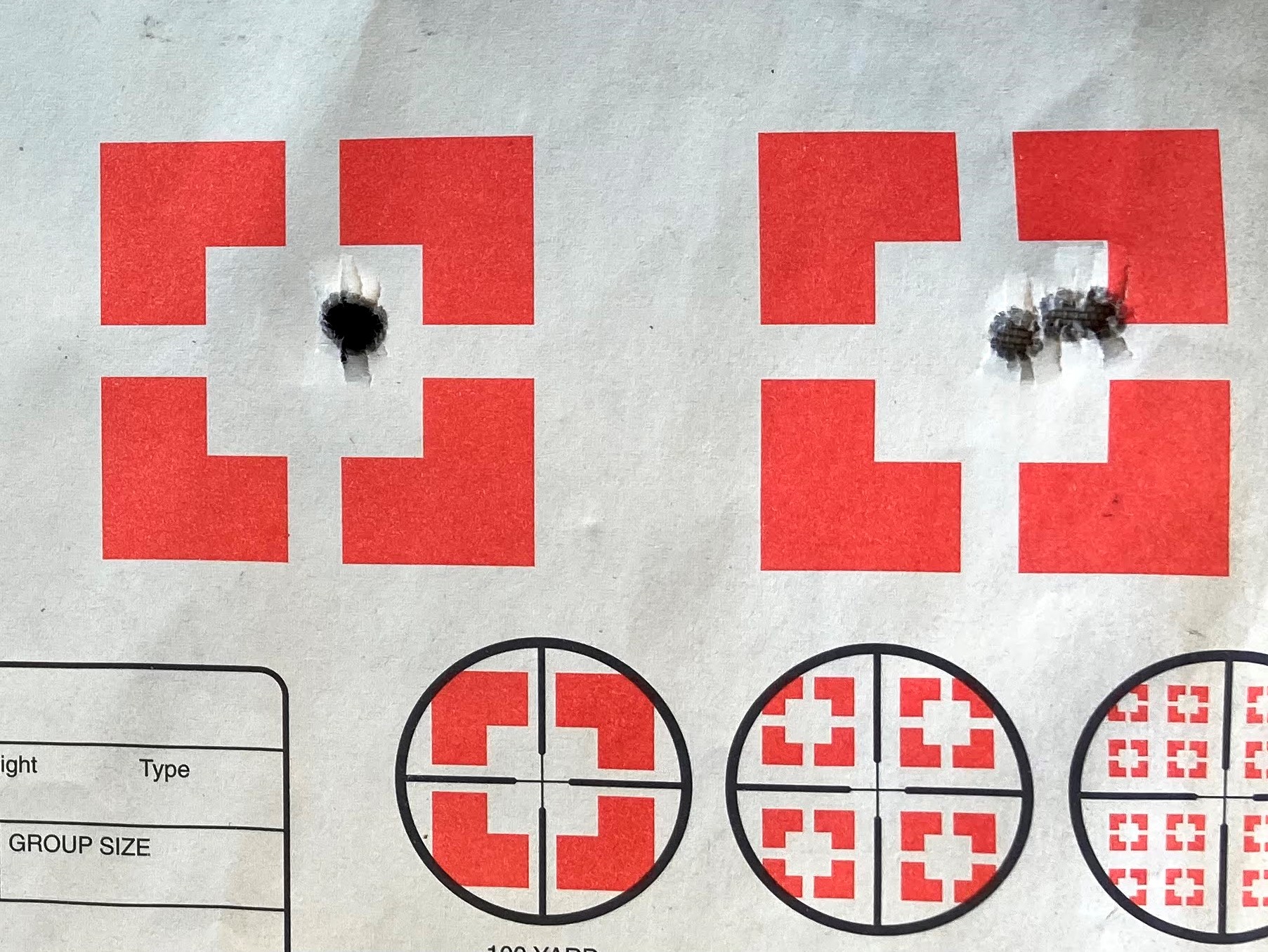

OK, other end of the spectrum here - .22 lr I've been trying to improve my fundamentals for about a year now but I've run into a wall and am not improving :-( frustrating ! Shooting prone, bipod and rear bag, 100m. I notice that my natural POA is not perfect. After a shot my POA has changed, usually by 0.1 mil or less but sometimes as much as 0.2 mil. These are nearly always 'high' compared to the start POA. I have tried changing my shoulder/butt height, my preloading, basically everything i can think of but haven't found out what the answer is. Is there an accepted correlation between fundamental errors and change in POA?
One thing i picked up from the discussion above was the idea of "To control recoil you’ve got to use your body as the conduit between the rifle and the ground. A lot of guys use the rear bag as the conduit. " i definitely think of "steering with the rear bag", or anchoring the butt in the rear bag..
You’re on the right track. Think about it. If the reticle is high after the shot then the butt of the rifle had to have moved down. Did your body move down? No. So what happened is the stock moved into the bag more. The answer is one of two things-
1- Less cheek pressure and a better bag (or better bag control) so the stock does not move down and lift you off target. This is exactly why we made our standard bag (now called the EL-Rx) to be more full with the locking fill. The vast majority of average shooters have the stock 100% in the bag and are relying on it to keep them on target. So even if you aren’t perfect fundamentally the bag can do a lot of the work for you. The downside to that is you will have trouble when you get any decent amount of recoil.
2- The better option for recoil management- Use your body as the rear bag. Position yourself in a way that a straight in pull down the line of the rifle puts you on target. That’s a true NPA. So your body is dictating your aim and the bag is brought in at the end to steady that aim. Then you can handle any amount of recoil without coming off target because all forces acting on the rifle are in line with the rifle. As long as your relaxed and allow the recoil to move through you it won’t be reflected back into the rifle and you aren’t adding any out-of-line forces to move you off target.
Not only does this allow for recoil management but it creates consistency and makes you and the rifle like a self contained gun turret that can be set down anywhere and still shoot the same. Too many guys are relying on something on the exterior to be part of their set up. How often do we hear a guy say he couldn’t shoot well because he was on concrete and couldn’t load the bipod? Don’t let outside elements be part of your set up. The surface you’re on wont matter if you’re doing it right fundamentally.

Apparently, if one desires a video shot from the 6 o'clock, one must be more specific than I was...
I'll see about dragging the SOTIC out again tomorrow alongside the -06. That oughta be...interesting.
I'm still on a quest to make the OP look good. I noted I had a tendency to tense my left shoulder and prop myself on that elbow. I lowered the bipod somewhat and that allowed me to more easily get the gun into my body, but seems less ideal from a head/neck perspective...might be my mount is too low. On the bright side, the groups are becoming less shit...so, perhaps things are improving somewhat.
That’s not bad IMO. You do look a little low but it’s hard to tell from the angle. Once you’ve got it you won’t have to readjust after you fire the rifle. Just make sure your connection to the earth is in your core, not through your face on the rifle.
I’ve said it 1000 times but it’s the key to how I shoot- use your back muscles to get your head and shoulders upright enough to address the rifle. If you want to get a little higher try to use that and see how it works for you. You’ll feel your upper core press into the ground when you lift up with your back. That pressure is what my position is built around. Core pressures into the ground while rifle is pulled into the shoulder(not rifle smashed into the ground with your face). So my rifle is connected to the ground through my shoulder and links to that pressure in my core.
Spend some time at home practicing getting into position. That’s one reason I’m all about using back/core muscles. There’s literally one way to do it and it’s the same every time. If you’re propped on elbows or laying on the rifle it’s really hard to do it the same way every day.

Did get the -06 to the range. This rifle is 10 lbs, bare muzzle. I can see that I've improved, and also that I still have work to do.
You’ve got 3 choices- lay on the rifle, prop up on elbows, or use back muscles. If you want to control recoil you need to use back muscles IMO. When you do it right it’s 100% consistent and stable. Im def not saying to strain to lift yourself up. It’s just enough to press your core down and make an angle to get your face and shoulders up to address the rifle without laying on top it.
Again, your core pressing into the ground as you lift up becomes your base. So while you are using your back muscles, the rifle is connected to the ground rather than those muscles. People will tell you to totally relax when you shoot. That’s not reality because you’d be jello. The closest you can come to that is what you’re doing. But when you totally relax and lay on the rifle you have to use your neck muscles to support yourself. I relax everything except my upper back and my right bicep. My neck is only doing what it would do any other time which is not letting my head flop over.
ETA- the vid looks pretty damn good BTW. Definitely a little low and on the rifle though. Just keep working on creating a base to connect the rifle to rather than connecting yourself to the rifle.

I gave things a go this weekend with my 8.25 lb 7mm RM. Just wanted an azimuth check after dropping it in a new stock (.8 mil left was the answer, no bedding yet). I got it right on the fifth shot... my whole body cycled like the slide on a pistol and right back on it. Not saying it was necessarily pleasant, but no bruising at least.
I shot an F-class match with my KRG off my CAL and a rear bag this weekend. I was definitely the only guy square behind the gun, heh. It wasn’t bad though, being the first time I’ve ever shot paper at 1000. Lots of bad wind calls, but I was handling the gun passably.
Things are coming along, still a ways to go for consistency.
Now you’re on to it. Body cycling is the mechanism used to expend the recoil. This is why squishing the stock into the bag is so detrimental to recoil management. The rifle is pinned to the ground rather than connected to you. You’ll never get the recoil into your body like that.
