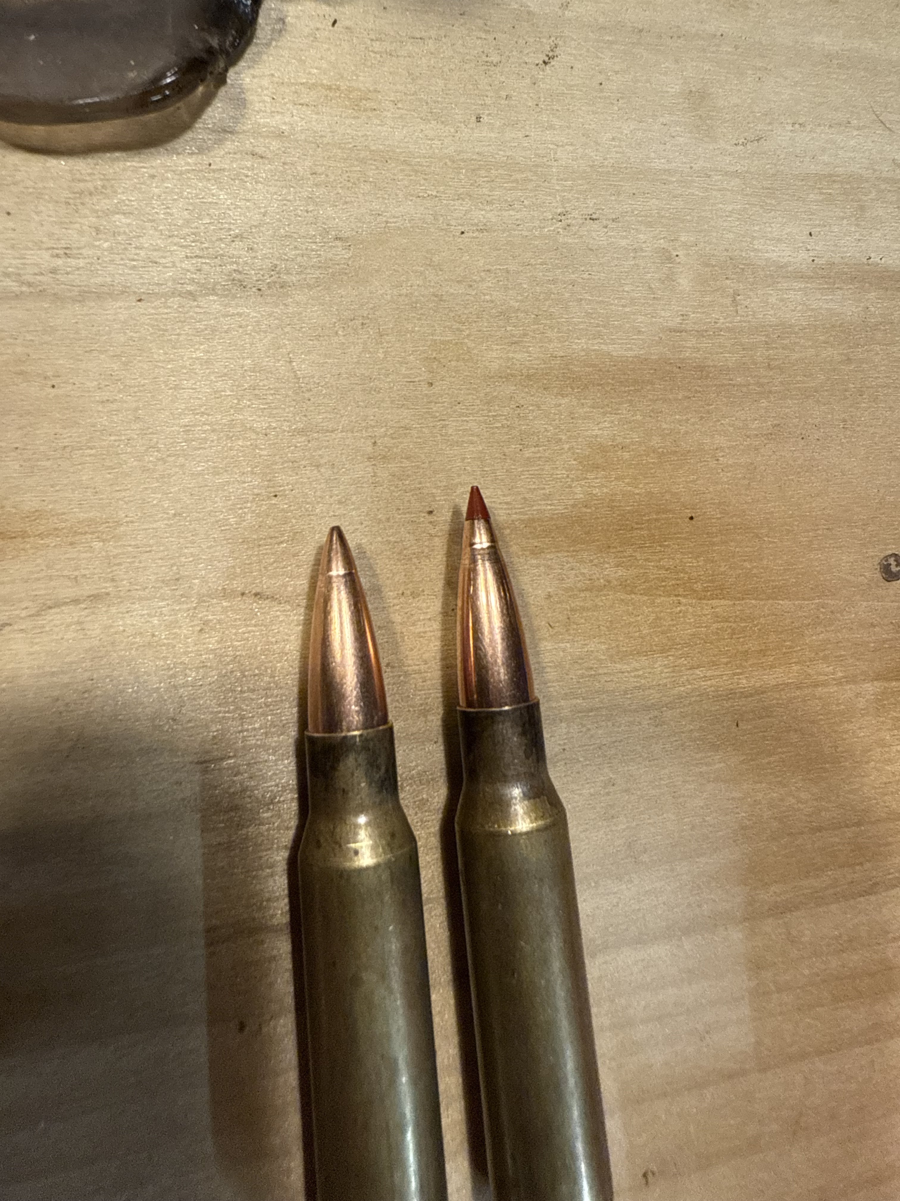

This is no where near acceptable… 169gr SMK on the left, 174gr ELD-VT on the right.
My guess is the seating stem has to narrow of a “cup” for the nose of the bullet? What’s the best way to resolve this? I have heard you can get different stems for different bullet profiles?
Depends who the seating die is from. Hornady is one who offers stems for various profiles. Unlike RCBS who does not offer stems, and wants your stem and several bullets plus fee.
Or a drill, diamond lapping paste and some bullets and hone it yourself. I chuck the bullets and hold the stem. If you have a lathe even better.

You experiencing quite a bit of pressure when seating those bullets (which might not be felt when using presses like Forster's Co Ax)?
What I did to elevate any ring from the seating process is to spin a bullet coated with some polishing compound into the seating stem, using an electric drill. I no longer have this issue, even when seating is firmer than it should be. This is the compound I used:https://www.amazon.com/dp/B072JR2B6K?ref_=ppx_hzsearch_conn_dt_b_fed_asin_title_1&th=1

That's a lot of neck tension. Is this for a semi auto?
The seater is only making contact in that small area. As stated, you can lap it, or try a dab of JB Weld with a release agent on the bullet. Leave the bullet in the seater until the JB Weld cures. That's how a good friend fixed this issue.

What is your sized case neck diameter? What is your loaded neck diameter. Looks like excessive neck tension which is pretty common with big box store dies to work with all different types of brass....
I’ll measure and post it up when I get a chance. I recently started weighing and sorting all components, and noticed the M118 brass is HEAVY. So that may have something to do with the neck tension being higher? Just more meat in the case shoulder and neck?
It could have thicker brass in neck area.
Another thing is that everytime you fire brass it gets harder which can affect neck tension.

You can apply a small amount of JB weld (or similar) inside the cleaned seater stem and gently insert a bullet by hand to make a perfect fit. Cheap and works great.
Hornady ELD bullet, ....Hornady seating die wirh ELDM seating stem for eld bullets, should work pretty well, and probably for the SMK too.
If ya don't want to buy the die or the new die has somewhat of a problem then, to the lathe and polish the seating stem.
I start with fairly coarse carbide lapping compound, on the bullet with the seating stem in a lathe collet.
Then finish with a polishing compound
It shouldn't be off enough to grind a tiny boring bar that matches the bullet profileI, then lapp if that's the case.
