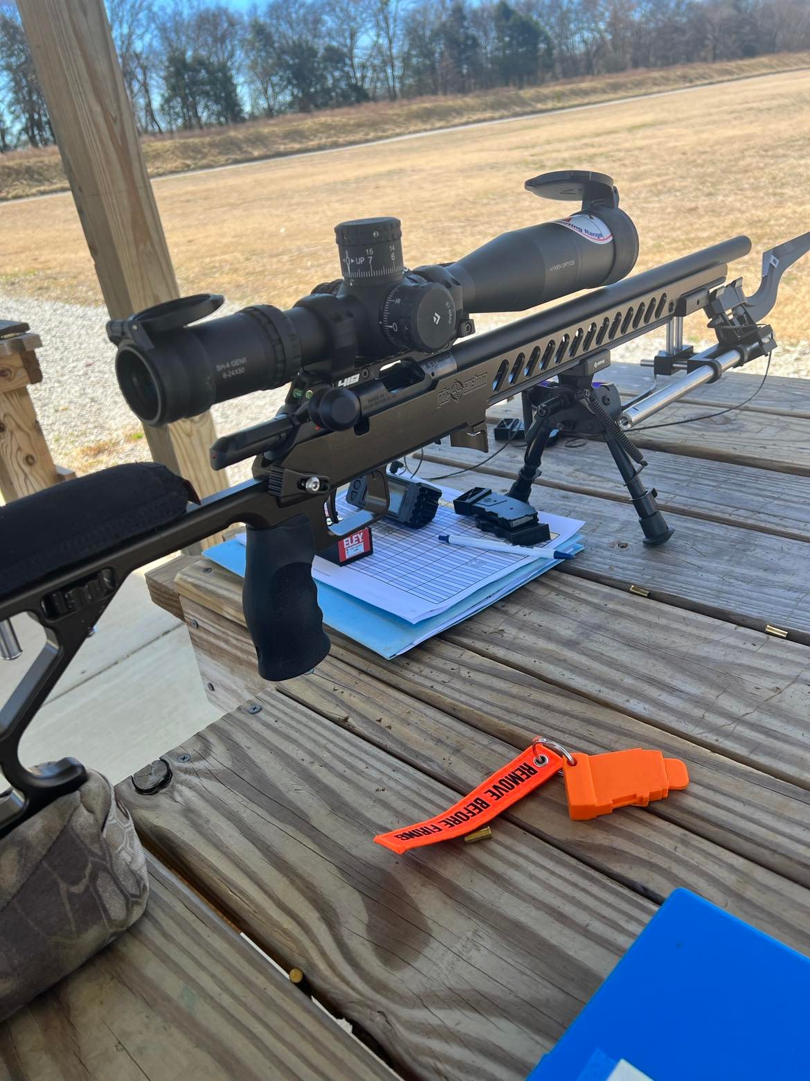

I use the MK Machining Gen III Magnetospeed Mount (With 12" Rod).

Which mount do you run on it? Arca? I just don’t want it attached to the barrel.
I don't have a mount for mine. I shoot a ladder test to see which nodes I can use for a particular powder. Then I zero the rifle and see what the group is. Even if the magnetospeed does affect the POI, it hardly matters to me when load developing. Once I'm satisfied with the load, I can quickly zero. Takes a few more rounds, but I don't need to chrono that often to justify the ARCA mount. If I did, as another poster posted, I would go with MK Machining.
