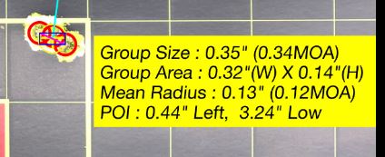

I shoot a Tikka CTR in a manners. Stock barreled action though. I have confidence in saying it is for sure half moa rifle. With majority of groups below. If I could figure out how to post pics I’d show a 5 shot group that measured 0.3 moa that I shot this weekend.

3-shot group from my TAC A1 at 100 yards with bulk american gunner ammo. I can easily recommend the Tikka.
