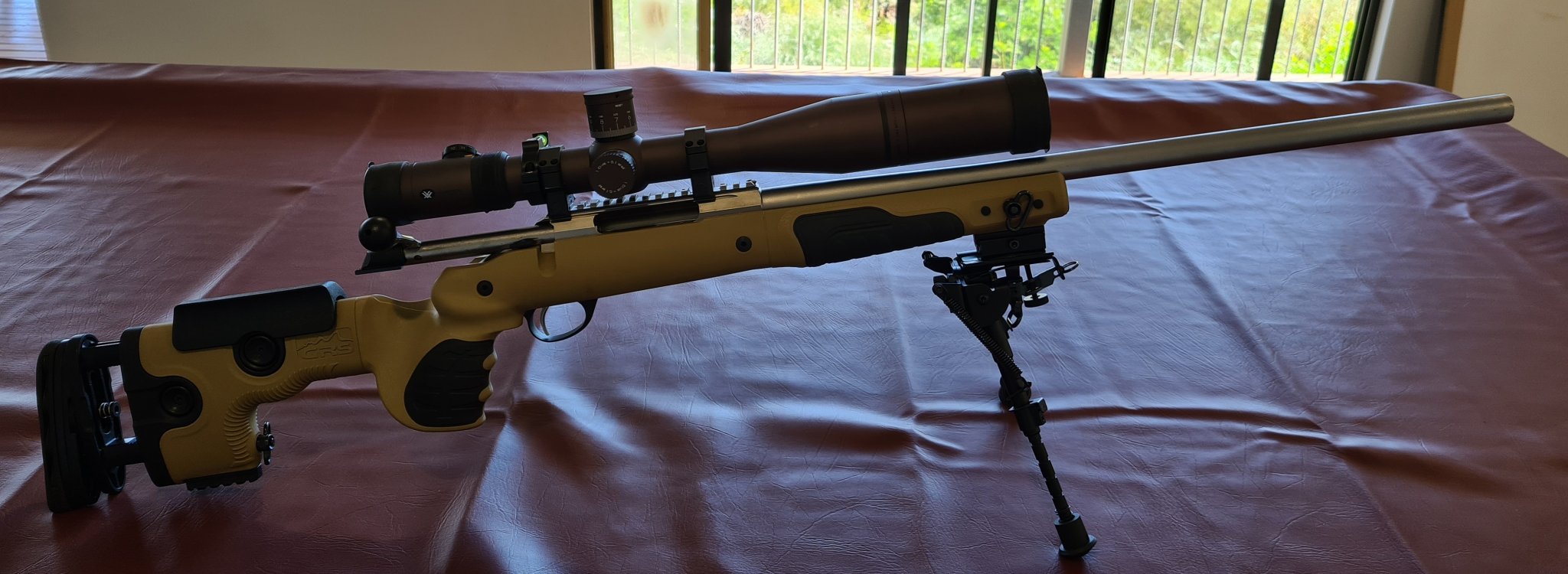

I've always leaned towards more traditional hunting style rifles, so bought the Super Varmint in 6.5 Creedmoor.
I have no regrets, it's an outrageously accurate rifle.
I will be buying a GRS BiFrost chassis for it, shortly.

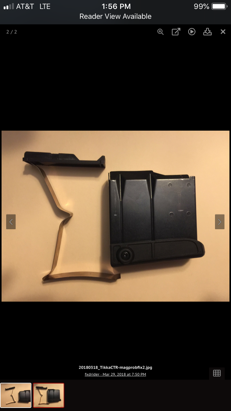

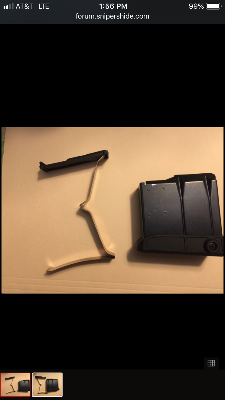

@dski and @sboone, a simple follower spring bend would solve your tikka magazine issues. It’s been posted many times.
Make your spring look like this with a pair of needle nose pliers. The rounds will present to the chamber like they should.

Thanks for the heads up, unfortunately this is in fact not the reason for my issues. I'll take a pic of the current bottom metal in a couple days, new stock should be showin up soon so I'll have everything apart. The bottom metal I currently have has had the sides of the magwell machined off so that itd fit into the B&C M40 stock it was in. The magazine is effective supported on the sides by the aluminum bedding block of the stock which were also milled to fit. The BDM only supports the front and rear of the mag and the front "tab" that is left occasionally gets bent forward allowing the mag to dip down in the front.

Absolutely stoked with the Bifrost stock.
It is heavy, but a total joy to handle.
No regrets at all.
I've found it to be the most comfortable stock I have used.
The construction is plastic, I believe to be HDPE, so it's tough.
Combined with the fibre, it's rock solid.
My 6.5 Creedmoor had marginal recoil.
Now it's almost non existent.
The ease of adjustment and comfort has swayed two friends of mine to purchase it.
Whether stalking through scrub, or prone on a vantage point, the ergonomics really excel.
Standing or kneeling, I use my rifle strap and the canted butt pad sits perfectly where I need it.
I'm guessing for PRS comps, I'd just bag it on structures.
For the price, it's worth every cent in my humble opinion.

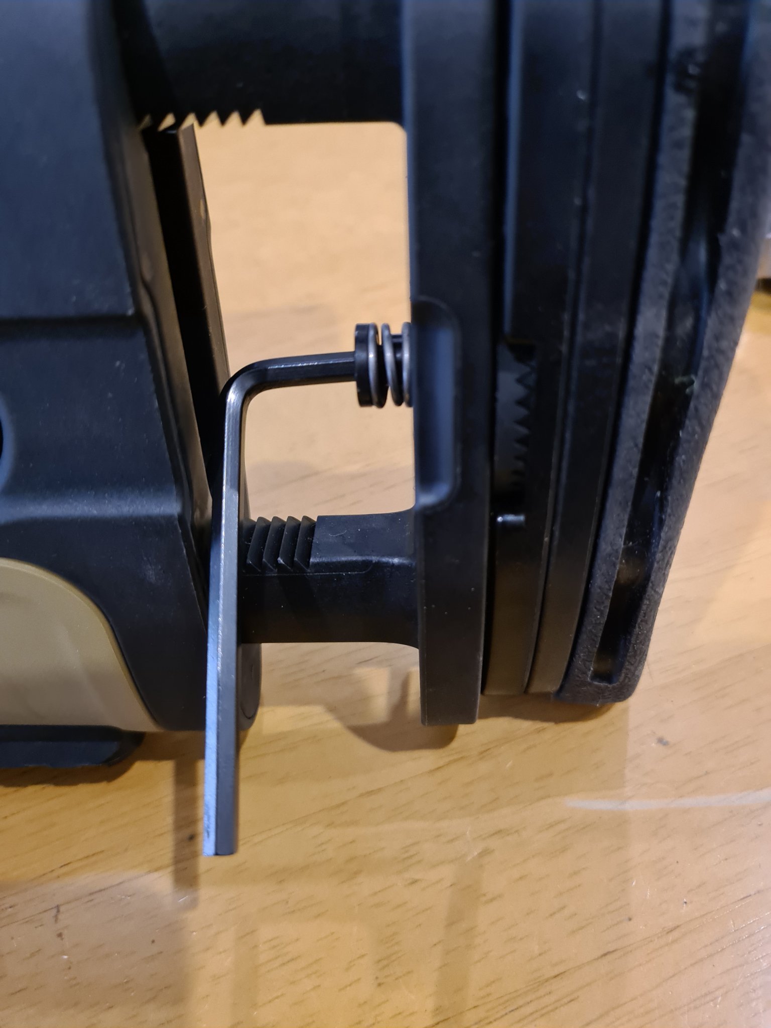

@GrumpyOleFart - thanks for that. Is there any play in the spacer/buttpad assembly on yours?
The channel in mine that has the locking wheel for the cant adjustment tilts back and forth ... not sure if it's meant to do that or not - and if it would affect precision at all, seeing as it's a moving part, right where I want things to be locked in ...
You can use an Allen key to tighten it a bit, if you feel the need.
