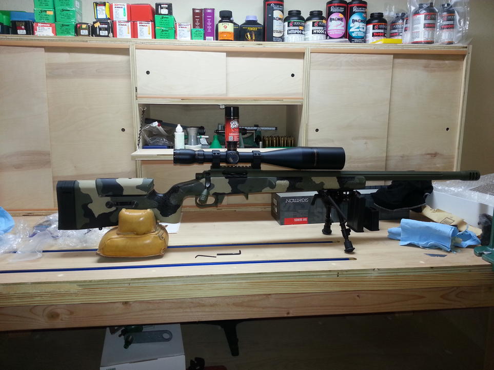

If your not going to be shooting multiple strings of rounds in a match and all your going to be doing is punching a few holes in parchment or poking at a deer here and there, then forget about a brake.. The .300WSM doesn't recoil all that bad.. If you plan on layin' it down, just like RHutch said, what is your proposed finish length..? I know a #3 Bartlein at 16.5" is damn there .75" in diamater.. (Latest project)
