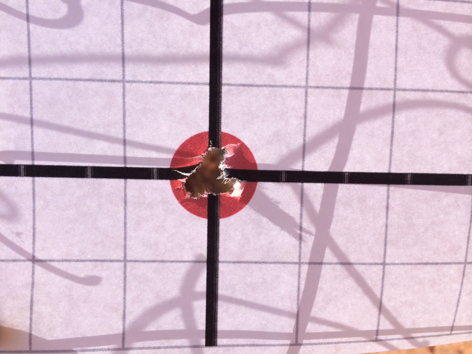

I have three savages a older model 10 in 223. The wife shoots a 7-08 and I just got the 10-fcp with HS precision stock 5r rifling
All shoot half inch with factory ammo.. New 10fcp is in 308..

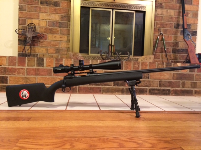

This was an economy build and will be a trainer until my skill level justifies something more expensive.
It shoots better than I do the trigger works but it takes some getting used to. I am not sure I will keep it:
