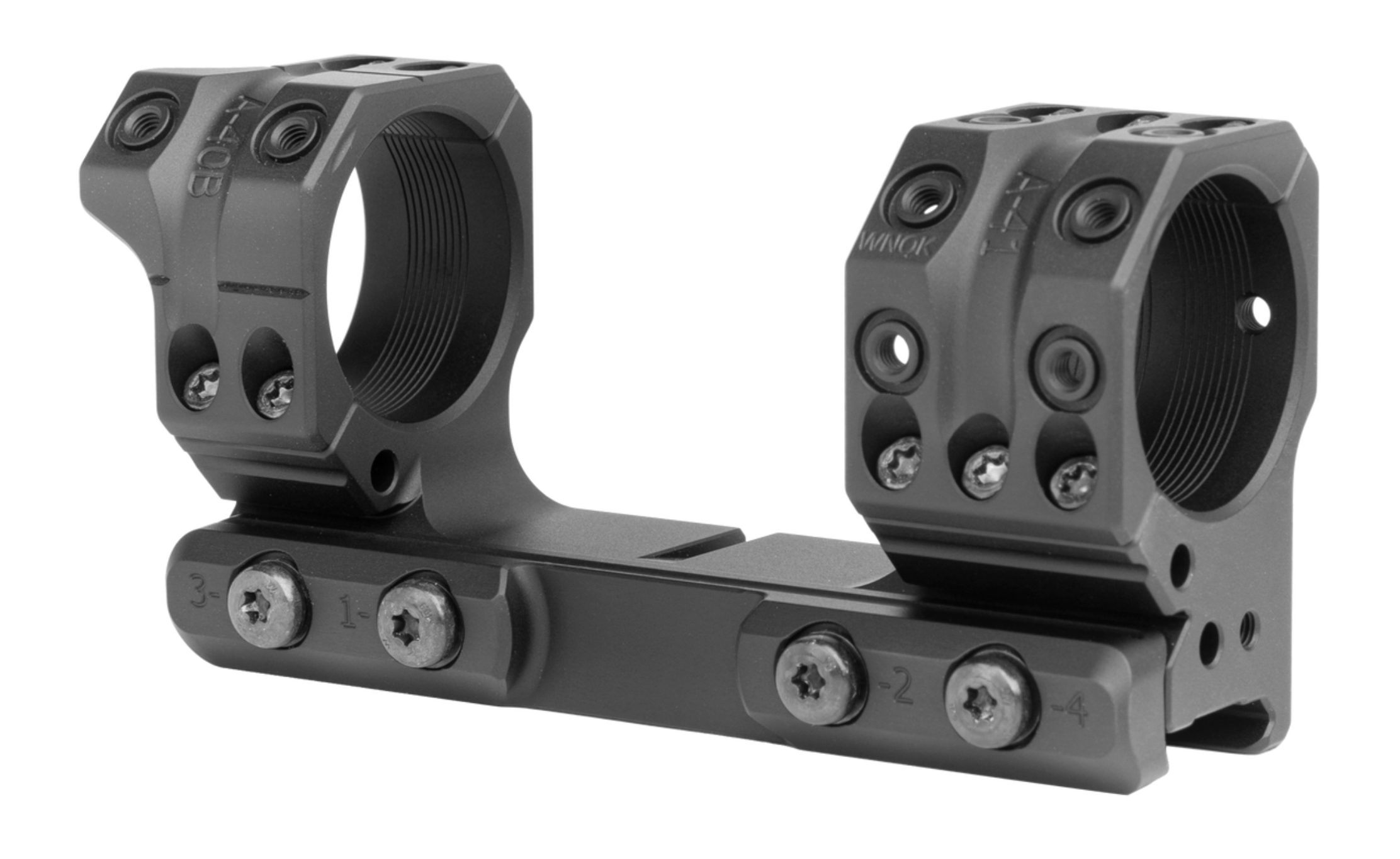

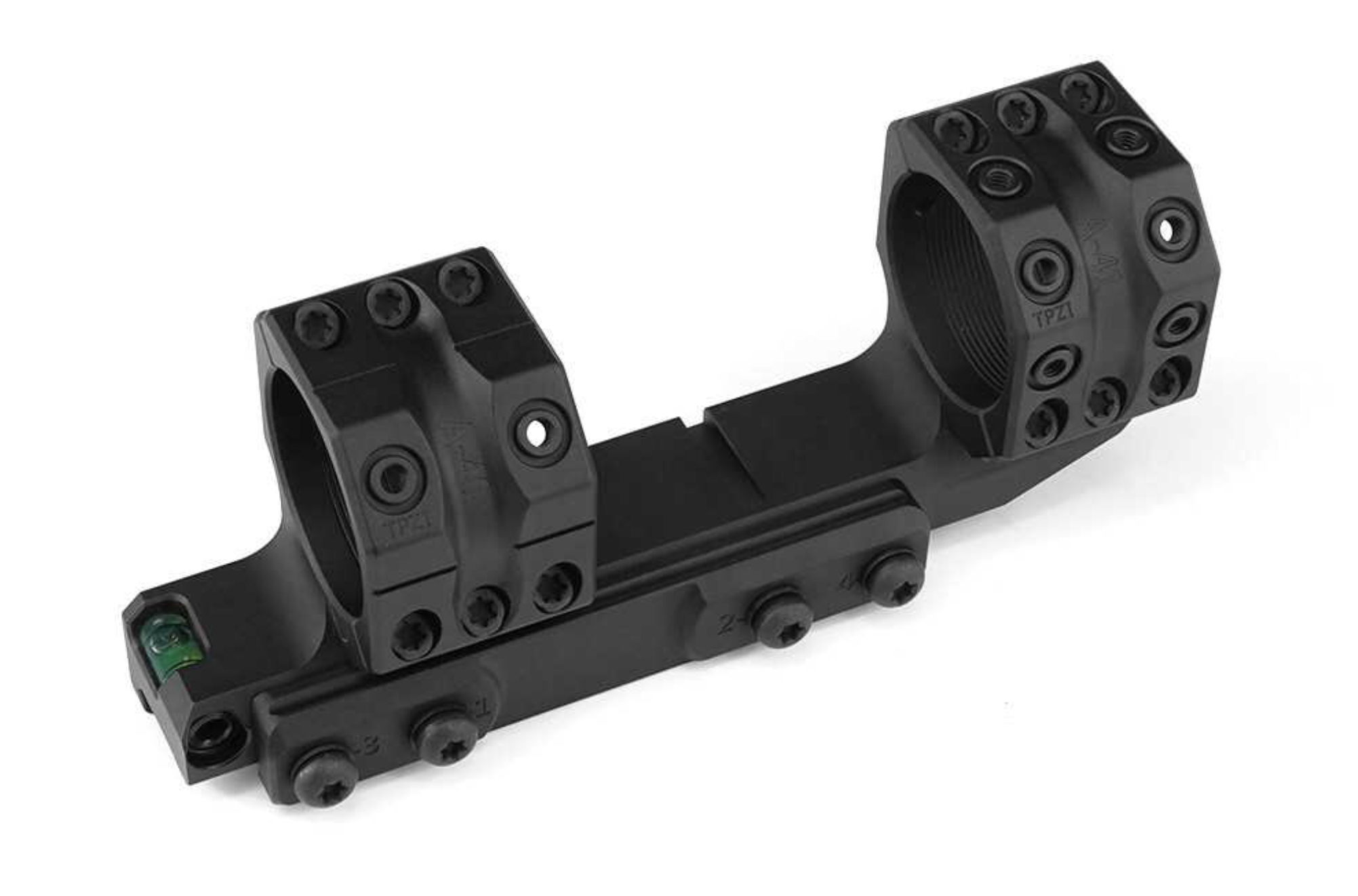

As the title says.
1) The original blocky, squarish layout
2) The second, “ribbed” design
3) The most recent iteration

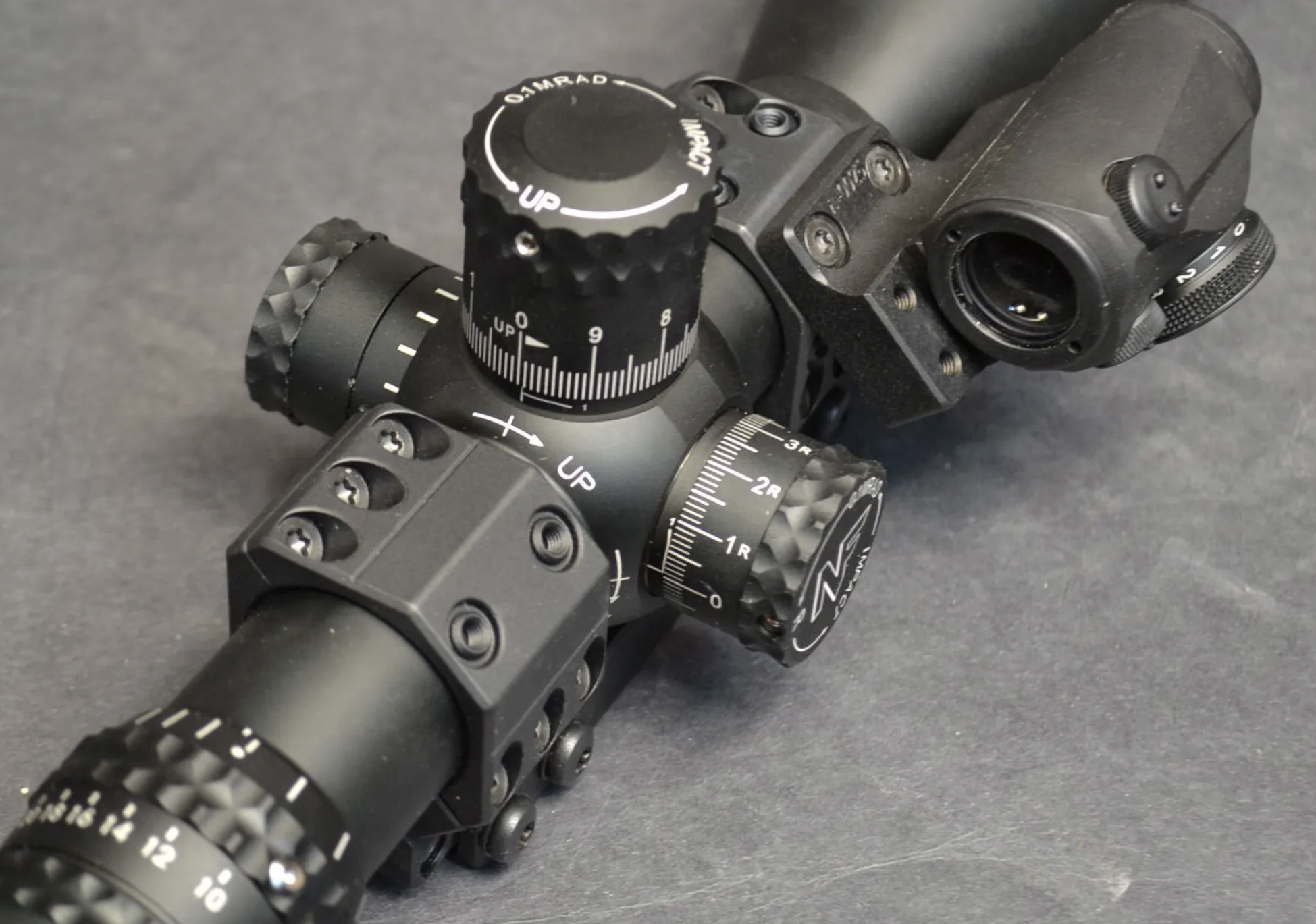

I originally only had one, a gen 2 1.5" 30mm 0 moa in fde. worked amazing for me. then i remounted it and the crossbar broke. i had to send it in but milehigh took care of me.
after this i was kinda turned off of spuhr for a while, but something about spuhr made me want to keep coming back. they just exude quality both looks and feel.

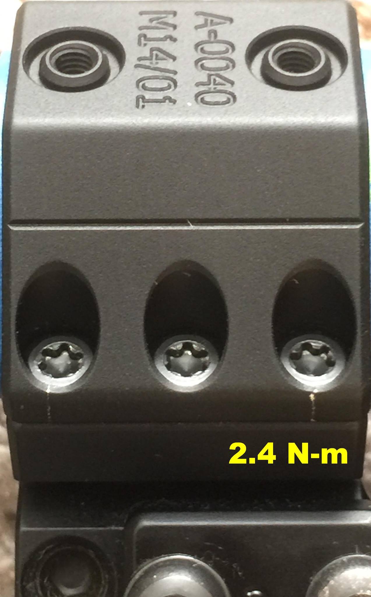

so i've decided to go all spuhr now, and my plan is to stick to 20 in lbs max on the rings and 25 in lbs on the crossbar.
i believe the spuhr design provides plenty of clamping force at these torque values where the 25/45 is purely just way too much.
we will see how this works out for me, i will update this down the road

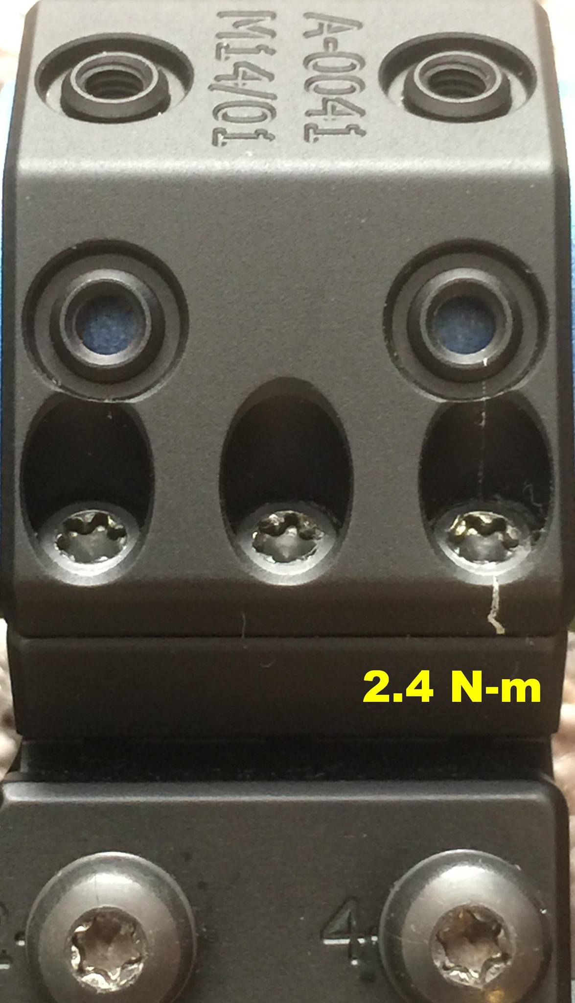

The higher torque specification is possibly due to the greater surface area afforded by the rings on the scope body.
Unfortunately, the small, conical wedge - shaped screws also behave like…
…wood splitters, concentrating a lot of pressure on a very small area - quite the opposite of what the wide scope rings do.
Personally, I think this is a design flaw.
The replacement cap I received on the left had noticeably larger screws.
I was lucky enough not to have incurred cracks on the rail clamp.

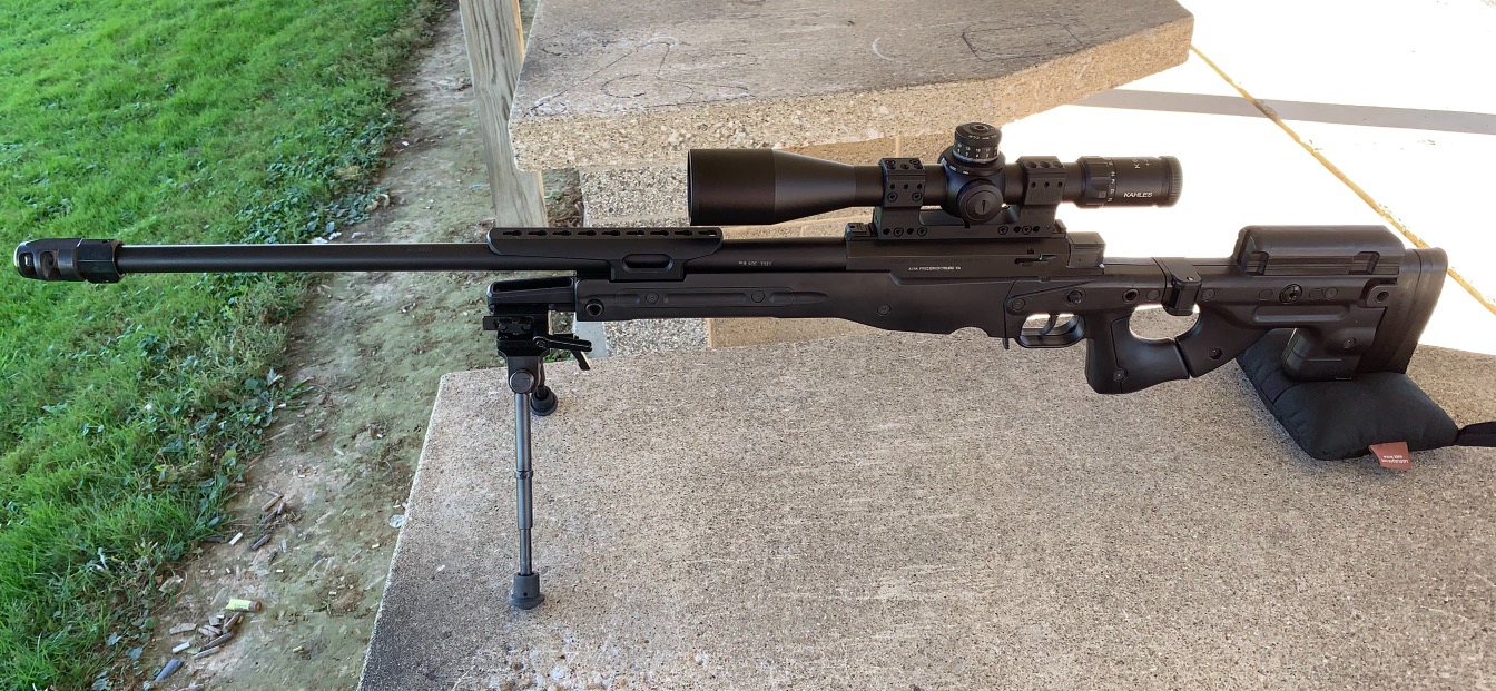

Here’s my 20” 308 with a Spuhr.

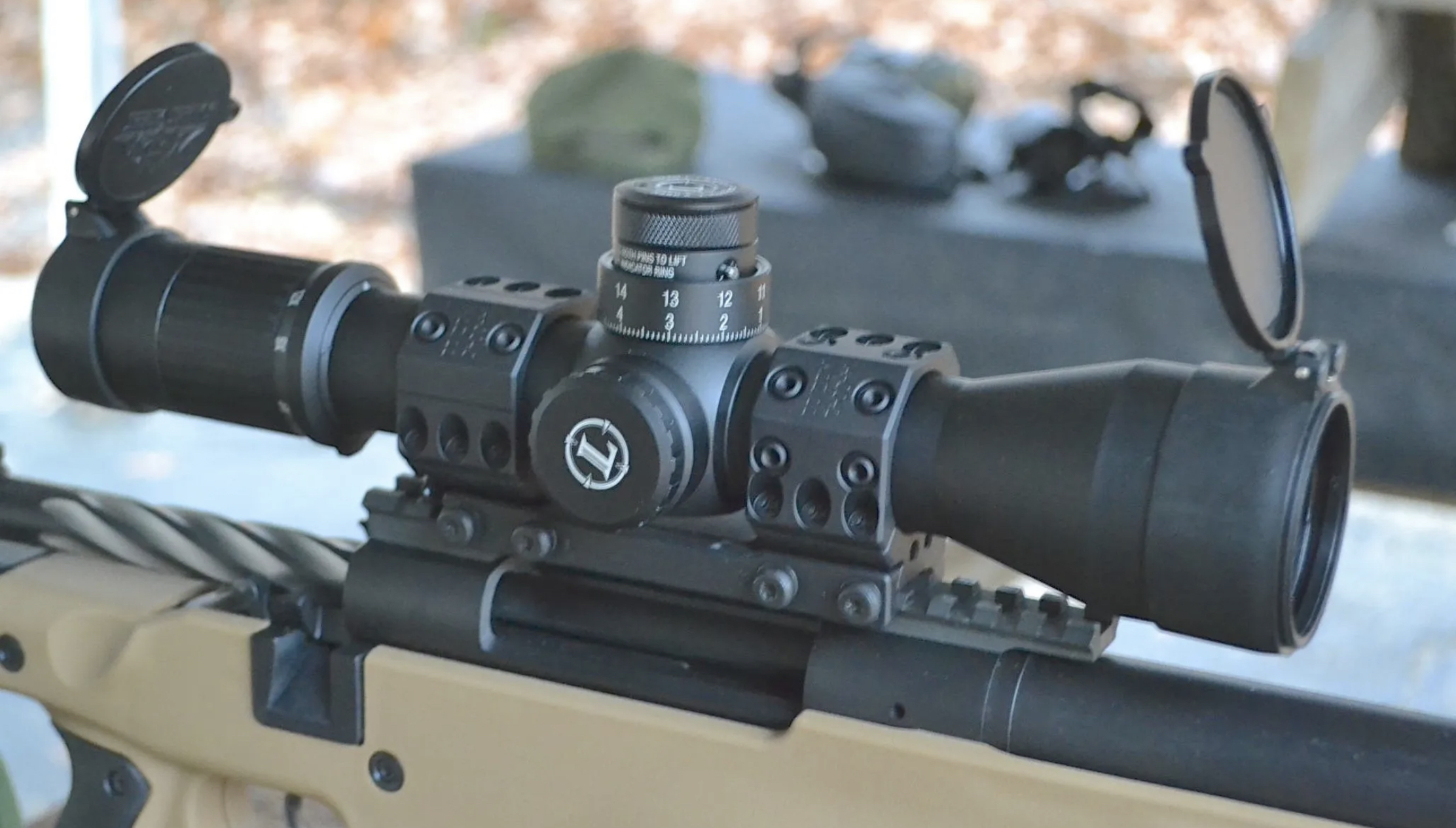

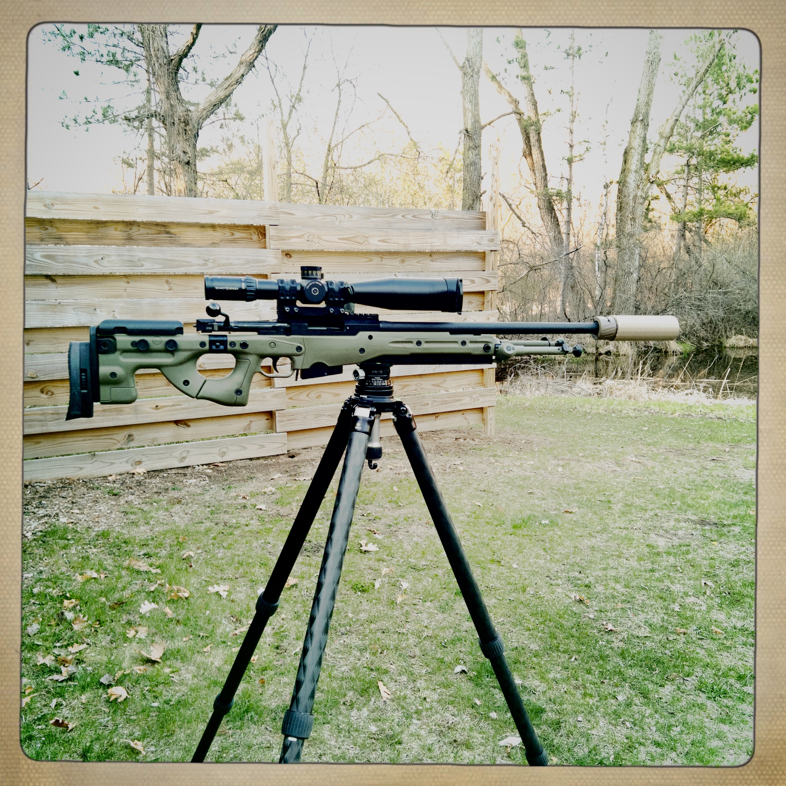

Here’s mine, in .308 as well…
…with a blocky Spuhr.
My very first bolt gun and whipped handloading mule.
Taught me everything I presently know about treacherous chamber dimension inconsistencies and variations under the Accuracy International name.
Surprised I never damaged it with my “proof,” or rather “poof!” loads.
Shoots quite well with its second barrel - burnt out the first one, chasing all sorts of loads - likely a steaming dud to begin with.
