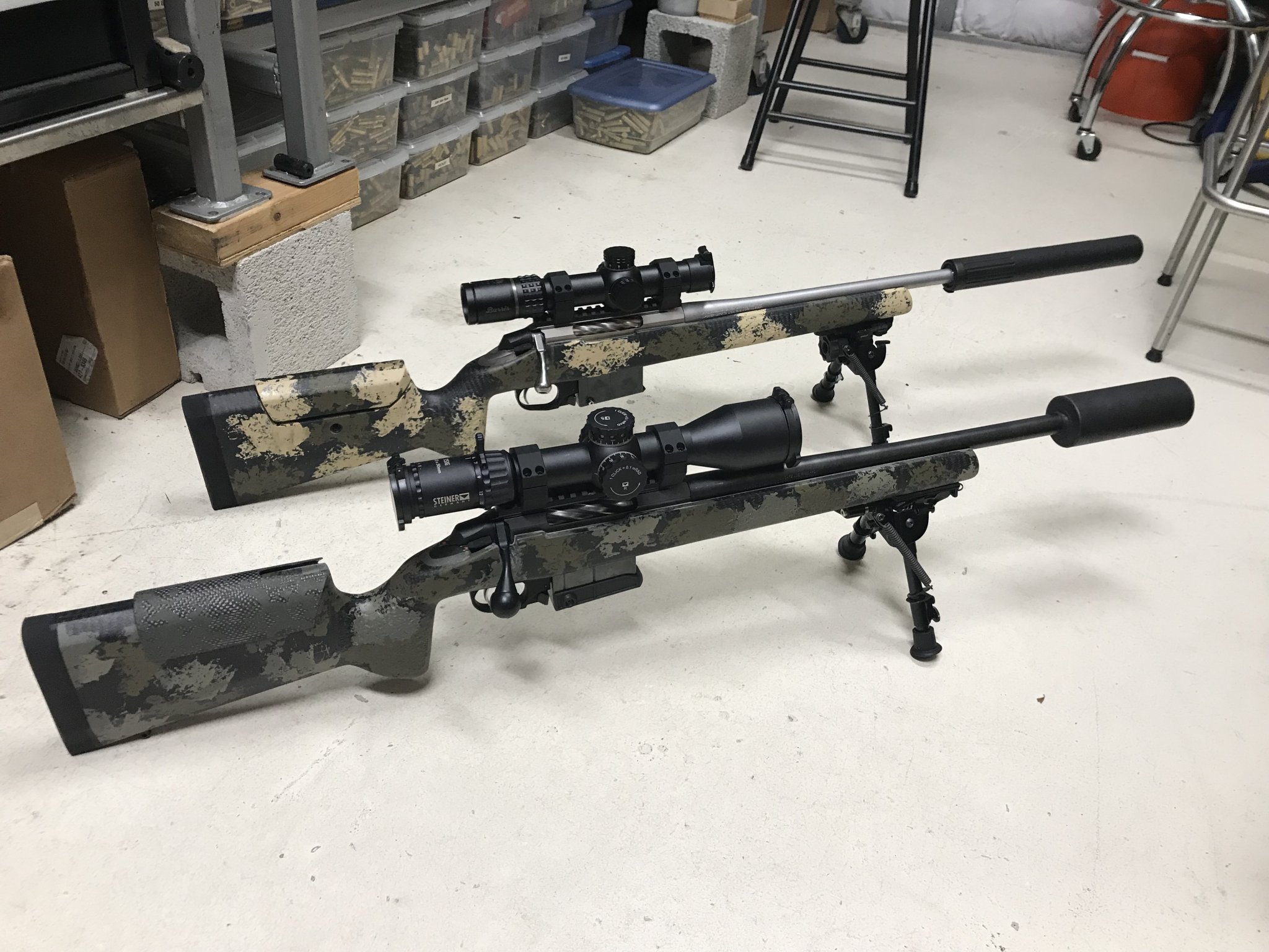

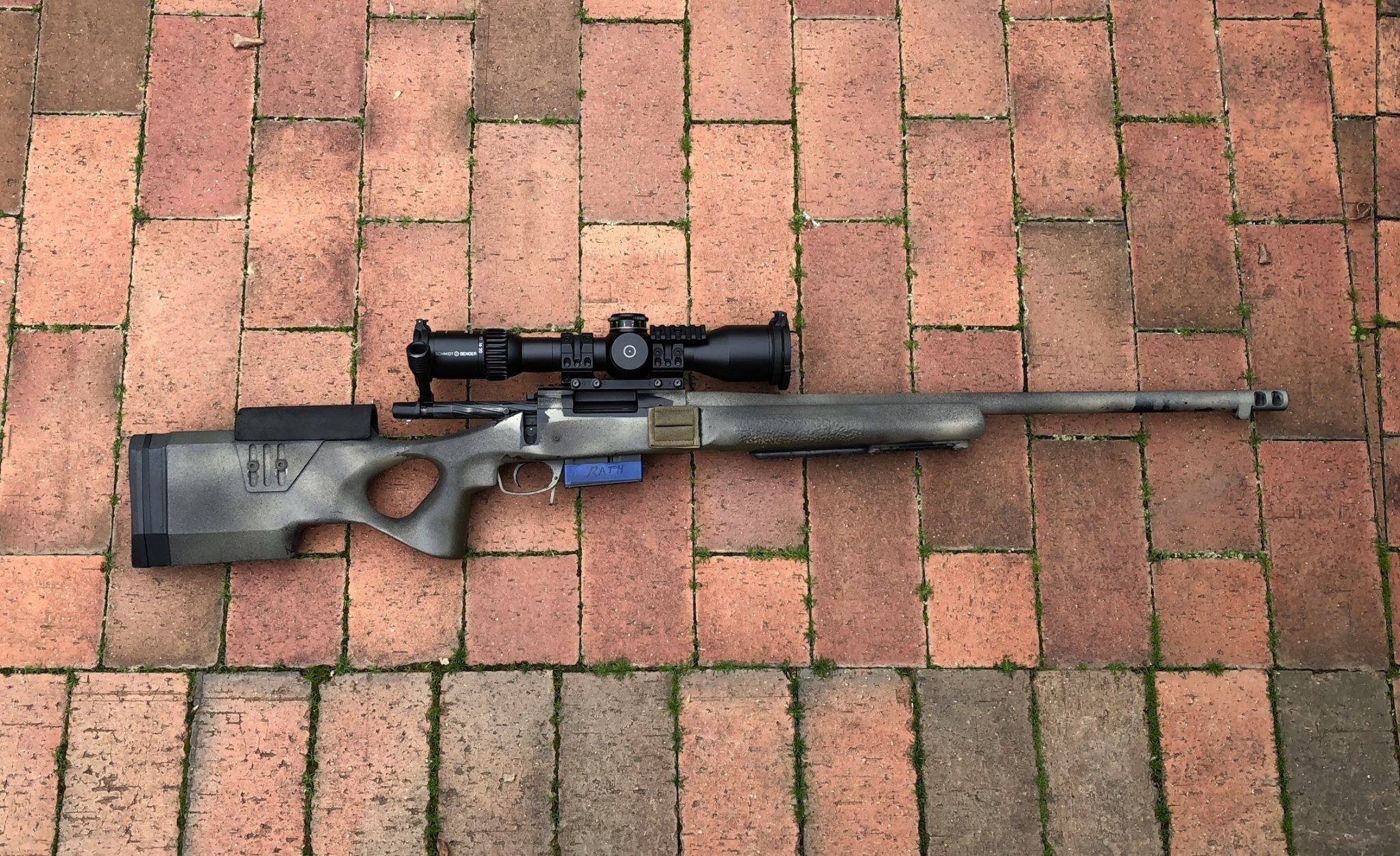

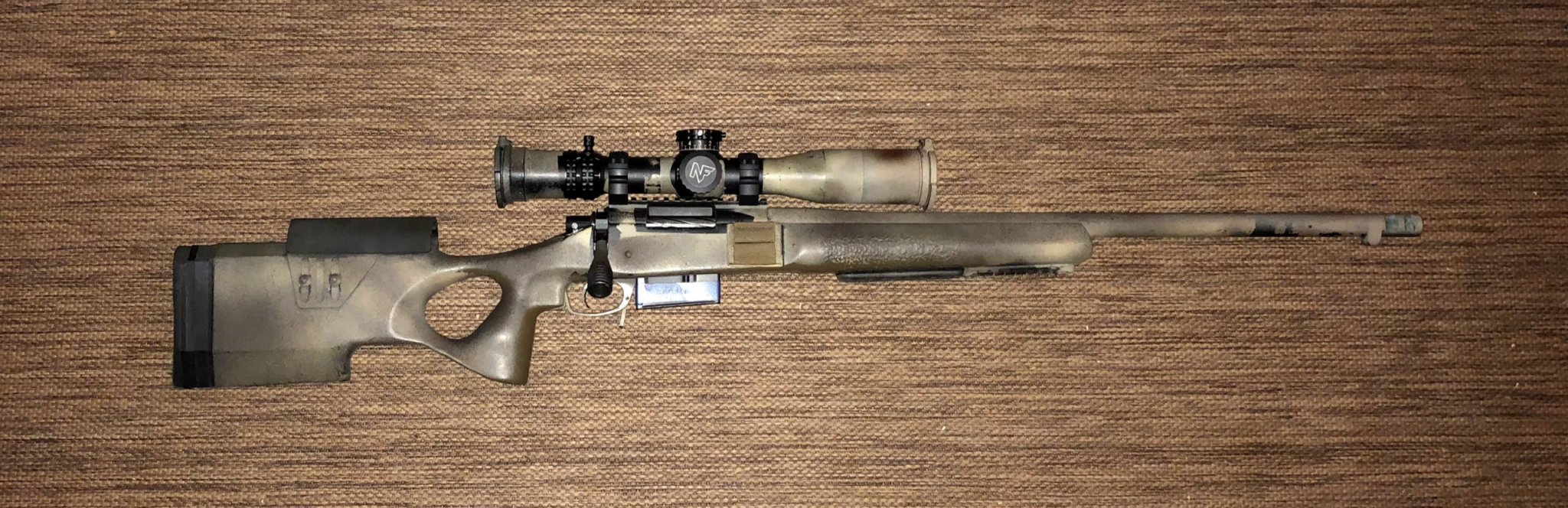

7mm-08 w/1-8 XTR II (top one) for me. Ammo available almost anywhere
What reticle did you go with? And why did you feel you wanted to replace the ATACR?
I went with the MSR, which is a known quantity to me since I had that reticle in the 5-25 I owned. I have absolutely zero intention of replacing the 4-16 ATACR, but it's a perfect fit on my tikka with the Manners T3 stock - the smaller objective matched with the APA low 34mm rings allows me to get a great cheek weld without needing a raiser/stock pack.

Great pair. Can we get the full specs? Barrel contours and lengths, etc?
The top one is stainless T3x 7mm-08 lite shortened to 17” threaded 5/8x24 to be used with aac supresor mount as it indexes off the muzzle and not the shoulder. It’s bedded in Manners eh1a with CTR bottom metal.
Bottom is a T3 CTR shortened to 16.5” and threaded 5/8x24 and it’s beaded in Manners EH1 with CTR bottom metal
What performance are you getting out of the 7-08 with that configuration mate?
Reactions: BallisticPrimate

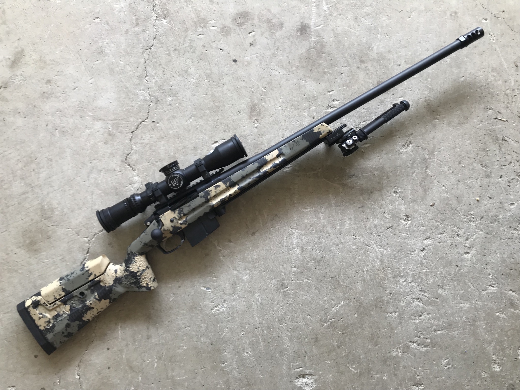

Conjured up and tried a few different builds over the years in an effort to find "the one do-it-all rifle," and have ended up with this. It's a GAP Gladius .308, with a Surgeon action, Manners T2A Elite stock, Jewell trigger, NF 2.5-10 Mil-R, Badger DBM and rings, and a TBAC 30P-1 can. It covers all of my hunting needs, and the vast majority of my target shooting needs.

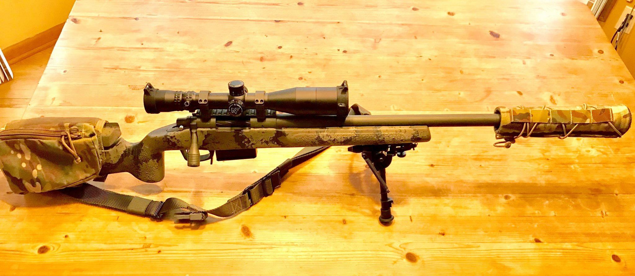

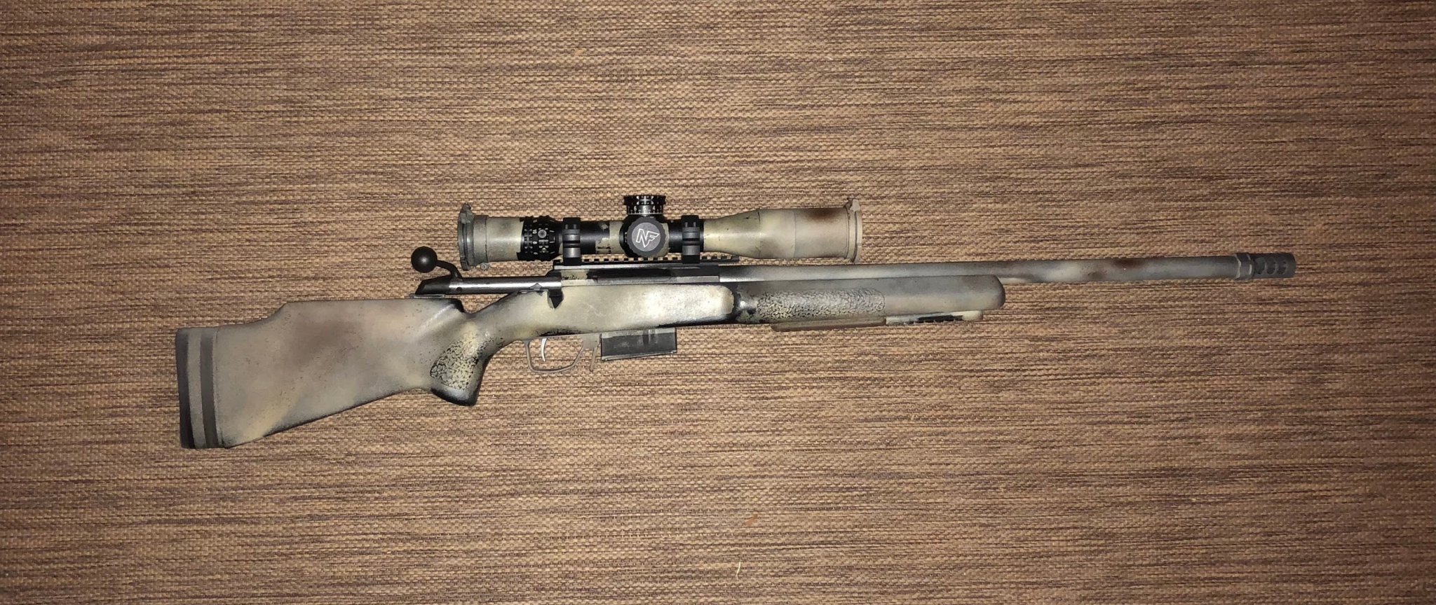

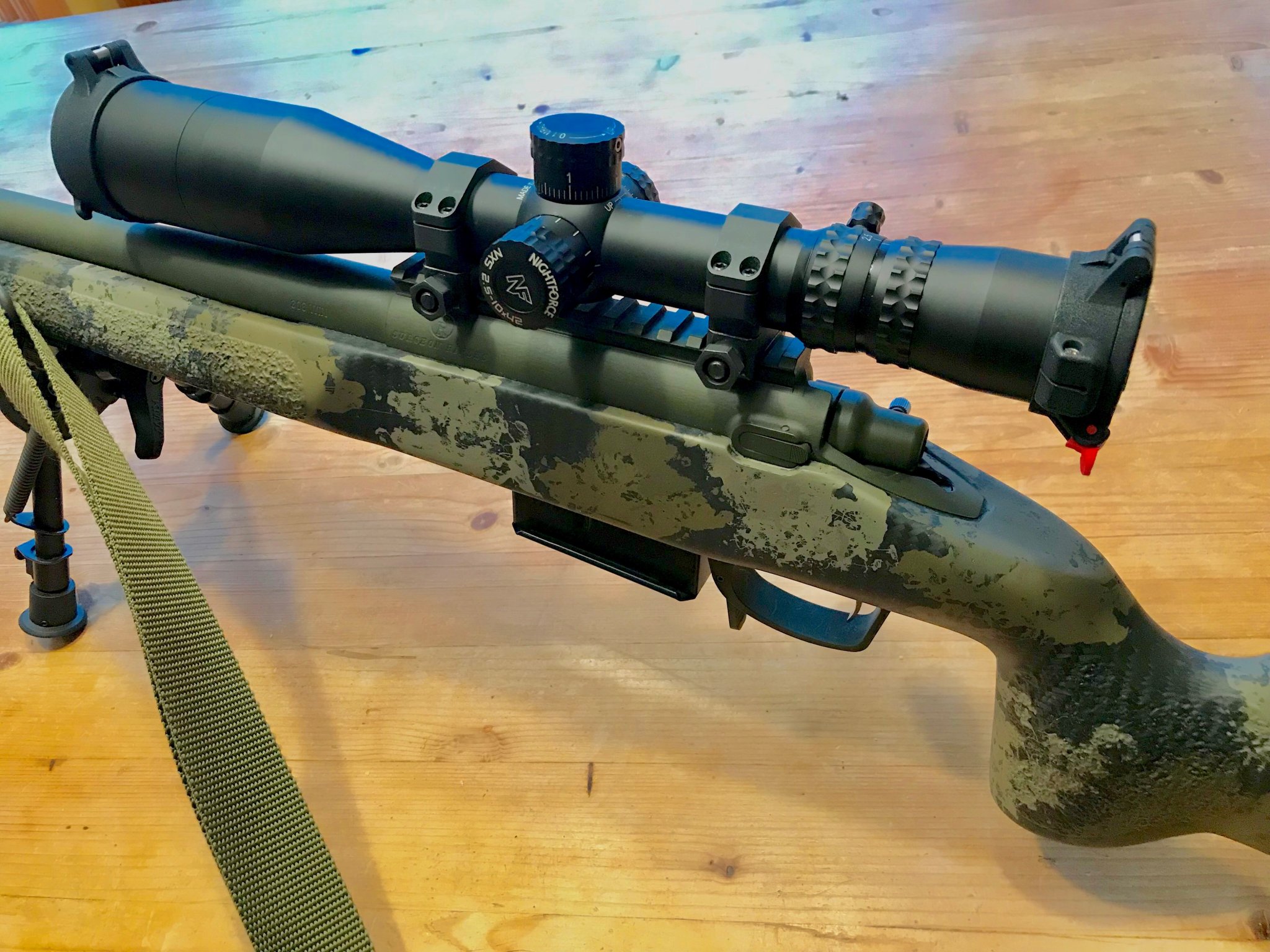

What's the weight on that thing? Specs?
And did you go with a mini chassis? Looks really good
Cheers mate, details are:
- GA Precision Tempest
- Manners PRS2 in elite moss with mini chassis
- 26 inch, 8 twist Proof Research medium palma, chambered in 7mmSAW, APA little bastard brake
- Badger rings with 4-16x ATACR
- Area419 arca stuff
Weight is just under 6kg.
It’s shooting about half MOA groups at the moment with slapped together loads. Needs another hundred rounds therough it before I start load dev. I honestly prefer this rifle to any others that I’ve shot or owned.
