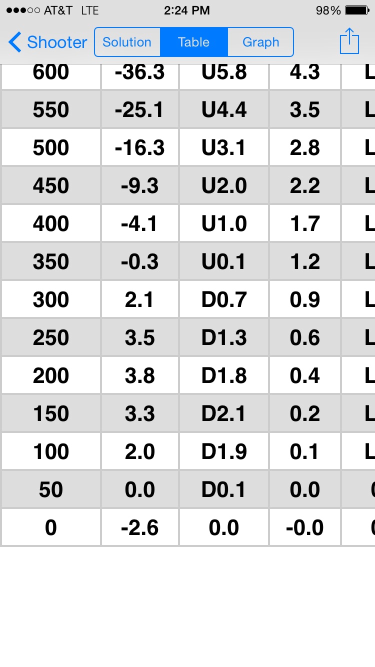

Holy shit I am an idiot. Sorry for not giving all the parameters. I bought my first Thermal, used in like-new condition. I got a smoking deal on it. I got pulsar Apex xq50. This is what I can afford. It is going on an LWRC 223 running a 69-grain match king. No subsonic for me. with a 200y zero, I figure I will be able to hit a yote or hog at 300. That would be my max distance.
So, if you are using a 200yd zero and then just "holding down" for inside 100yds ... then you should be good ... as long as you can judge your 300yd max without an LRF. :)
Otherwise, you could fire a round and if you miss then figure it was over 300yds :)
