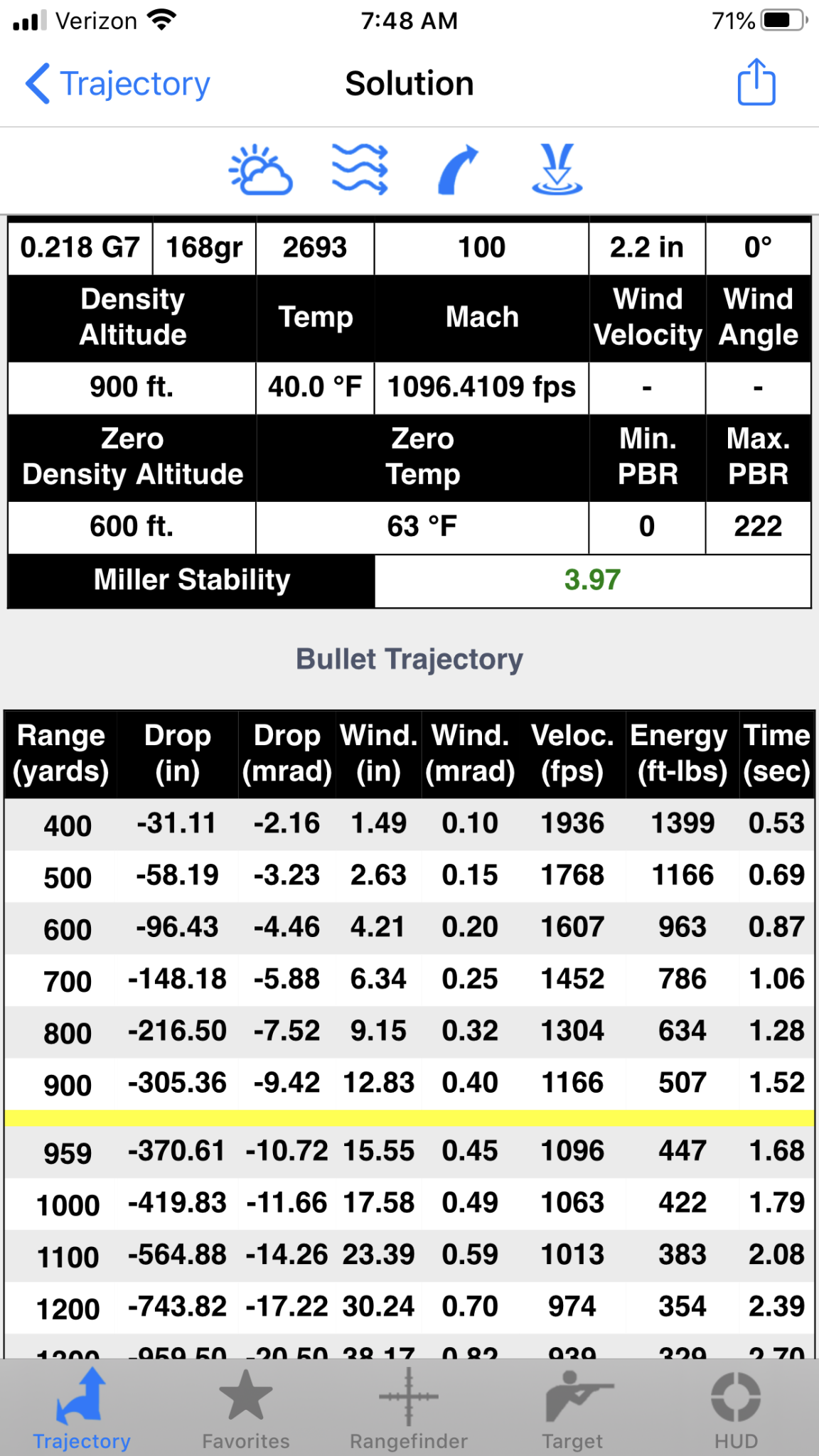

Shooting 168’s two weeks to 1200 ago I found the Litz listed G7 to be a lot more realistic to actuals.

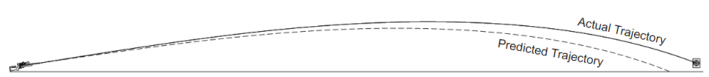

Here are the bullet flights paths that could happen using a bad BC.
G1 BC on very long bullet flight.
Notice the predicted path goes above the actual trajectory and then losses velocity and ends below the actual trajectory. This can make truing our ballistic programs very difficult and pain staking or not possible.
G7 BC on Very Long Bullet Flight
Notice the Predicted Trajectory is much more in tune with the actual Bullet flight. This makes truing our programs mush easier.
Note - If you use a bad G7 BC, you could still get the predicted trajectory of the G1 shown above.
thats because youre using the highest advertised G1 from sierra vs the averaged/calculated G7 from litz
use the velocity banded G1 numbers (or a trued averaged g1) from sierra and the 1200 yd dope is virtually the same

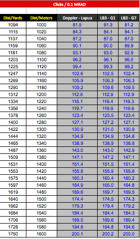

BUT we now have huge improvement in drop chart technology, thank you to Doppler Radar's that give a custom trajectory of a bullet flight over the distance and even at transonic transition and speed. It's why we now have "Custom Drag Curves" that don't need a G1 or G7 ballistic model but can use custom drop based on real test from a Doppler Radar.
It's about the same of a super LabRadar doppler where you can get the speed and drop at different distances and with an algorythm get a custom curves. Witch are even more accurate at long distance.

Nobody here can take advantage of the perceived value of one over the other, which is limited to software used. As noted one can buy excellent ballistic software that you can't even put a G7 value into. When it first started to show up on the market the original ballistic software developers said, Why Bother, it changes nothing the values are, in layman's terms interchangeable.
I can build a track in any program with G1, tune the BC to work, vice versa I can do the same thing with G7, it does not matter in the least. If you match your computer to your actual shots on target, the G value used is irrelevant.
