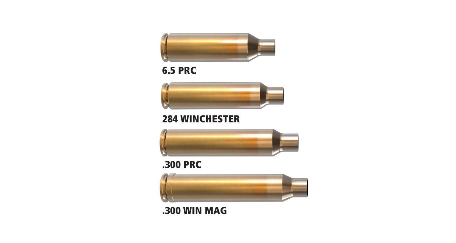

Definitely an extra step to collet the "bulge", but no big deal for me. That said, the PRC round FL sizes without that extra step, so it's admittedly easier to reload.The belt is the disadvantage.
I'm having a 300 prc built for me. Heres what the difference between a 300wm and 300prc is. It only makes a difference from 1500 or so yards and beyond. The prc was built specifically for the hornady 225 and 230gr bullet. The prc can push the fps by 200 compared to the wm. The twist on the prc 1-9 also stabilizes the bullet better than the 1-10 on the wm. The 1-10 doesn't stabilize out to 2000 yds like the 1-9 prc. I'm not here to argue, just educate myself. This info comes directly from my gunsmith that specializes in extended long range. The difference only comes into play way beyond 1000 yds. For every day stuff, go with the wm. If you can shoot 2000 yds. Go with the prc.300wm with a long throat has no disadvantage to the 300PRC. They have basically the same capacity. The 300wm actually has a little more capacity if you have a long throat. Its a bigger case if you move the bullet out of the combustion chamber.

you have that backwards on 300 PRC burning out more barrels faster than the 300 WM..The 300 Win Mag is the barrel burner of these two.Saying an absolutely better case design is a dramatic overreach. When shot from CIP length mags and throated appropriately they match each other in velocity. They feed equally, 300wm has more brass options, from load data I've seen 300wm takes a little less powder to match velocity, until people have burnt through a lot more 300 PRC barrels we can't accurately compare barrel life. So with that said the only real argument for the 300 PRC over the 300wm is the belt. People that load frequently for the 300wm know that the belt is a non-issue. Me and many other people bump the shoulder when sizing the same way you would most other non-belted cartridges. So realistically I'm not seeing any advantages other than hornadys factory ammo offerings which I will admit is nice for those who don't handload.
