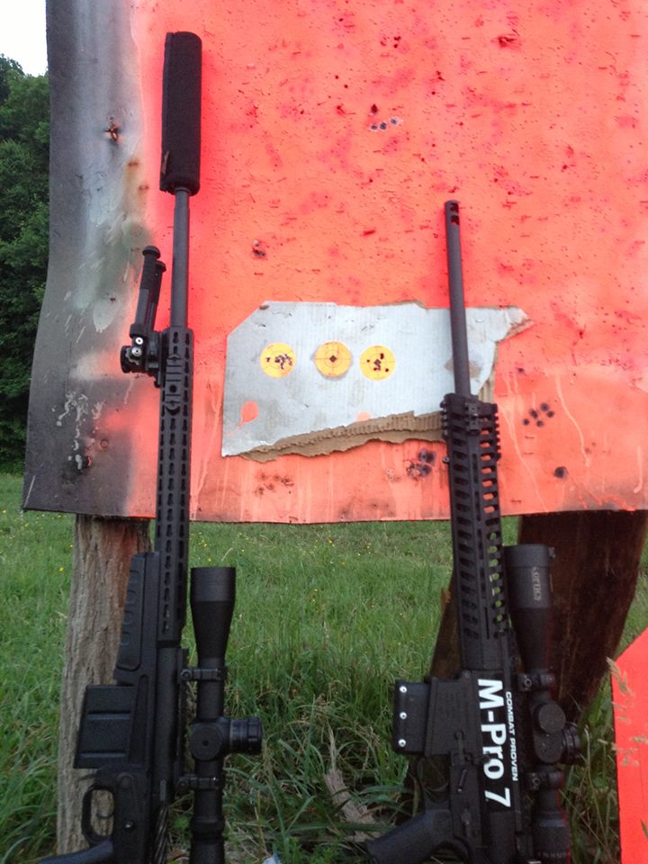

Look... I can pull photo's also... Sorry Jon, lol :p
Or how about this comparison between bolt and semi... Gee... they both seem to be performing the same...
