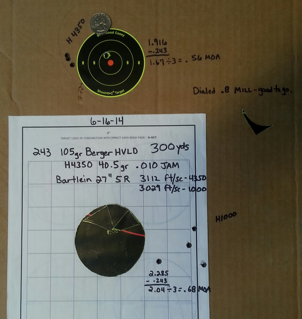

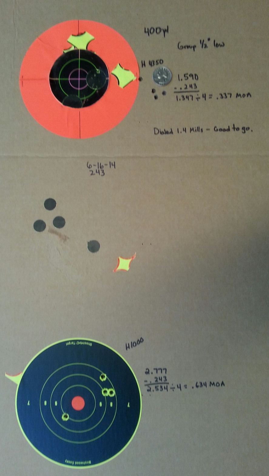

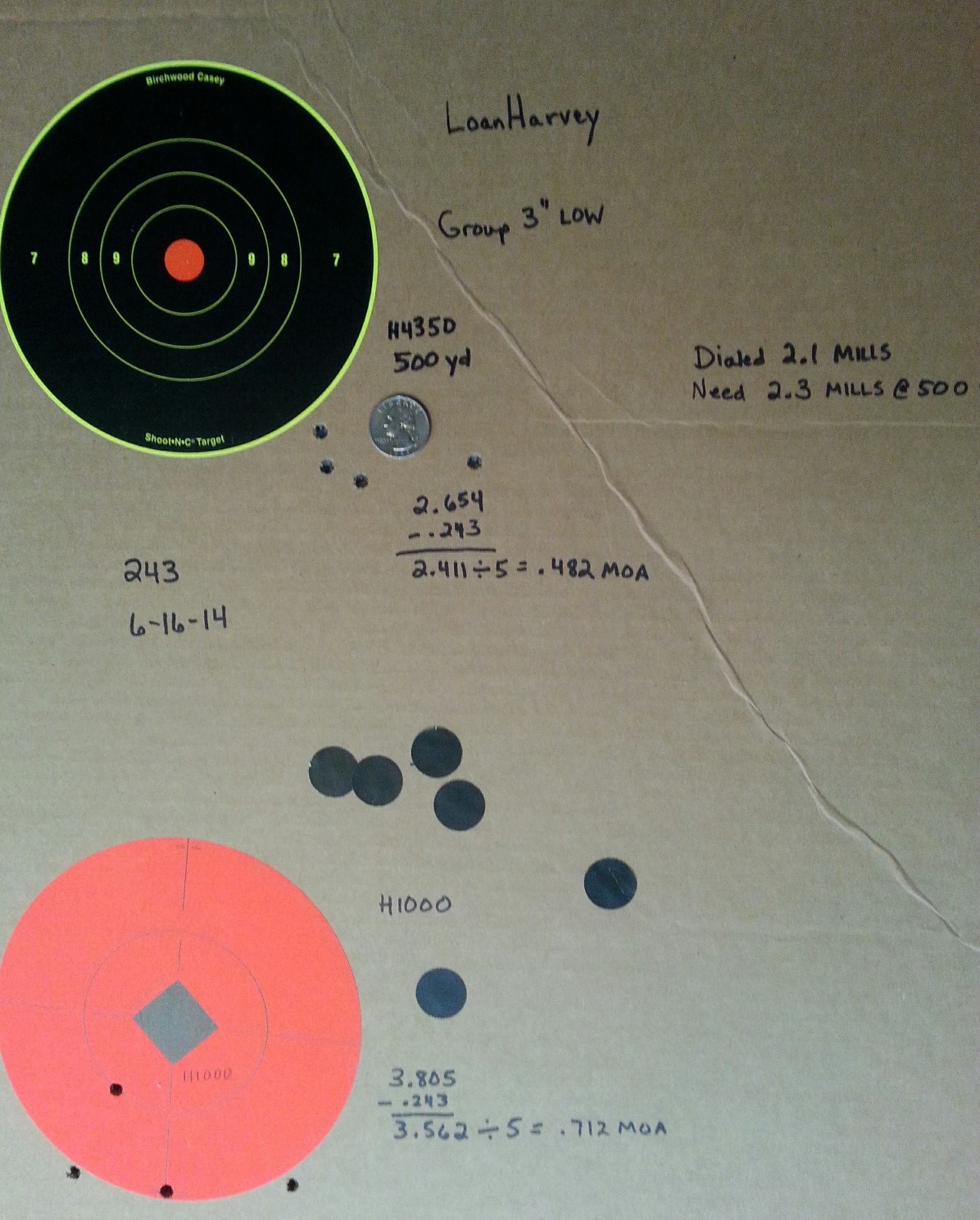

I indicated I would report back and let you all know how that new Bartlein barrel shoots after my smith did the re-barrel for $150, and he bedded it for an additional $50. So, total cost was $200, including the friends 7mm mag that I reported that I JB welded to the original stock. He broke that apart and re-bedded it. I tried the 105gr Hornady BTHP's and was not satisfied. I then bought some of the Berger 105 Hunting VLD's. Here are 4 shot groups at 300, 400 and 500. My goal was to decide between the H4350 and the H1000. The H4350 is averaging 3112 ft/sec and the H1000 is averaging 3033 ft/sc. How about you experts out there, would you say I am good to go on the H4350 load and call it good? Thoughts or comments please...Thank you all very much for all your help.

Have you tried sitting down with this gunsmith and ask him what is done for this price or what all are you asking him to do? If you have concerns you should be able to sit down and talk it over, that would be part of getting to know a guy and starting a working relationship at this shop. It would also let you know if it would be better to keep looking.
