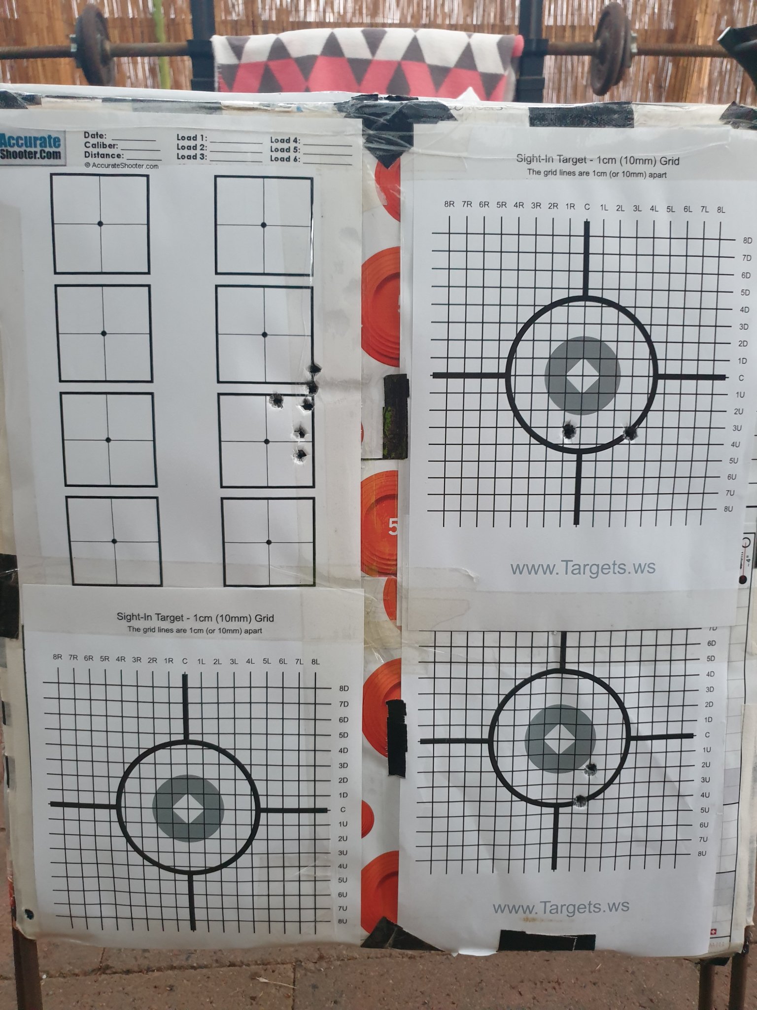

Why is the AI AXMC shooting this bad.
wolfy
Jan 31, 2021
78
40
AUS
The worst is this is at 50 meters.
Any suggestions would be greatly appreciated.
The barrel has been removed and refitted. We got lock down due to covid so not tested after barrel refitted. Will test this weekend.

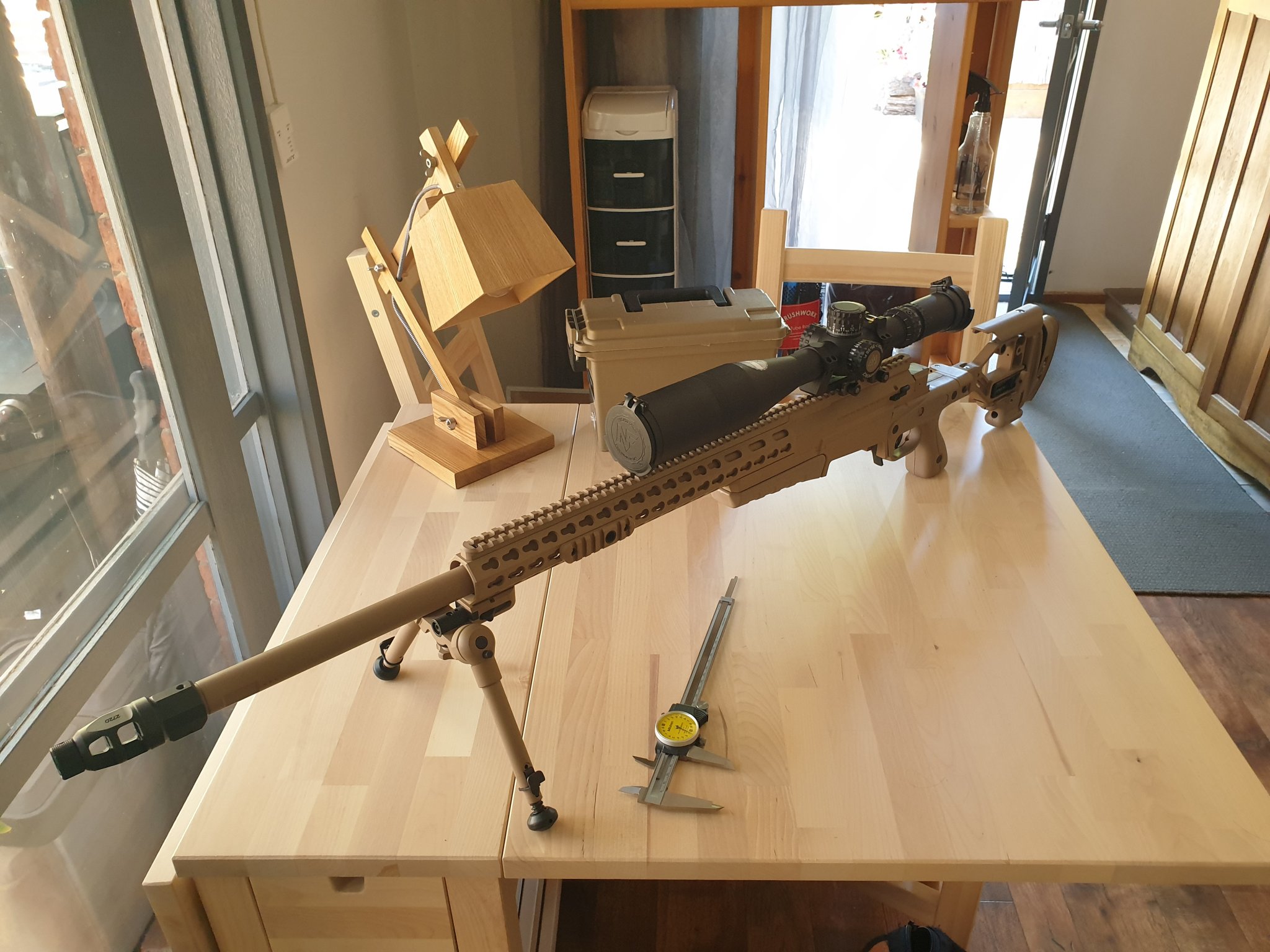

It is an AI axmc 338 lapua magnum.
It has a atacr 7 7-32 ×56.
It is on a nightforce one piece unimount. 4 screw rings so that is 8 all up.
The first shots the scope did move so that got tightened to spec 24inch Lds.
The scope mount on to rifle tightened to 68 inch Lds as spec.
We used hornady match 250 grain, used 300grain fiocchi.
I will be going to a private property hopefully this weekend to test with the gunshop(accuracy international dealer).
The shots that are in the picture are Winchester ballistic tip.
The barrel on the axmc you just tighten by hand and then 49 inch Lds the one screw for the barrel.
So I took the barrel off and cleaned the contacts and refitted.

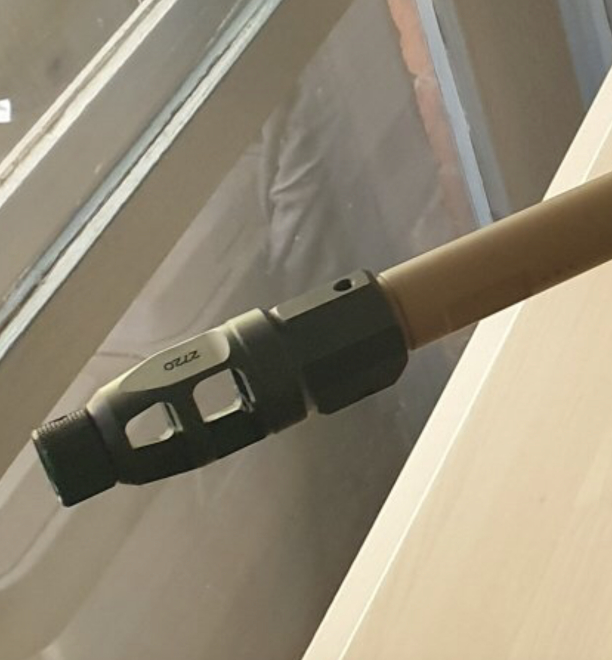

For that rifle to shoot any ammo that bad and assuming the barrel is on correct as is the NF scope and your not shooting offhand the first thing that pops in my mind would be a problem with a muzzle device. Do you have anything on the muzzle and if so remove it and try again.

I have seen the same rifle with factory ammo do hafl moa and 1/4 inch groups at100.
Reactions: 96C
Just for kicks, don't load your bipod next time you shoot and compare it. That shouldn't affect the rifle, but then again, an AI shouldn't shoot that way. The interesting thing is that the rifle isn't shooting generally horrible groups, as in a wide but equal dispersion of rounds radially from the center of the group in all directions, but is obviously vertically stringing, so something is interfering with the rifle system. If it was a bad barrel it would shoot differently than that.
Yep I thought that was my breathing. I do believe I did not load the bipod on those shots. ( no wood to get good load).
The bipod is an AI bipod. So the feet can roll. Thay will not jump like the Harris can.
I think I should get more testing done.
Maybe no bipod and see.?

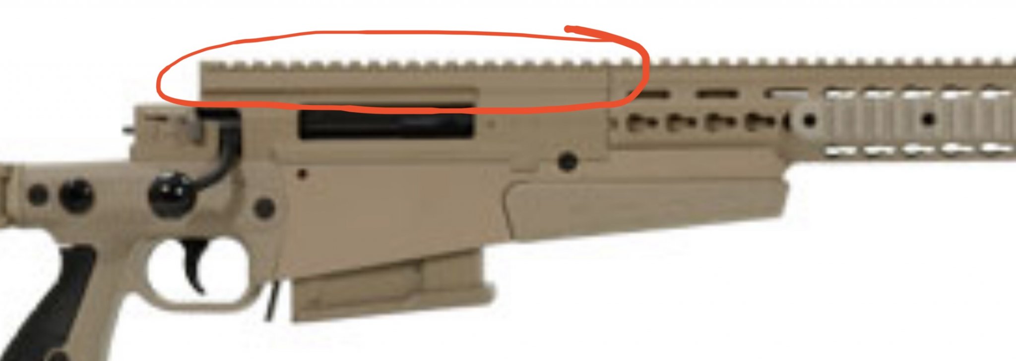

did you remove/reinstall the action rail to ensure it wasn't moving? Also, you mentioned you removed the barrel, when you reinstalled it did you torque the quick change screw down to the right 49 in/lb?

I vote for shooter issue being the problem. I'd interpret the target photos as being essentially 2 MOA groups, which is probably better than typical for a shooter new to precision work on a 338. If my hunch that the OP is new to the game is correct, I'd suggest investing in a 308 bolt, a 6.5 barrel, and a two fundamentals classes about 6 months apart.

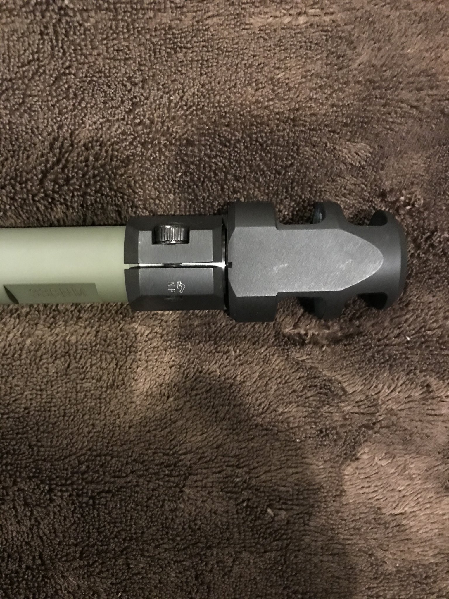

It's a new rifle, so where is the factory muzzle brake? Neither of my factory AXMC 338s came with a brake like that - have they changed them?
Can you see any baffle strikes on the brake?

He's from Australia - that IS a factory muzzle brake. The factory suppressor screws onto the exposed threads at the front of the brake.
While I was away from the computer I figured that must be the case (not in US) because he left clues I didn't pick up on - namely everything noted in metric measurements. Got back on and I checked his profile - duh. We get a much different brake on the ones here. Thanks.
Yes I have the fixit torque special 49 inch pound for this.
The action is a bonded unit. It all looked ok.
But will get that checked. Good point.
Yep the action is bonded, but I meant to check this part to make sure it’s torqued down. It has a built in recoil lug so not likely the issue but something to check.
