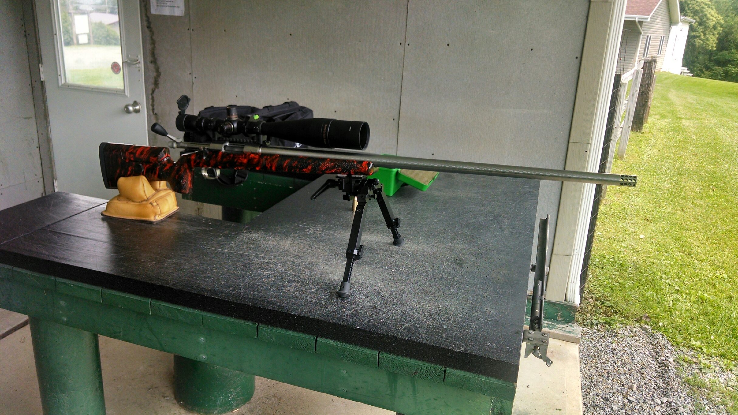

I don't discount that it can be done and keep both, I just tweeked my load yesterday on my 7SAUM it speed up a piece since it's now got 275 rounds down the barrel shooting 168 hunting VLD's 3252fps with a ES of 8fps and it's shooting sub 1/8th MOA @ 100 yards. I am going to take it out long this weekend. It just comes down too two cartridges that do almost the same thing and then the shooters preference I suppose.
Mine does not shoot that accurately at 100 yds but it puts the hurt on a 1 MOA plate at 1500 yds.
I have been double-measuring my loads (jewelers scale) and have seen my ES come down significantly. The vertical at longer ranges has been good thus far.
