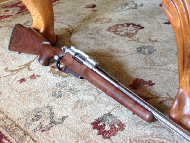

That's when I had mine built (custom build on a Sako M591 action)
