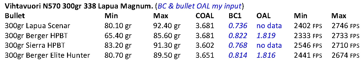

When looking at a powder manufacturer’s published Min/Max loads for the same powder, calibre and weight but different designs of bullets, presumably tested in the same barrel, what parameters produce the considerable variances in recommended Min/Max powder weights?

So, for hand-fed, bumped 0.002" and seated 0.020" off the lands, where do I start with my two 300gr of choice?
300gr Hornady A-Tip BC1 0.863 OAL 1.865
300gr Parker Productions Alu-Tip BC1 0.960 OAL 1.930 (New owners of Rocky Mountain Bullets)
My plan is to use Dan Newberry’s method and assume 92.40gr as the max, back off 7% to 85.93 gr as a cold shot and then 1% increments to first signs of pressure.

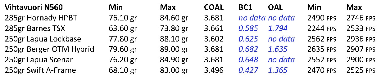

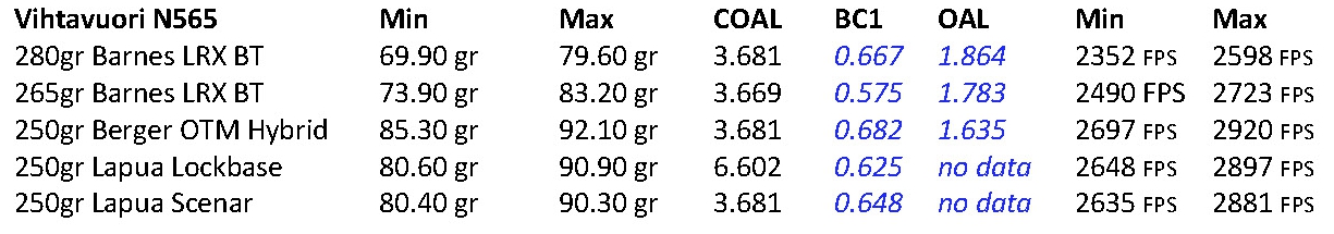

For lower weigh bullets, Vihtavuori recommends N565 or N560 but the only figures available are:
My plan is to start at 77.38gr (83.2 gr -7%) and then 1% increments.
Then for N560
Even less information, so my plan is to start at 75 gr, because you have to start somewhere!
Ogjive profile affects how easily a bullet transitions onto the rifling.
Your plan will prolly blow a primer. You’re using a long secant ogjive bullet .020” off the lands with a load meant for a much shorter tangent ogjive bullet. Not smart.
