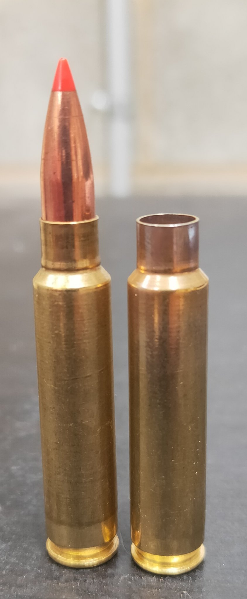

Just got done with a hunt using my new 7sst(sherman short tactical). I got a load worked up in a 22" barrel that's definitely on the hot side, but intent is for 1-3 shots at an animal as opposed to 10-12 shots in match situations. 175gr berger elite hunters going 2970fps, rl26 powder and mag primers. Have had great success with these bullets on elk and now this ram I harvested. I've always had a little affinity for the 7mm stuff, this build has exceeded my expectations in every way.

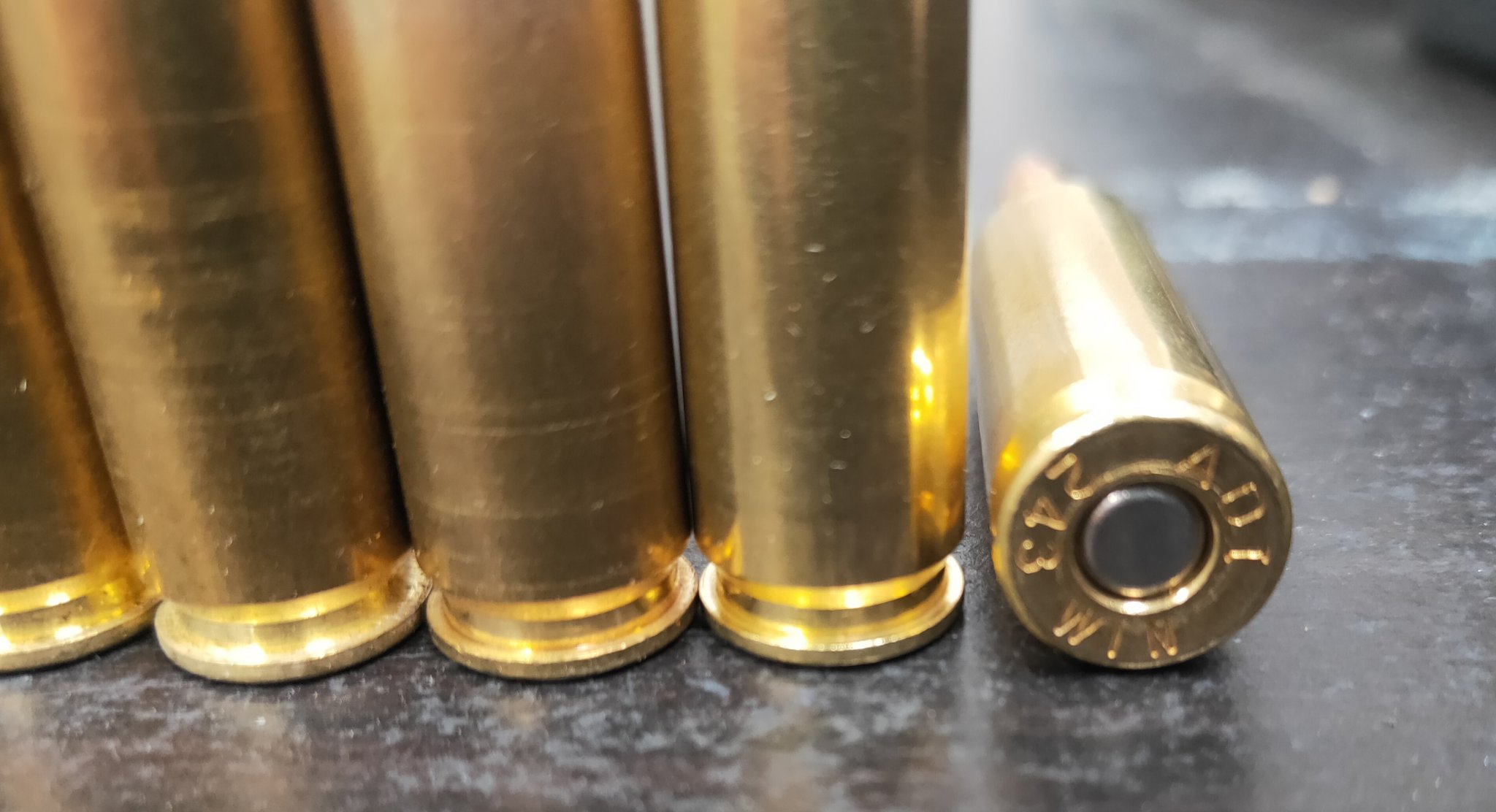

6x47 lapua, formed from 243 ADI large primer brass. Works real well.

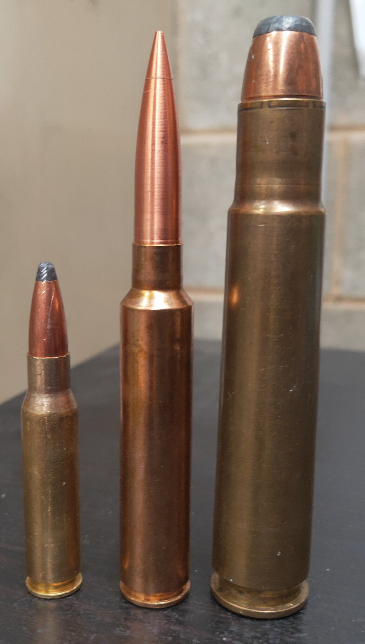

358 Torana. Original prototype was 460wby, belt turned off, and somebody manipulation. I now have custom brass (sort of).
Big sucker is 577 Bunyip. 577-50bmg, AI. Yes, I have a custom reamer for this. 650gr @ 3000fps. It's amazing what customers will order.
Last pic is 308, 358, and Bunyip. Ignore the ring on top of the copper proj. Nothing to see here. Move along.

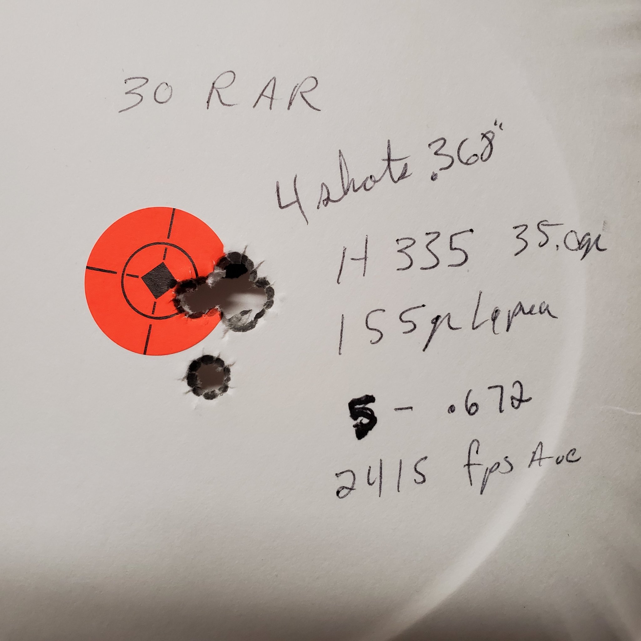

Built a 30 RAR on an AR 15 from used parts, at ad cost of $345.
Started with a used wore out 12 twist 26" police 308 barrel fluted barrel.
Cut to length of 20" and Profiled it to fit the AR 15. Threaded it for barrel extension, chamber, muzzle threaded, gas port journal machined...added gas port later.
Assembled it and shot it, now I have a 30 RAR shoots 150 gr bullets at 2500 fps or 155 gr match at 2415 fps very accurate. out of an AR 15.
