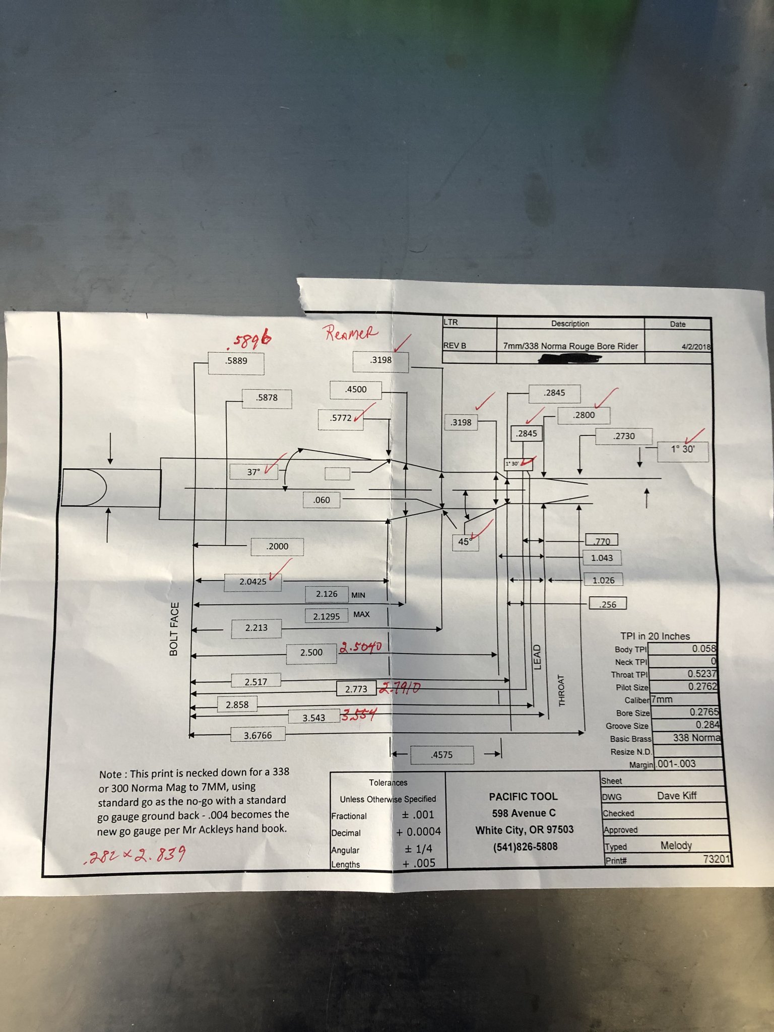

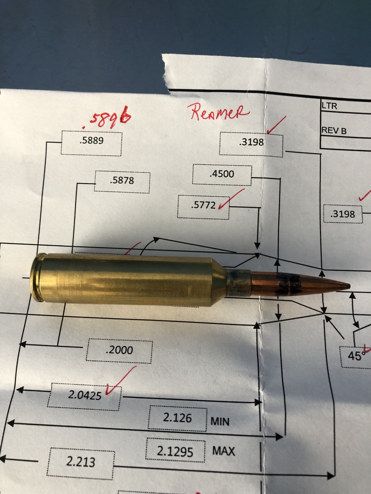

    Started off contemplating what case to start with and ended up thinking a 7/300 Norma improved should give good brass and push the 195 EOL’s well over 3100. Began collecting parts...... Defiance Deviant, Proof, Terminator T3, Manners T5A Carbon. Had luck with the last PTG reamer so went back to the well and Dave sent me the 7/300 Norma Rogue.

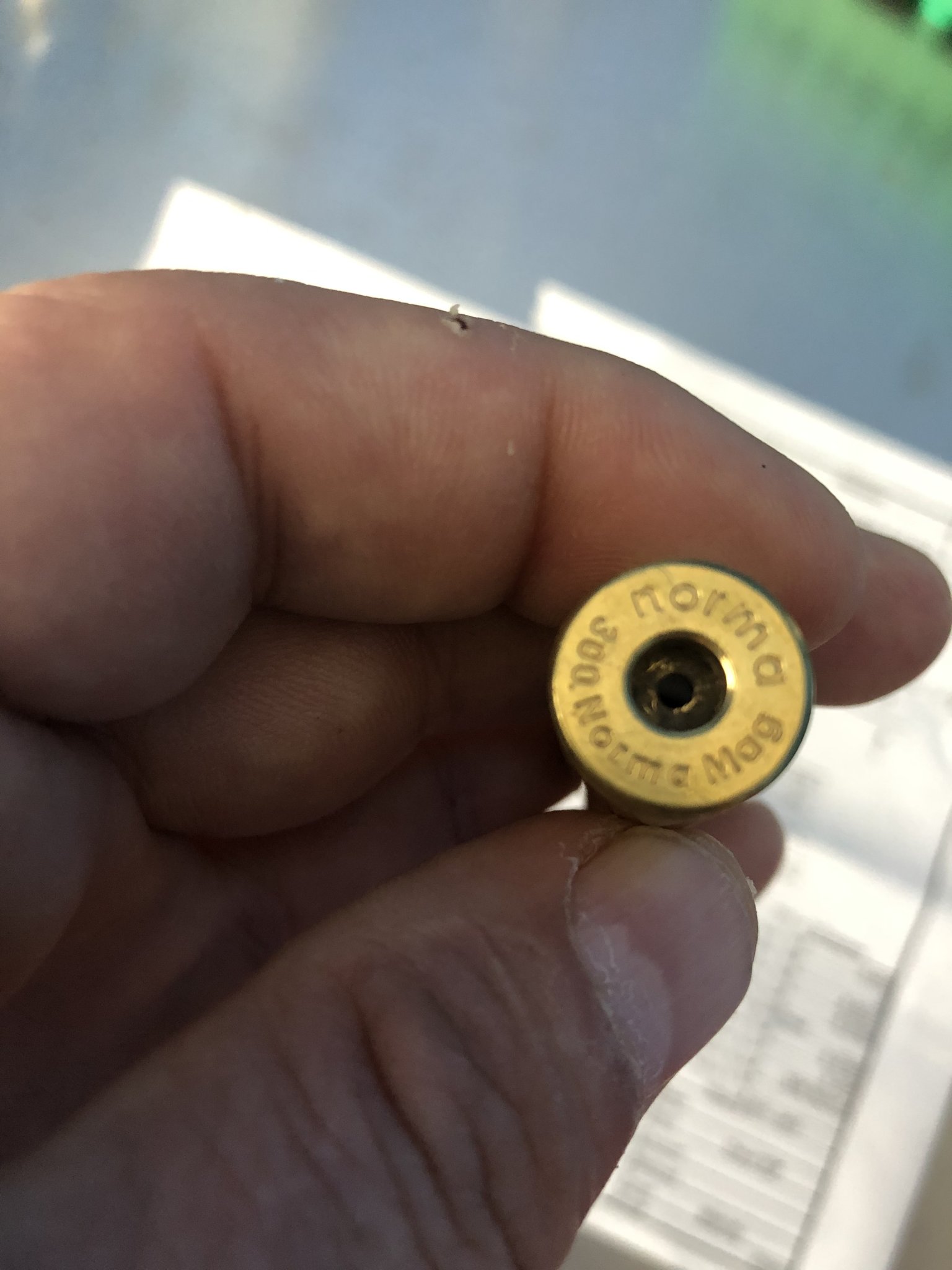

    1- ejector marks- does not matter if it’s Peterson or Norma brass...... 70g To 90g of various powders 7828 SSC, H1000, Retumbo, RL33, US869, Or N570. See 1st pic
    2-lack of speed- again running above powders on .5g increments with 195g EOL’s. Looks like it’ll shoot well, but speeds are less then expected.
    Had a second rifle with exact components chambered and it as well shows the Sammie issues.... ejector marks and slow speeds.

    The 300 norma Peterson brass was .0175-.018" thick at the neck. It requires neck turning for that chamber because the neck can't expand. Measure fired brass to confirm or try to push a bullet into a fired case. I ran into this with mine. Norma brass was .015 so it should have been fine, not sure unless you're chamber is a little long. You could try necking up and creating a false shoulder to see if that helps.
    Reactions: bjay
    You didn’t tell us what your loaded neck diameter is. Can you slide a bullet into a fired case?
    Going off the reamer print and neck thickness of the Peterson brass I loaded, he could have reloaded without running it through the sizing die. I had to turn my brass because of this.
