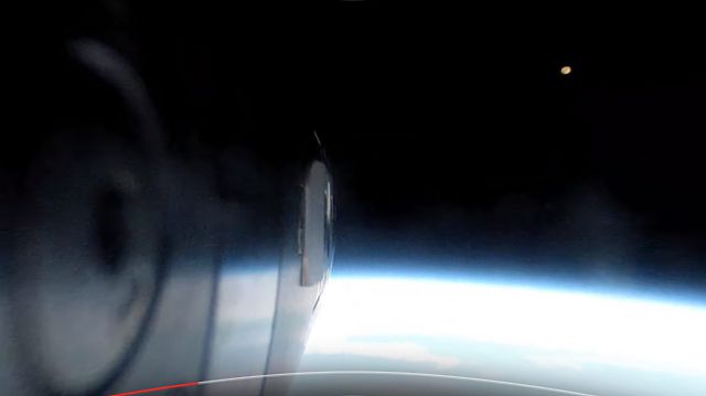

His attempt to be a non NASA person to photograph the earth from space has already been done. Sorry flat earthrs, your bullshit has long been busted. https://www.ddeville.com/derek/CSXT.htm
Here’s just a photo of the video shot by the CSXT rocket.

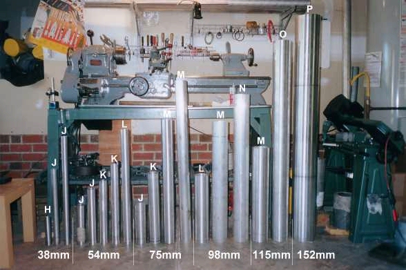

Here’s some of the larger commercial rocket engines I got to mess with. Fun stuff, but expensive!! I used the exact same composite solid rocket propellant that the space shuttle uses. APCP or ammonium perchlorate composite propellant. http://www.pro38.com/products/pro98/motor.php
My personal rockets were in the 54mm diameter motor size and under. Much cheaper to fly on a regular basis. I averaged 10k agl or less at my club launches. Could go 20k, but our FFA altitude waiver lint was 12k.
Depending on organizations rules, most class 1 and 2 airframes have to be mostly non metallic. FAA and mil start asking lots of questions once you start launching metallic rocket airframes at Mach 2. So lots of composite structures, nomex honey comb, carbon fiber, phenolic resins, g10. All double redundancy full electronic telemetry control with live radio frequency tracking.

Oh yes, FAA clearance is required. Even on one of my small 54mm dia rockets made with filament wound fiberglass going Mach 1.4 would go in one side of a Cessna and out the other. It’s common to use a ham license transmitter to track and recover. It’s very easy actually. The ham frequency is used to broadcast a gps signal. Then you can walk right to it.
When I left the club, they were working on a P impulse motor. 152mm diameter by 6 ft long. Rocket motors are classified by letter code. Hobby store Estes, A, B, C, D, E. Each letter code higher is twice as powerful. A P impulse engine is 80,000 Newton’s of thrust, or 18,000 ft lbs. For perspective, a hobby store Estes E is 4.5 Newton’s. Just the fuel load for that thing was $6000.00 not counting the cost of the rocket. Literally lighting 6k on fire!!
