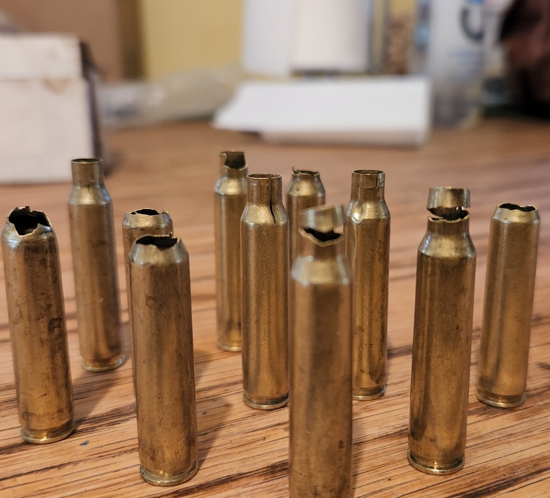

But when I started resizing about 30 cases with my RCBS FL .223 small base die about 50% started to tear apart.
The remaining 25% were already trimmed(?) to short to be usable, and the last 25% made it through.
What would cause this shit quality? And how likely is it to blow up if I load and shoot the brass that made it through resizing? The shells are mostly LC military stamped, and I'm super green to reloading.

It's brittle from work hardening. It needs to be annealed. I would most definitely not shoot that brass until it had been annealed. You're likely to have a case head separation if you do (case breaks off in the chamber). Even annealed, I'd be very leery of that stuff.
Looks like brass fired out of an M-249 SAW, that was way out of timed (cases were probably severely bloated before initial resizing), and was sized back down without annealing it.
You don't think it might be a problem with the brass being worn out? A lot of the brass was trimmed well below the maximum trim length.
The 5.56 that I know have only been fired once have never given me this issue when resizing.
There are ways to resurrect it with heat but personally I only reload to about 5 times, so to me it’s just diminishing returns. I’m just not going to risk a gun I really like, but that’s just me. Considering what you’ve described that brass has probably been worked past what I would consider a viable case.
I honestly have no idea (nor do you I would suspect) if the brass is "worn out". Brass typically fails first when the primer pockets loosen up. If they were aggressively resized (excessively bumping the shoulder back), then yes, the brass itself will fail, but typically just above the rim of the case (not that that isn't just as bad a thing).
Trim length is subjective to some extent. It's more important that it isn't too long, rather than too short. Though at some point you can trim a neck so short that it affects the concentricity of the bullet as it's seated. But a couple thousandths short isn't the end of the world.
The 5.56/.223 you've had in the past was likely shot out an AR or M-16, which unless was grossly over gassed, wouldn't cause cases to bloat or stretch that severely.
Like I said, I think you got brass fired from a belt fed, open bolt gun, which can play hell on cases, especially if the gun was run hot or the timing was off, and cases were being extracted before pressures dropped (which happens often in belt fed guns). Extraction before pressures drop, causes the case to swell excessively, since the chamber wall is no longer supporting the case. Then when you go to resize the case, you end up really work hardening the brass, which then causes the case to get brittle, and tear or crack.

Thank you for expanding on your original post, these sketch me out to much, I won't be firing them.
So with other 5.56 brass I have (that I know for sure has only been fired once) I should anneal them before resizing them in a FL die?
The fact that you are sketched out by that picture is probably a good sign, you might have a future as a reloader. Throw it in the trash and call it a learning experience.
