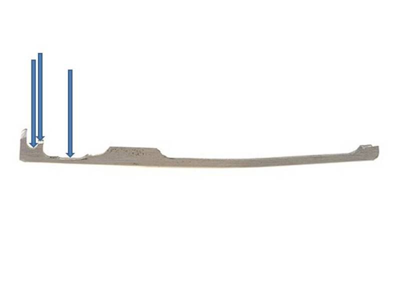

I have a older model 70 Varmint in 308 and the extractor broke in half. I ordered 3 new pushfeeds and none of them extract the shell. So I called and Winchester said "that's all we have left". Someone has cut and polished them before I received them in the mail. My question is there any modifications I can make that would allow more grab.Or is there a aftermarket replacement out there that I can install.

Thank You! for the info on the claw type extractor. But , I have the small plate type that is held by a plunger and spring. I could not get a good pic last night I will try to post one later today. And I called Winchester back I guess they found another type that was sitting right next to the one I received , and they are sending those out today.
