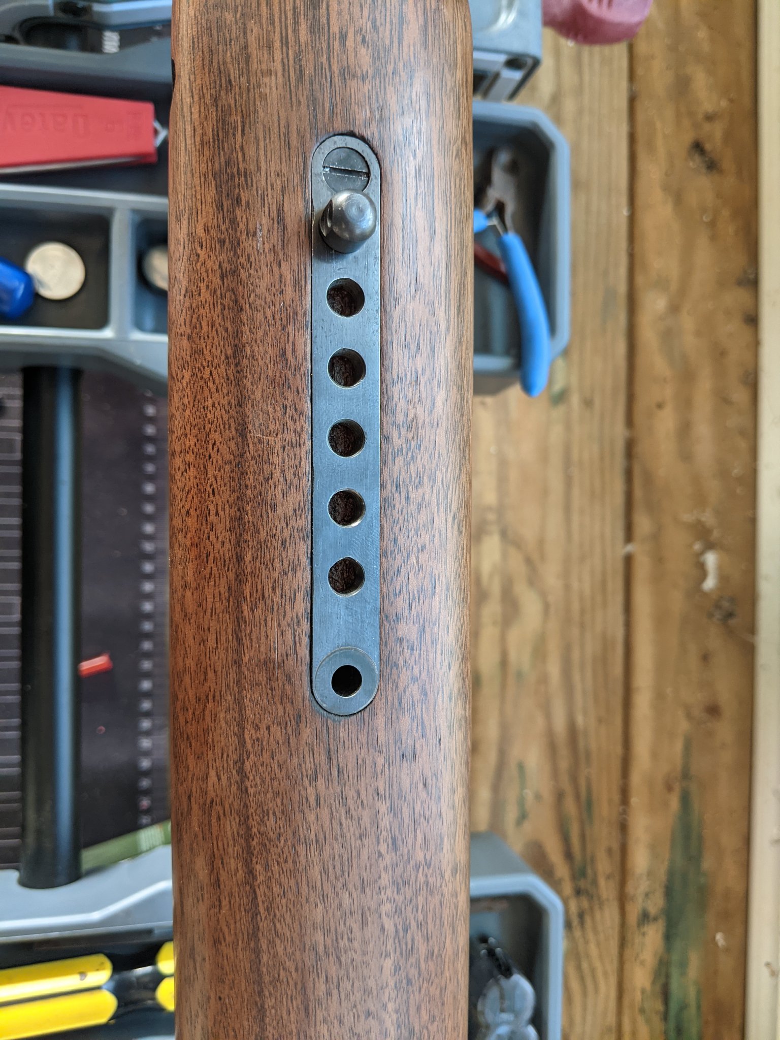

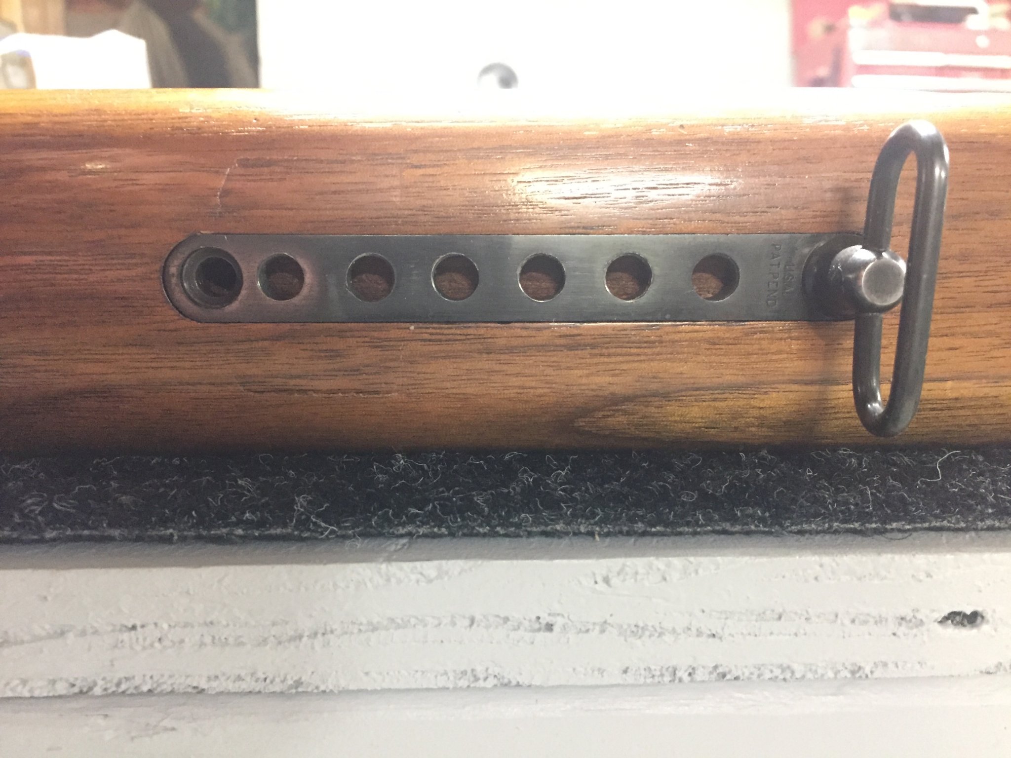

Got another question for those with a 52b or 52 c. My 52b with bull barrel and target stock has what numrich calls the forearm adjustment base. I think there is screw missing on the rear. Anyone have one and can provide a picture of what that looks like?

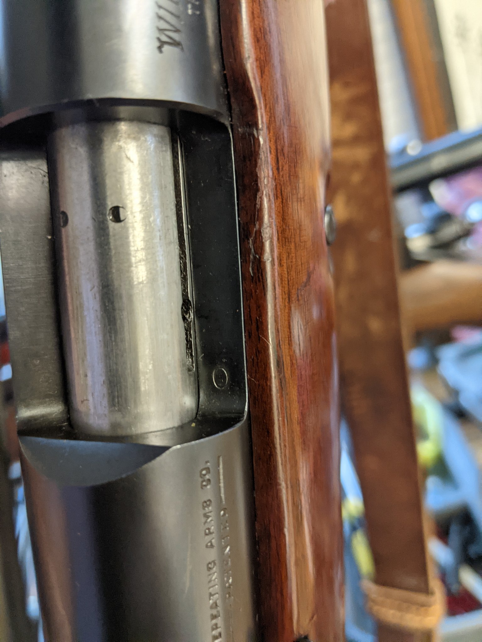

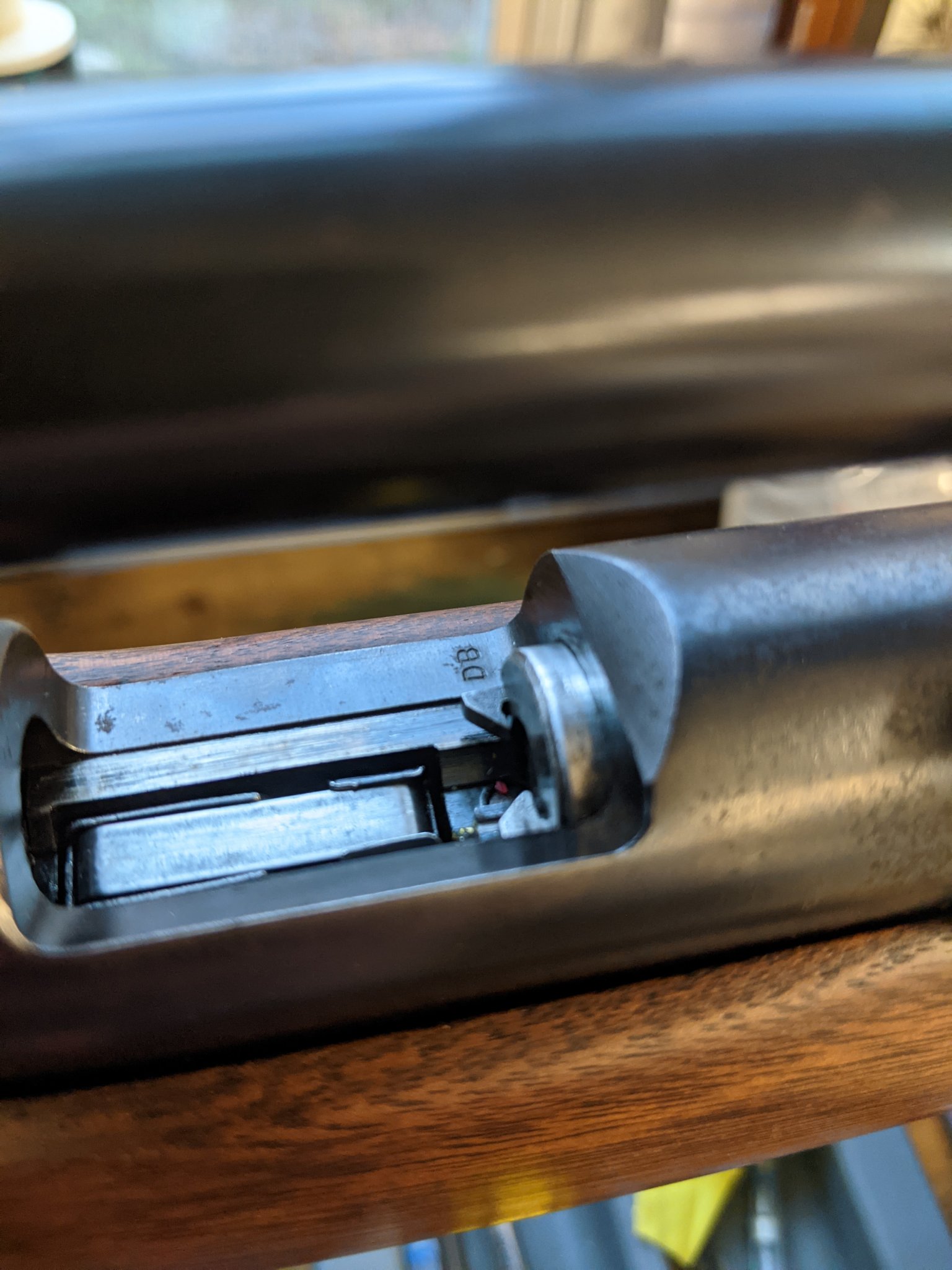

52b manufactured in 1949 but looks different to me.
i posted those pics on rimfirecentral. apparently its an inspection stamp. one guy said he has logged at least a dozen different ones during their production span. mystery solved

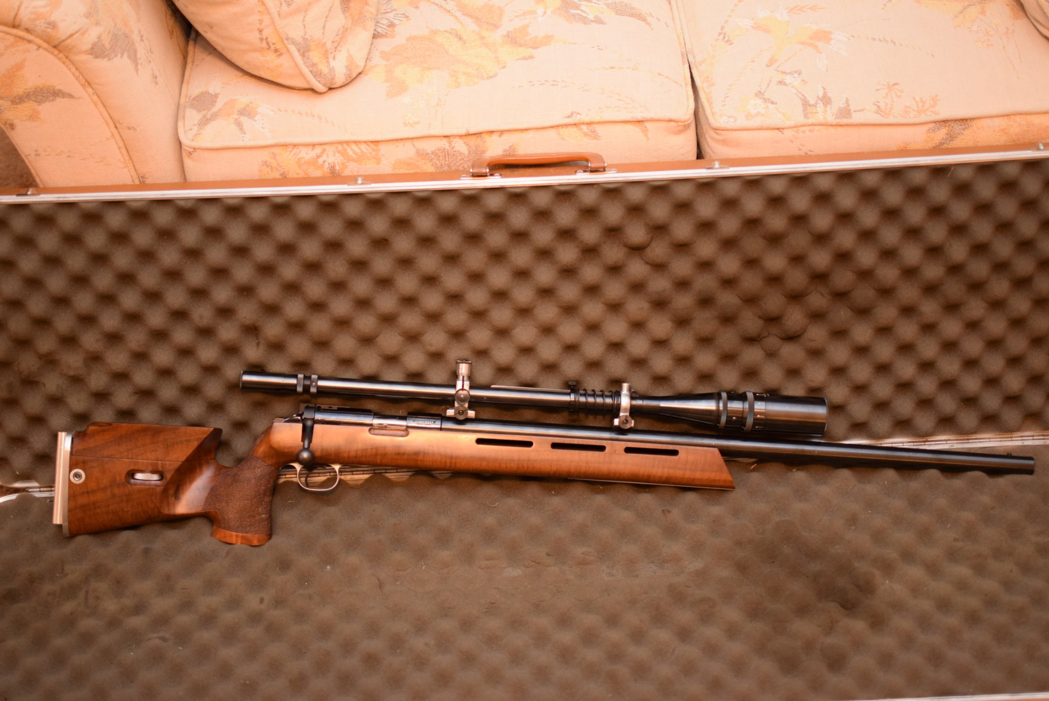

A friend told me about a M52D for sale that was in a Doan Trevor prone stock. When I called Doan to ask about this stock, he told me he'd patterned it on the Robertson H&H prone stock, which I have on several of my CF LR HP rifles. Wound up buying it, and was pleased to discover that the trigger was either modified by Karl Kenyon, or done by someone else who knew what he was doing. The stock is a nice piece of claro - not too fancy, but still pretty to look at. Only downside as far as I'm concerned is that the buttstock was cut pretty short - perhaps for a junior or petite female shooter. I had a new unused Tubb 3-way buttplate assembly that I'd bought for another project that never got off the ground, so slapped it on to allow me to do some shooting off the bench - doesn't look right because of how small the butt of the shortened stock is, but one of these days, I'll get around to making it fit better. Also robbed a Ken Vianni scope base off my CMP M52D target rifle and mounted a Sightron SIII 45x45 scope on it. My 50yd groups with a good lot of lapua center-x had a lot of vertical, but several left-over lot samples of Eley Match EPS from three years ago all shot better than the best I was able to get with center-x. The bore isn't very pretty when viewed through a borescope, but I'll try to find some more Eley EPS & Tenex to test in it before getting serious about re-barreling this fine old action.

Not long after I posted the photo of the used CMP 52D in the Doan Trevor stock, a good shooting friend found a Unertl 16x scope in very nice condition for it, so I put the Viani scope base back on the CMP 52D I'd had it on, and got the Unertl set up on the Trevor-stocked rifle. It looks much more period correct, and what little time I've spent shooting the rifle with the Unertl has been very enjoyable. I did more shooting with Eley Match (black box), and found a lot that shoots really well in this rifle's old original bbl. I'd ordered in a Krieger SS blank that matches the dimensions of the factory bbl, and after finding that the OEM bbl didn't shoot any of the SK or Lapua that I tried in it very well, was going to use the Krieger on this 52D. But it shoots the Eley Match so good that I've put off doing the Krieger for now. Wanted to post a photo of the rifle with the Unertl, but then remembered that I don't have any photos of it on this laptop. Will have to bring up this post on the desktop, then edit it to add a photo on that computor.

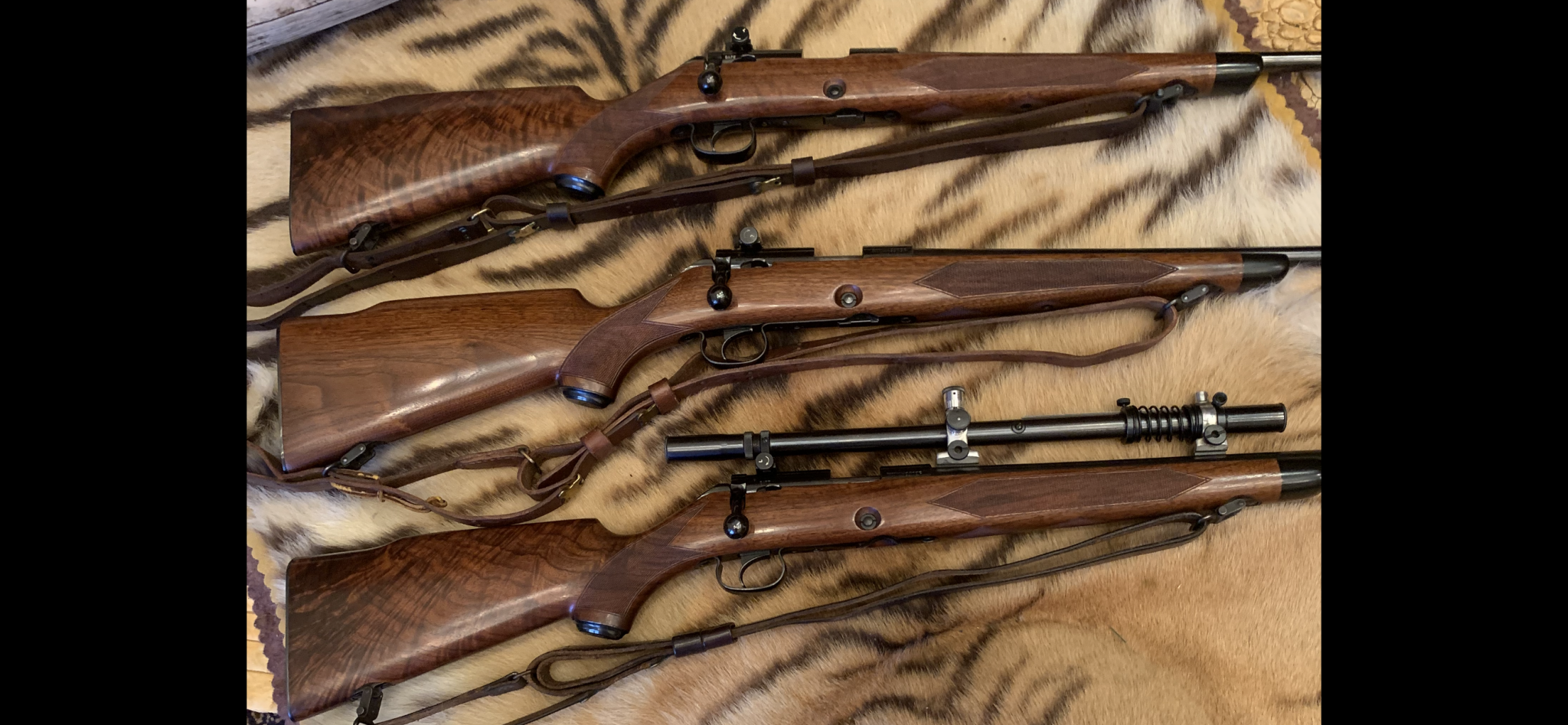

Wow, some pretty stocks on those. Most of the 52's I have seen over the years had nothing near that grade of walnut or finish. Those are beautiful.
Those are all sporters, and from what i have seen, their wood was always high grade compared to the target models. would love to have one from the 40s. I would LOVE to trade one of my 52B targets with Lyman or Unertl towards one.
*cough* *cough* @RTH1800
Reactions: Calfed and RTH1800
The rifles that RTH1800 posted are exceptional sporting 52s - most of the other ones I've seen had pretty plain wood. The only other original Win 52 sporting rifle I've seen with nicer than typical wood is one a good friend of mine recently bid on & won on a Rock Island auction - and it supposedly belonged to Robert Peterson, of Peterson Publishing. It was a 52C made in 1956, and I would guess that it was ordered with the optional 'selected walnut' stock, which the 1956 Stoeger "Shooter's Bible" shows cost a whopping $16 more than the $145.70 rifle w/o sights listed for.
