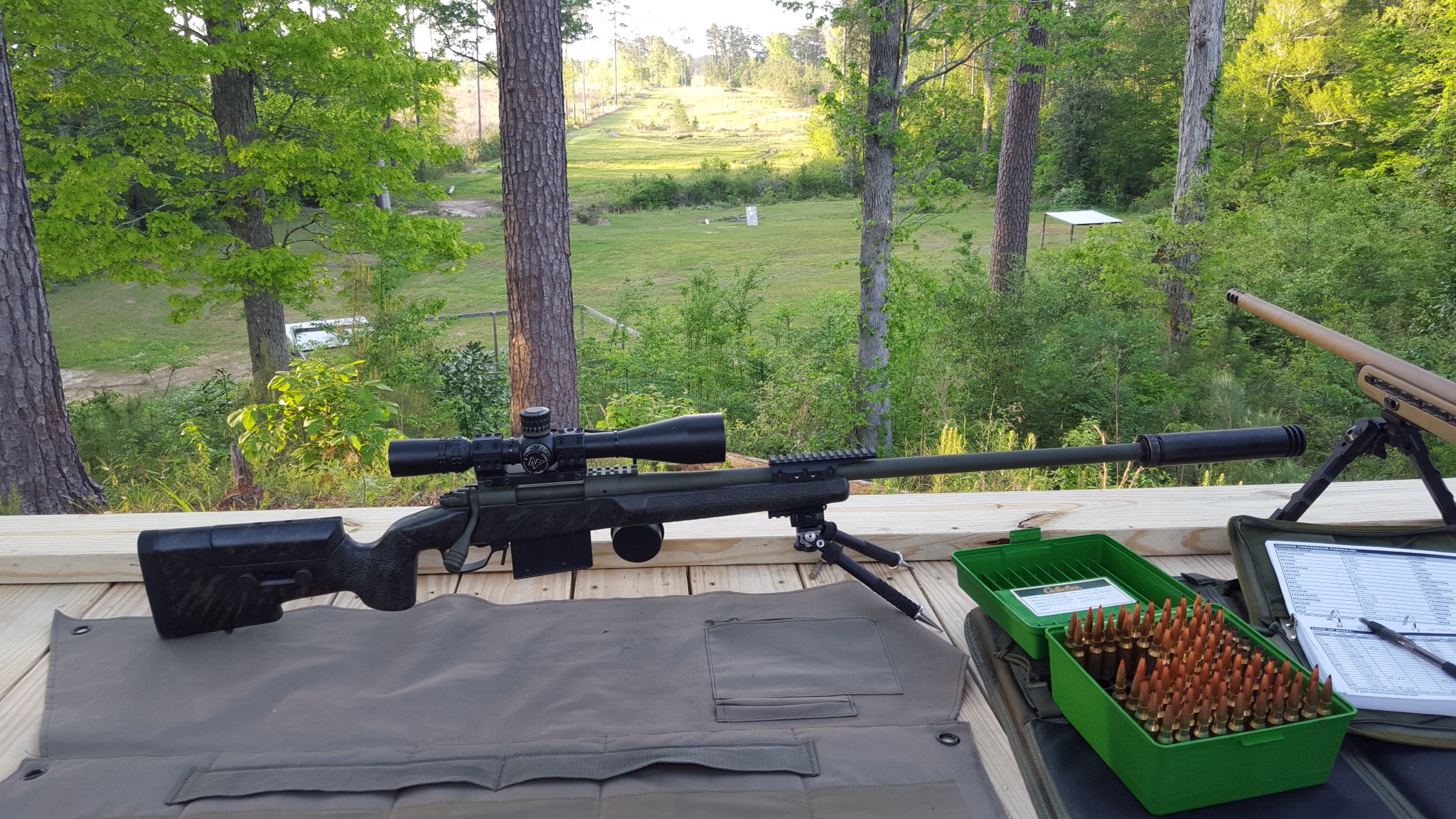

I have a post 64 M70 that I had Phoenix Custom Rifles build. Had them chamber in 300wm cause match grade ammo was easier for me to find. I dont reload so the 300wm was a better choice for me.
I have a post 64 M70 that I had Phoenix Custom Rifles build. Had them chamber in 300wm cause match grade ammo was easier for me to find. I dont reload so the 300wm was a better choice for me.View attachment 7066105
I have given some thought to going .300WM. I have also heard that you can’t open up the bolt face to make it work. Yea your rifle there is exactly what I’m looking to do. Nice build man. Did you have any issues going to .300WM or was it already a 300?

It was a 7mag. I couldnt find match grade ammo for it, so I re barreled into the 300wm.
So that wasn’t a bad conversion then. I will probably just stay with 30/06. It is a very capable round. I don’t reload but I believe there are several different match grade 06 ammo on the market. I appreciate all of the advice guys. I can’t wait to get this project started now. Now to break this news to the wife Hahahaha
