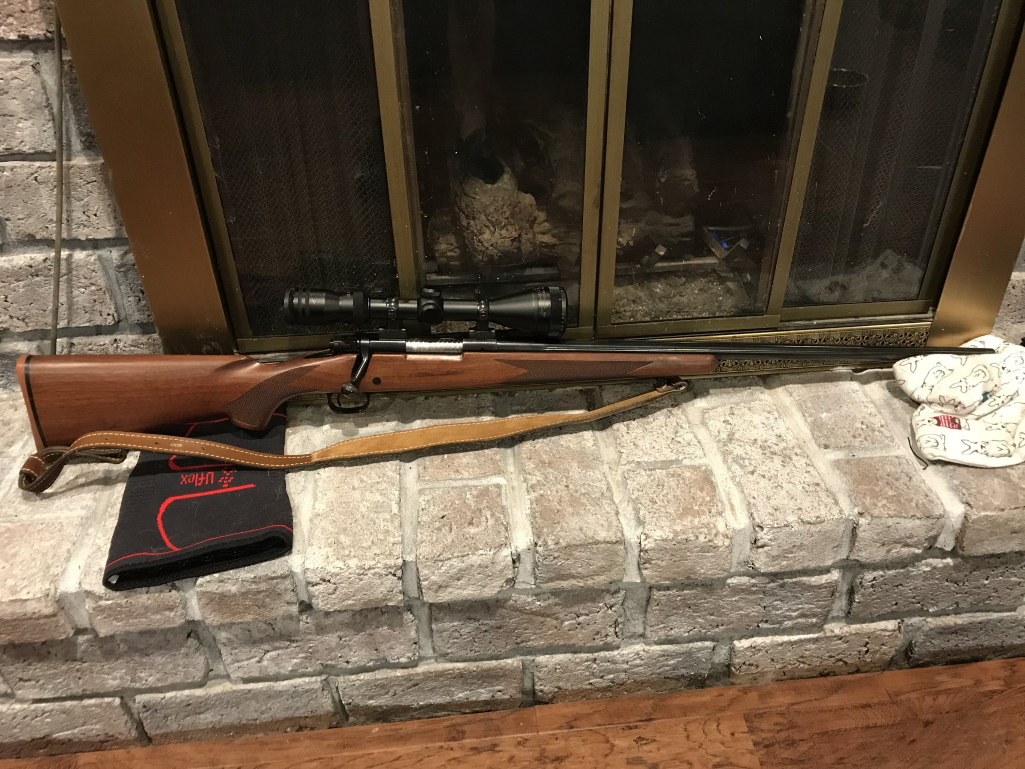

I recently got an amazing group out of an older post ‘64 Winchester Model 70 22-250 that I’ve had for years (killed a lot of shit with it, never grouped it until now) and I’m in love. How hard is it to rebarrel these? Who works on them? Do they need much work?
