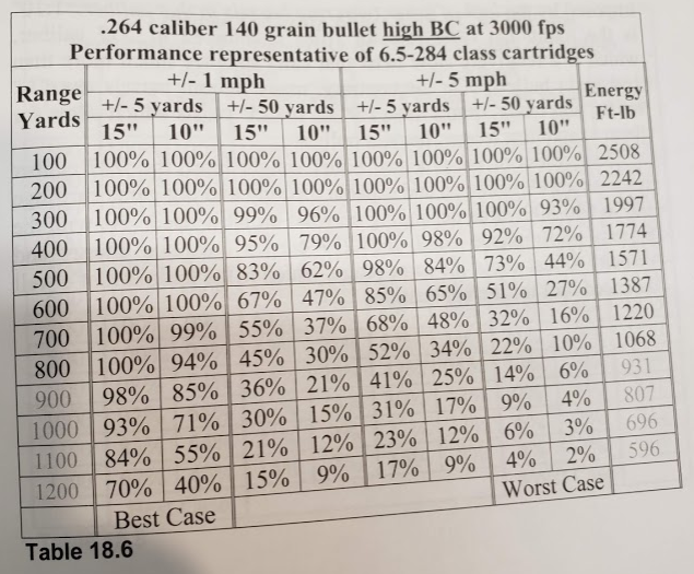

Brian Litz of Applied ballistics has developed a 6 degrees of freedom ballistic soft where that also allows the input of other variable. Shooter/rifle ability, Target size, Confidence in target distance and confidence in wind calling are a few. Here is a photo of the chart provided for the 6.5creedmoor.
Note the targets sizes. (larger for shooting inside 500yds) but at
Example;
-800 yards
-10" plate,
-knowing you are within +- 5 yards of the target distance
you could have 94% hits if you can call the wind to within 1mph but only 34% hits if you can call the wind within 5mph.
