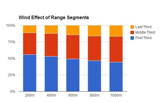

Target at 1,000, scope at 999 = only the last yard worth of wind, and the LEAST useful yard at that.
Target at 1,000, scope at 600-800 yards = judging the influence of the wind at the most influential end of the range.
If a guy is shooting from 10, and could only make a wind call on ONE yardline's conditions, he'd make it on the 900 yardline...not the 200.
Wind at the Shooter is the most important wind
Wind at the Target has the Least Influence
