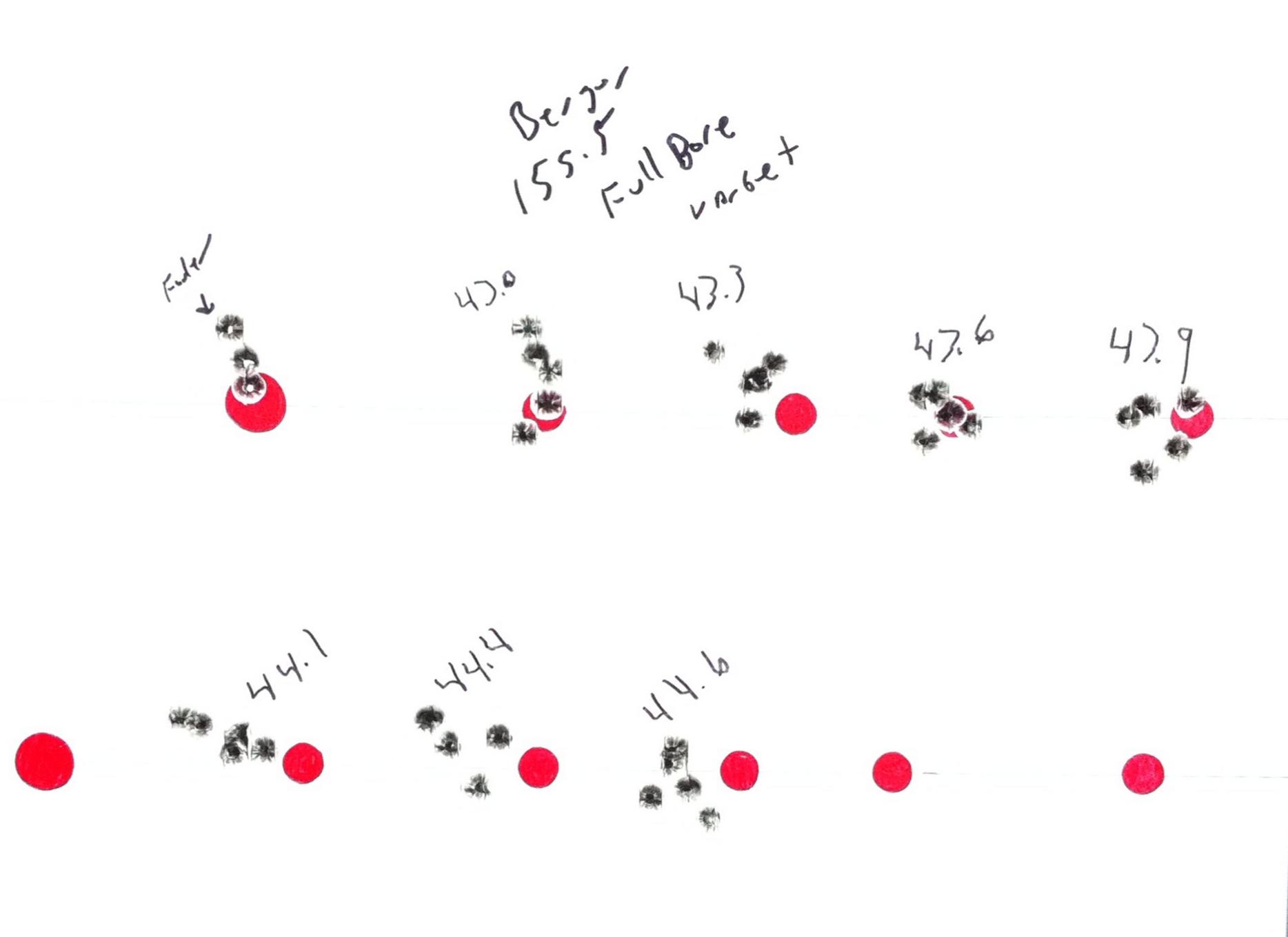

Still trying to get my fclass load right, used the 47.1 load this wknd and got a 197,199, ,194,196. Not happy with it at all but it worked. Switched from 155 Lapua's to Berger 155.5 full bores. Like the Lapua's just not with the Bisley reamer. I never really trust the chrono numbers but do the spread. Was using a new CED M2 today. Red dots are 5/16 in size. Waiting on my magneto speed. Here are the numbers. The other 47.1 load really opened up at 600. I'll try to post some pics of it.
43.0
2777
2762
2768
2769
2799
13/37
43.3
2807
2780
2837
2818
2794
57
43.6
2832
2806
2792
2816
2823
13.5/40
43.9
2832
2806
2792
2816
2823
31/95
44.1
2877
2850
2871
2831
2849
16.6/41
44.4
2864
2850
2857
2851
2867
6/17
44.6
2886
2868
2851
2883
2867
12.4/35
As a side note, I stopped using paper target for load work up, and went to corrugated plastic. Works great leaves little holes smaller then the round, You can really tell where the round is hitting Vs the paper tearing.
