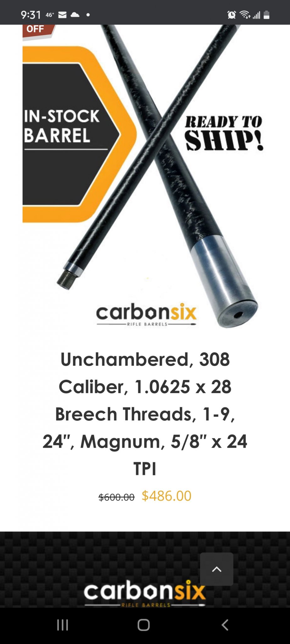

I'm trying to find a carbon fiber barrel for my savage standard shank found this on carbon6 website would this need work or would it screw right in. Sorry I am very new to the whole replacement barrel thing.

What the particular barrel you show can’t screw into anything. It’s an unchambered blank and has no threads to go into the action.
Find a savage prefit. Then you can screw it into the action until it stops on a go gauge and use the barrel nut to lock it in place.
Gotcha so that determines the prefit/ barrel blank then correct? Prefit is ready to go
