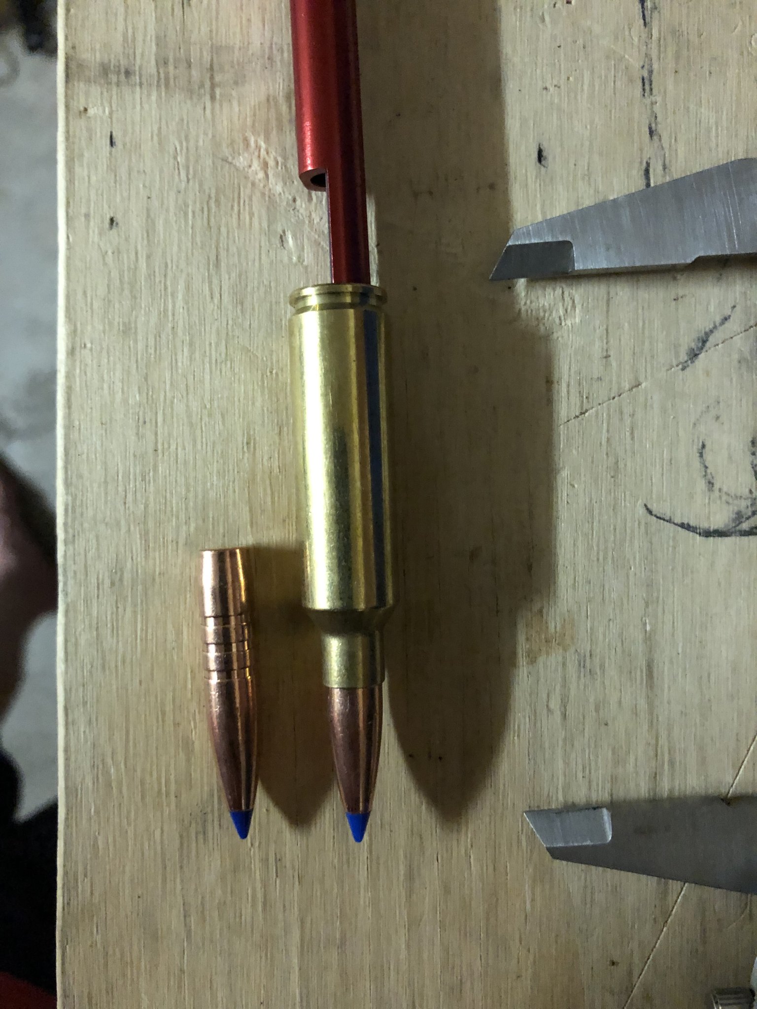

Pictured below is my 300 WSM modified case and 200gr Barnes Tac LR bullets. With the base of the bullet seated right at the ideal neck/shoulder junction the OAL is 3.45” which is well into long action territory, with the bullet touching the lands in my stainless factory Salvage barrel the OAL is 2.96” which will mag feed from my Accurate Mags with the front plate drilled out. If I were looking to get max velocity I would go with a long action and if I go with a long action there are better cases to push the 200gr bullet to max velocity. I went the WSM route because I already had a large shank action and picked up a barrel for silly cheap, it is more than adequate for my intended purposes (elk) but there are better ways to push large/heavy 30 grain pills along if you are chasing MV.
YMMV
YMMV
