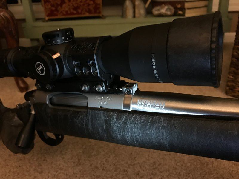

I think it is perfect match to TL3
While it is easier for it to work with a pinned lug action, it can be used on the TL3 as well as Defiance Deviant actions, both of which have integral lugs. IDK about Mausingfield, I didn't ask about those, but I don't see why not. You may want to ask them to confirm.
