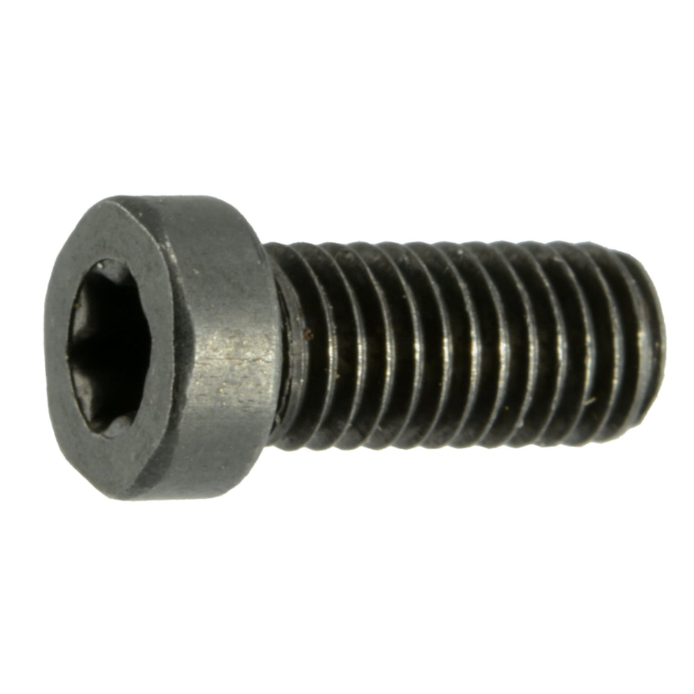

I got superrrrrrr lucky to put my hands on an xm2010 chassis and ony 9 screws came with it. 6 with 7/64 hex for the top rail and other 3 with 1/8 hex (weird). I do believe they are the same length but I am not pretty sure what exact spec they are and where I can find extra. It kinda bothers me because I dont have enough extra 4 8/40 for m24 receivers so I am looking for getting extra ones (better to be m2010 original). Also please let me know their torque specs!
If anyone cares the 7/64 screws have 'IHUAI 12.9' on top
Please help make my dream come true!!! Thanks a lot!!!
The rail screws and accessory rail screws are: Flat Head Cap Screws 10-32 x 3/8" that use a 1/8" hex allen wrench. I found those at ACE.
The rail to receiver screws are: 8-40 x 3/8" Black Oxide T-15 Star Drive Fillister Head Gun Screws. I ordered those online.

The FHCS's I got at ACE have YFS stamped on the top. The original ones that came on my chassis were unmarked. If you want the original ones from Remington you can get them here for $8.99 each:
I just replaced all mine with the ones from ACE since the hex heads were worn and I had to cut a new slot to extract one.
Literally found them this morning lol. Thank you so much for the info! I am also curious about their torque specs and if you have any clue?
