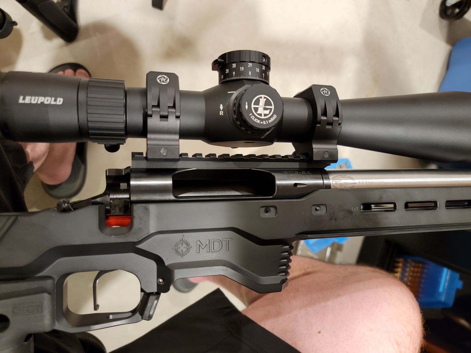

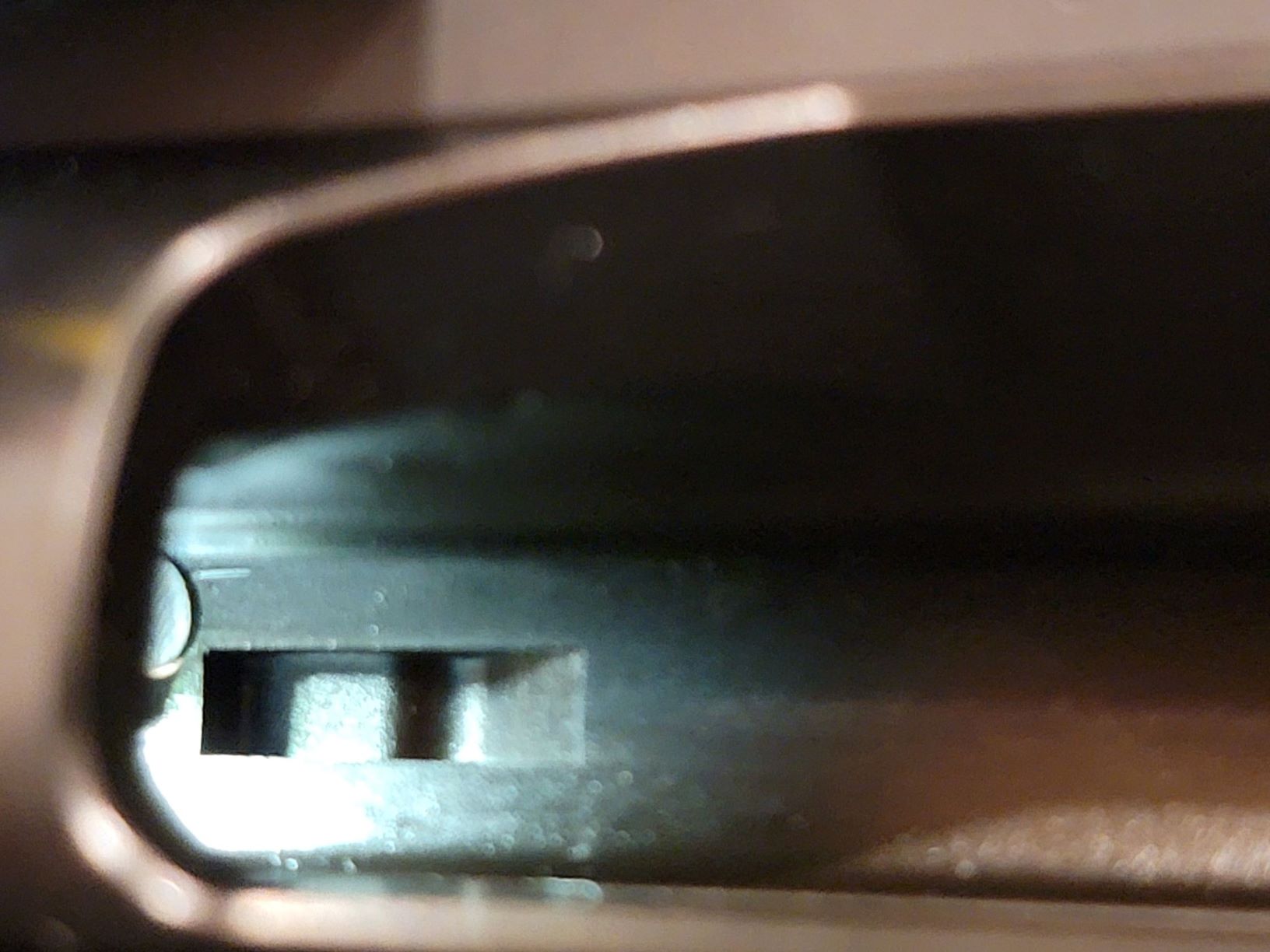

So first precision rifle build! Have brand new in box direct from Zermatt Arms Origin short action i'm using for my 6.5CM build. Finished the build and was going to the range tomorrow to "break in the barrel" and zero the rifle. Tonight I decided to cycle some round through it to make sure it feeds, extracts and ejects correctly. Feeds and extract fine but does not eject at all. I'm using MDT frame and mags. I tried empty casing and live rounds with and without the mag. No ejection at all. Not 100% sure where the mechanical ejector is but I believe it is supposed to be in this pocket in the pic that is empty on my action. Before I contact Zermatt Arms I would like to verify that i am correct.
