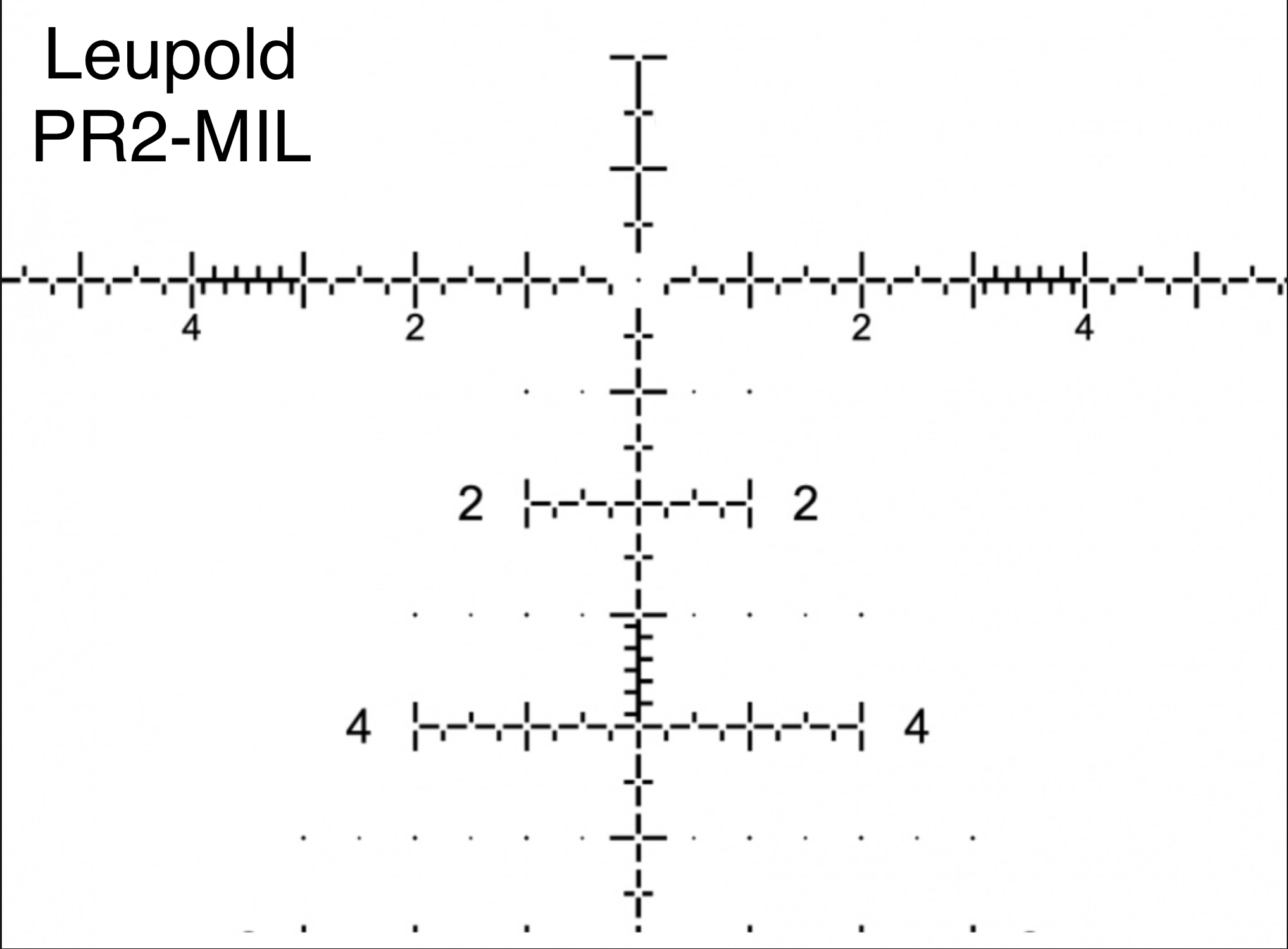

the comparison of the ZCO and Leupold is excellent and I could easily work with either. I am in the LE/MIL program for Leupold so that is a significant factor. If ZCO had one of those I would be interested.
I have written three emails to Leupold asking questions and the PR2 MIL and have not gotten an answer yet ..
