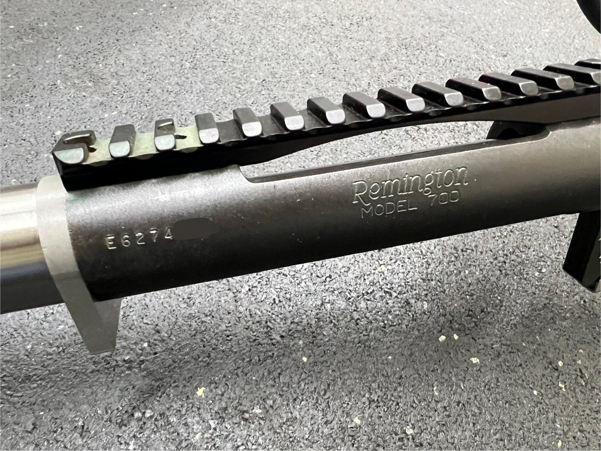

Building my first M40 for the Vintage Sniper matches.
This is a virgin Remington 700 RR prefix stripped receiver. It has no wear marks at all and has never had a bolt installed. I pulled the barrel off this receiver for the previous owner 2 years ago. The barrel is new and un-fired. I just hand screwed it on for the picture.
This will be for Vintage Sniper matches. The stock should be an original M40 stock.
I'll need a complete bolt, M40 compliant barrel, scope mount, magazine, stock metal, maybe a new recoil lug and trigger assembly. Can I use an upgraded recoil lug in the VS matches?
Any advice will be appreciated while I comb through the M40 archives.
I will be going with a Bartlein barrel.
