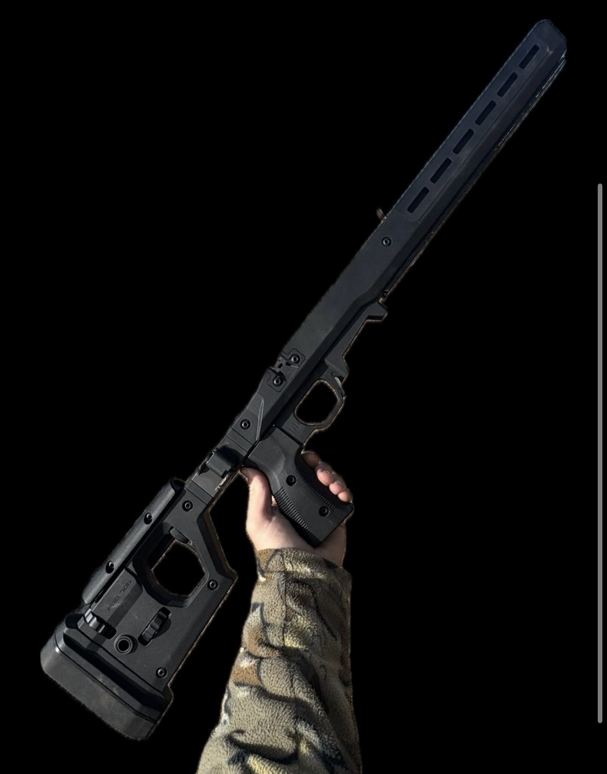

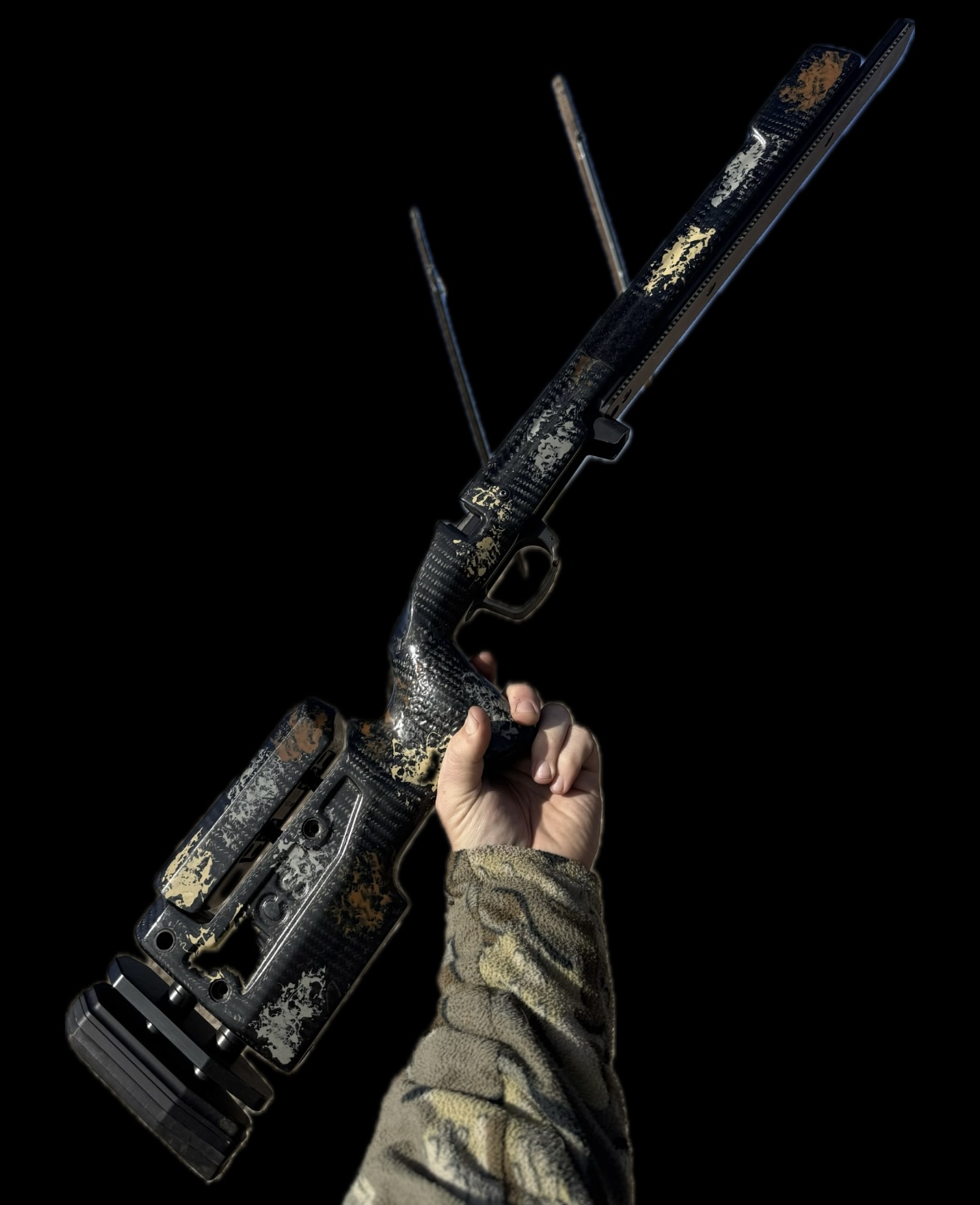

I acquired this rifle earlier this spring knowing it was only a good price at the time but not really exactly what I have a use for and I had a Manners LRH non-minichassis that I was kicking around selling so once I looked at the logistics of milling the stock and bedding it for the Anschutz, I held my breath and started cutting. Took me about 45min on the mill to get it real close, and got the pillars ready. Now I have to drill for the pillars and epoxy them and begin the wait
As far as the barrel, I wanted to try something new and with a little planning, I had my gunsmith cone the breach on a Kidd stainless barrel and with 50 rounds thru it, I found it really really likes SK and once the weather gets better, I have some center X to try.
Fun tinkering project, I don't have any reason to no think this will be a great plinker even if it is only a single shot
