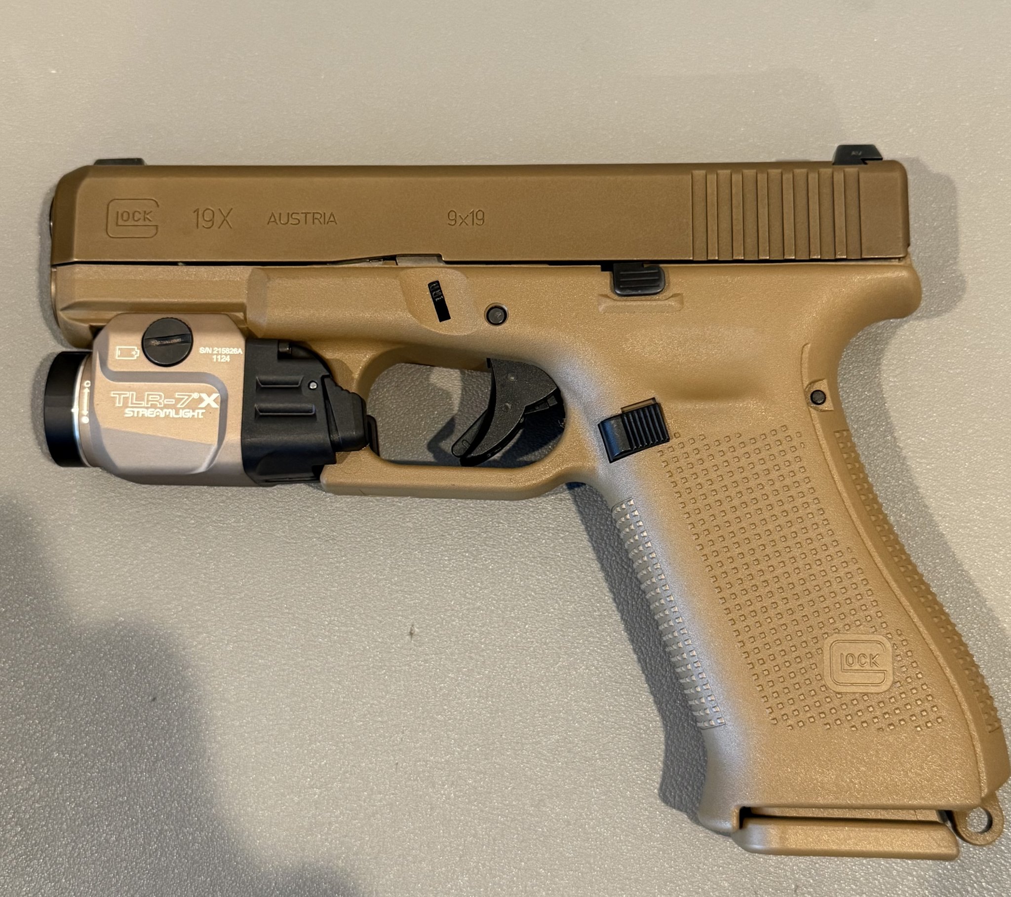

SOLD FS: Glock 19x brand new unfired
Glock 19x with 3 17rd magazines. Brand new condition unfired. Also comes with factory Glock case and paperwork.
*Light is sold. I’ll update pictures when i get home*
$515 shipped to your FFL
PayPal FF, Apple Pay, Venmo or Zelle
