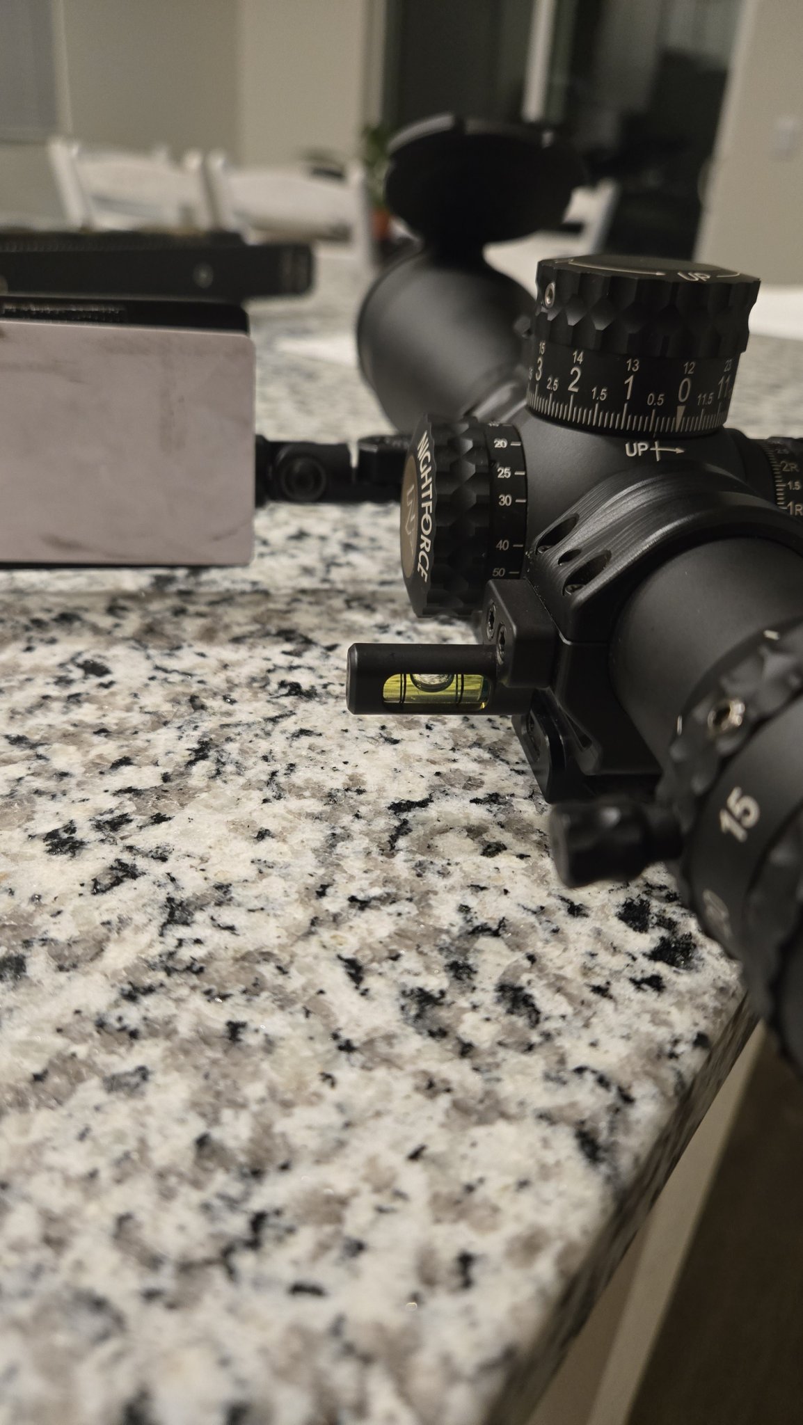

Leveling my scopes
I just don't get what's up with all the "tools" to do this. Here's my technique that has worked for literally years, and all you need is a carpentry level, a bubble level, and a pencil.
  1. Put your rifle in a gun vise and position with a wall several feet behind the butt
  2. Use the pencil and carpenter's level to draw a vertical line on the wall
    • If you're doing this in the kitchen or living room ... ask permission first :)
  3. Use the bubble level to level the rifle in the vise ... mount the scope rings or base and tighten to spec
  4. Loosely mount the scope on the rifle
  5. Point a very bright flashlight through the scope from front to rear - projecting your scope reticle onto the wall behind the butt stock
  6. Line up the vertical reticle line of the scope with the vertical line you penciled on the wall
  7. Gradually tighten everything down, making sure the rifle stays level and the flashlight reticle projection on the wall stays aligned and vertical
Declare victory and go drink a beer. If you keep the rifle horizontally level, and your pencil line is vertically level, and you keep the reticle and wall lines aligned during ring tightening ... this is fool-proof.
A great guy shared this with me years ago, and it works perfectly every time. The pencil line has been on my wall for years.
