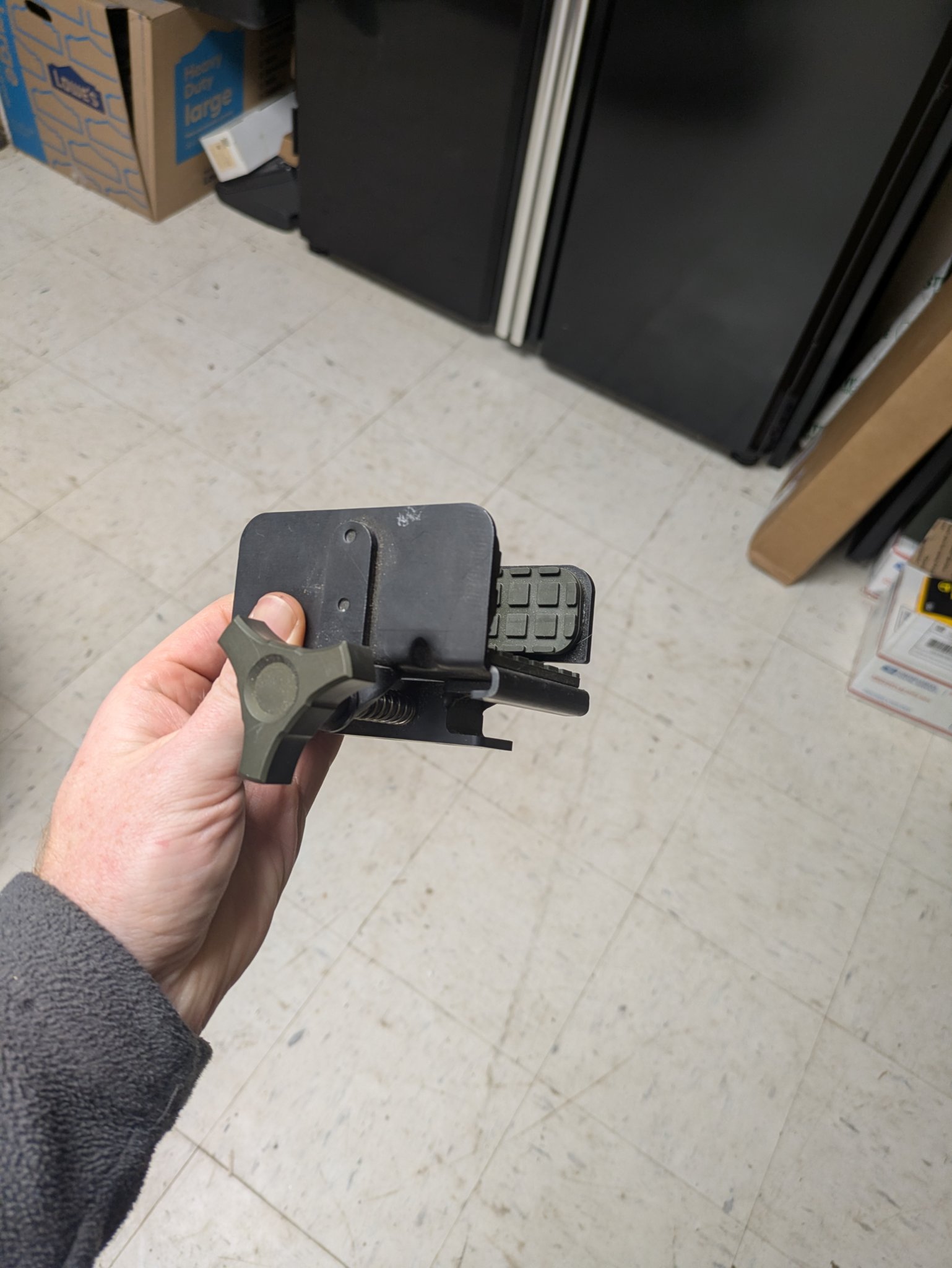

SOLD Shadowtech Pig Saddle
Shadowtech Pig Saddle in ODG. Not the newer version with the Arca built in on the bottom. Has the threaded holes to mount your own.
$90 shipped to you. Used a handful of times, just sits on the shelf.
