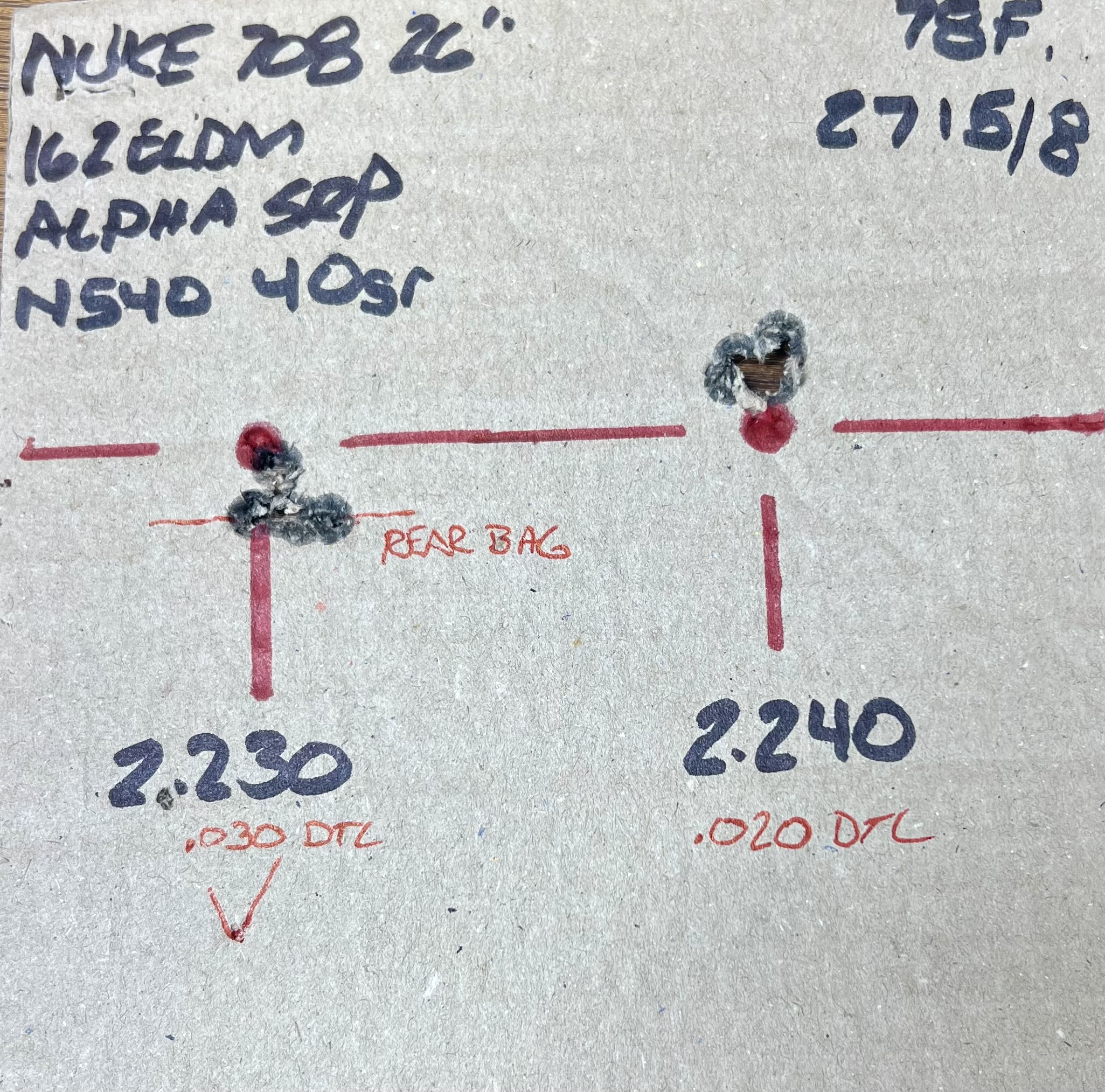

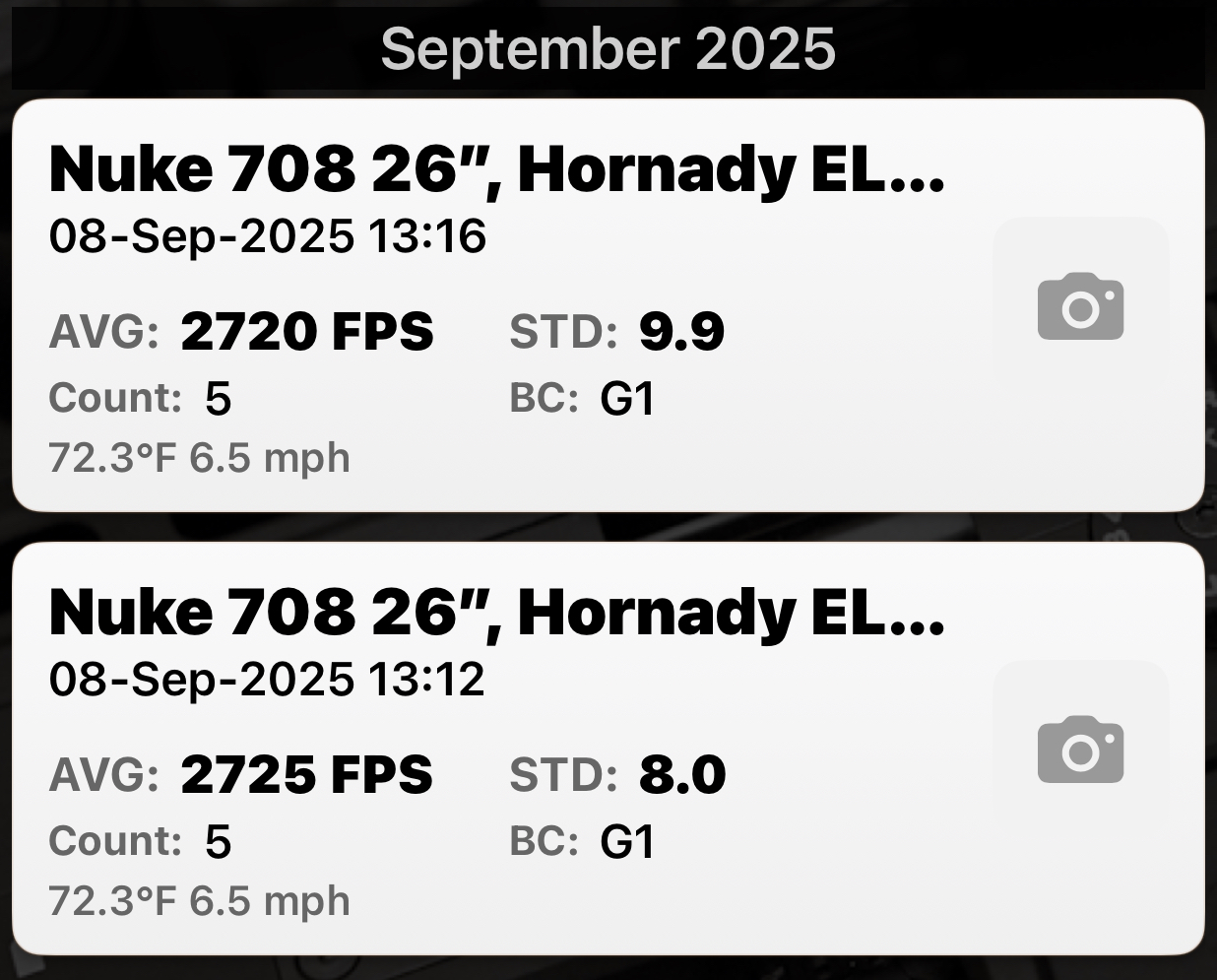

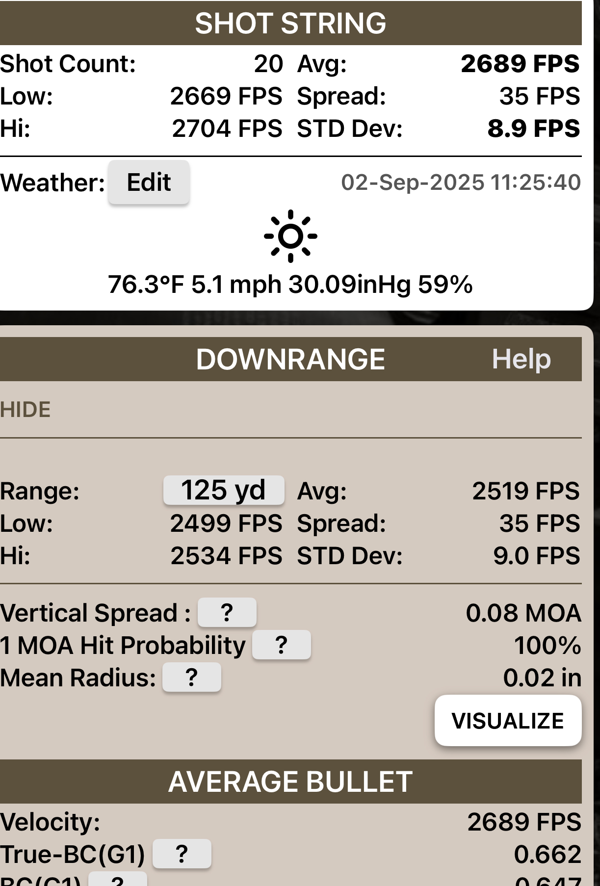

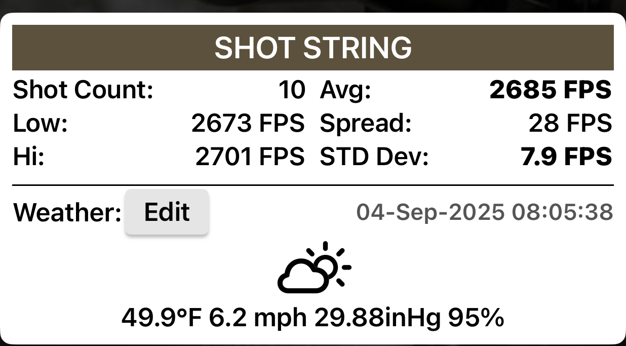

Initial 20rnds load development:
All new brass chambered just fine.
Shoulders didn’t grow even .0005
Case necks let a bullet slide in smooth with about .001 clearance
SRP didn’t ignite W760 good at all. Some delay ignition. N540 is doing it though.
Forgot to maintain my ears on that .030 DTL group…(Taylor’s Compromise)
Reactions: 6brshooter
