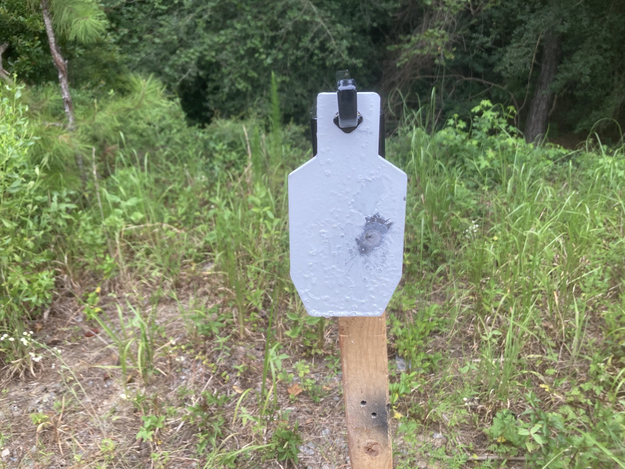

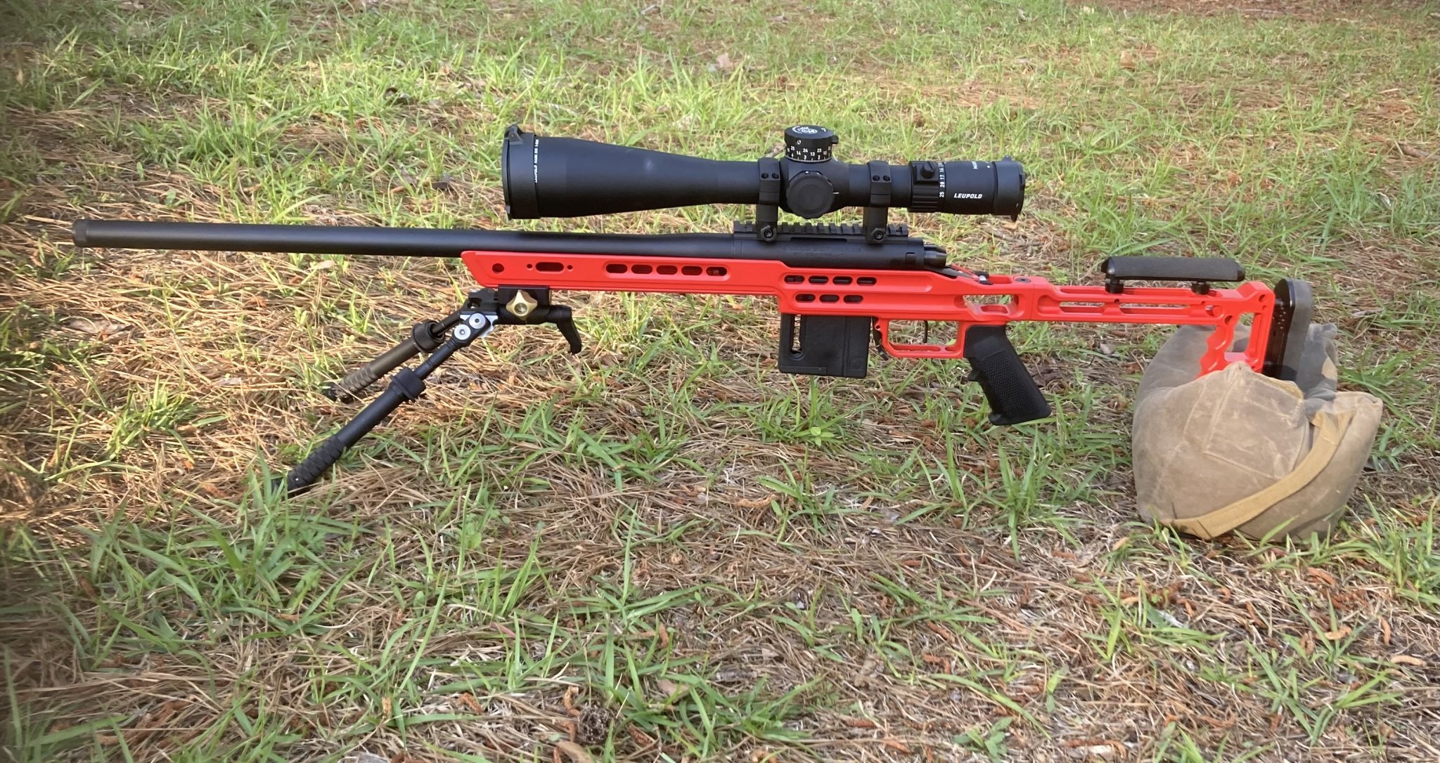

Folks, this is as good as I get. 116 yards, (furthest range we have available where we shoot close to our home) three shots, checking sight settings off a bench using a bipod and a bag. It’s not 1/2 MOA, maybe not even 1MOA, but surely it’s 1 Minute Of MiniGong. In Precision Rifle, that’s what really counts

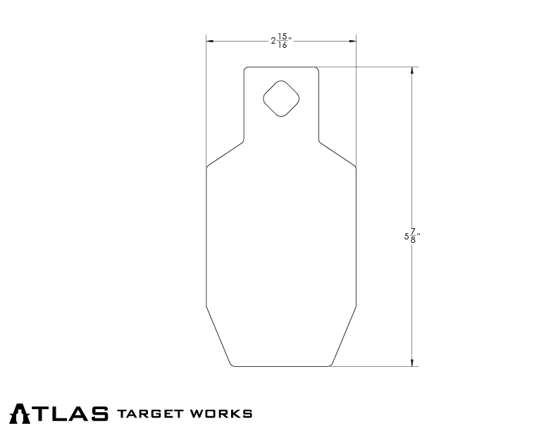

Shooting off a bag on a very shaky skill stage barricade, group sizes not so much, but still shot 81% for the day. Most shots were 100 yards or more. Targets were no larger than the mini gong.

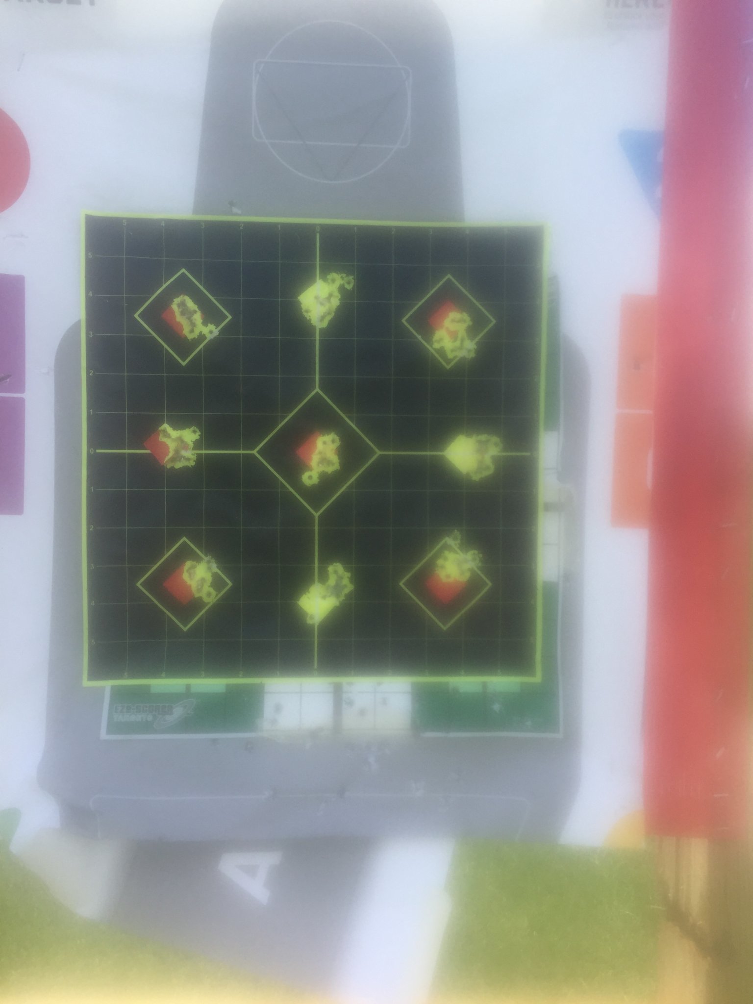

Im happy to get MOA@100 10 shot groups. I reprofiled some SK Standard plus last week with a Waltz die to Eley flatnose button and was impressed with the groups @ 50 and 100. I pressed from the stock .980 OAL to .960 and an ogive of .2255 from .224 and the main thing I noticed was less fliers and a little tighter group. My LabRadar recorded reduced SD's and ES's also, with a 1 fps increase in MVA. I didnt record readings at 100 just 50. Monday I am testing some TAC 22 that is pressed to the same ogive but I had to go to .950 OAL to get it. I thought I took pics of the 100yd targets but in the sun I was in slo mo and didnt realize it so they didnt come out. I attached the 50yd pic. Shot with a 457 pro.

Are you sure that wasn't pics of 100? That looks like MOA @ 100, and 2moa @ 50 if that's a 50yd picture. I assume those squares are 1 inch.
It might be.....I had a real bad day with pictures that day. My phone was reflecting and I pushed wrong buttons. It rained and the lense got steamed. Anyway the gun shot good that day. I was shooting off a bipod and no bag.
