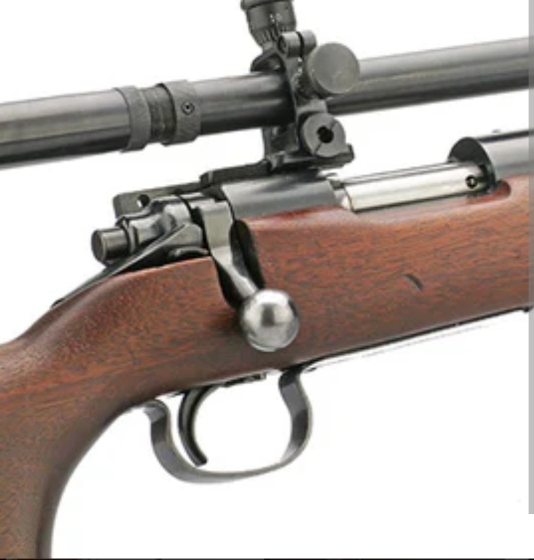

This is a 40X....it mimics the 722. Has the straight bolt. It came first.
This is a 40XB.....it mimics the 700. It came after the 40X.
Neither are a 722 or 700. They never were a centerfire at any point ever in their production lives. They started life in the custom shop. They appear to be what they appear to be. But on the inside....they they have their own unique construction and parts that makes them inherently a rimfire rifle. They are their own animals seperate of the their centerfire counterparts.
