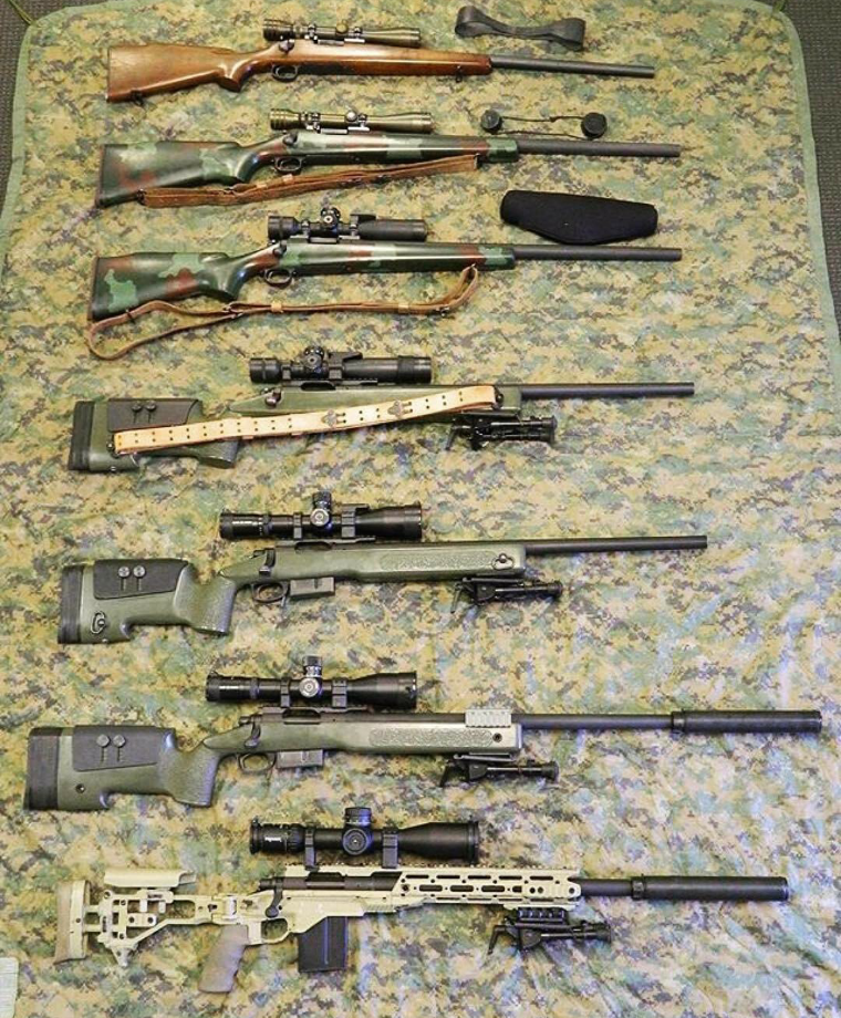

What's next....pics of every single USMC sniper rifle model ever used, topped off with original optics??
