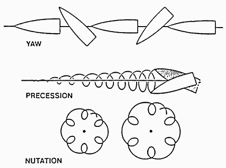

A solid copper or brass bullet is less dense than lead. As such to make an equal mass you need to add more material. You are limited by the bore diameter for a given caliber so the only way to get more copper in is to make it longer.
Length is really what twist rate is fighting, not mass. The longer the bullet the more the center of gravity and air resistance can move away from the center and thus it starts to pitch and yaw and if it yaws too much and catches the air resistance it starts to tumble. Spinning it faster let’s it’s rotational velocity cause the bullet to fall back into its center of gravity/axis of travel and thus not tumble as easily, or at least as soon. The forces sorta cancel each other out.
Yaws too much and it turns into a sail but if it spins back to the opposite side fast enough it will right itself and cancel out staying stabile in flight.
Spin it faster and it will have less time to yaw before it spins and the force turn the opposite direction so basically you just keep it falling into itself.
So that’s why solids are generally needing a faster twist rate than a lead bullet at a given weight. If you took a copper and lead bullet that are the same length and profile they will take the same twist, it’s just the copper won’t be as heavy.

Essentially: For a given mass, the longer the bullet, the FASTER it must be spun to correctly stabilize.
The classic "modern" lesson in this appeared with the .300 Whisper / Blackout. 1: 8" twist or tighter barrels are pretty standard in these.
This is simply because the projectile MUST be spun at or above a defined rotational speed or it will "go walkies" as soon as it leaves the muzzle. A 220gn jacketed spitzer tumbling through a muffler would not b a pretty sight.

Does the length of the bullet become an issue with a twist so fast that you begin to impart different twist forces at the front and rear of the bullet bearing surfaces?
Im guessing the the rifling would have to resemble machine screw thread to have the front of the bearing surface entering a whole different stage of rotation than the rear.
At some point pressure is going to win and just skid the bullet over the rifling.
Apologies for my thoughts if non applicable to the OPs question.
Just learning shit through smarter people.
My little experiment is not going to be on an ultra short barrel at 21 inches, nor is my twist drastic. with gain twist I guess Im hedging my bet and with only 21 inches to get the gain in how much will it matter?
In the case of overtwisting tearing the bullet apart, it's the length of the bearing surface, not overall length of the bullet. The bearing surface on a high BC bullet isn't all that different from a standard length bullet, i.e. a 147 FMJBT. A 220-250gr. standard ogive will have a long bearing surface. Which shouldn't be an issue at subsonic speeds.

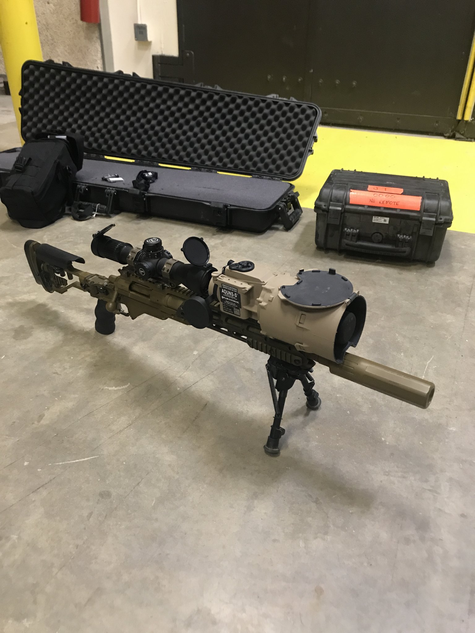

I have had experience with a rifle very similar, 1:8 twist tack driver bolt gun(pic below)
I have since had X Caliber build me a 16” 1:8 twist barrel for an AR build and it shoots good as well.
