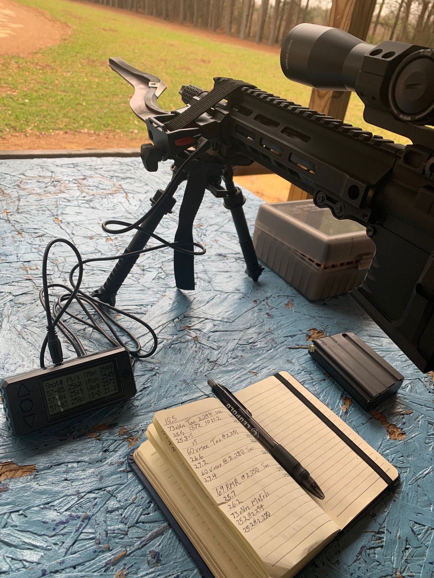

For me it is mostly a range toy, but still wanted good accuracy. That's why I went with the $275.00 10.5" 8T carbine gas Rock Creek linked earlier.
Rock's also have a reputation for being fast barrels & my experience aligns with that, so it factored in my decision.

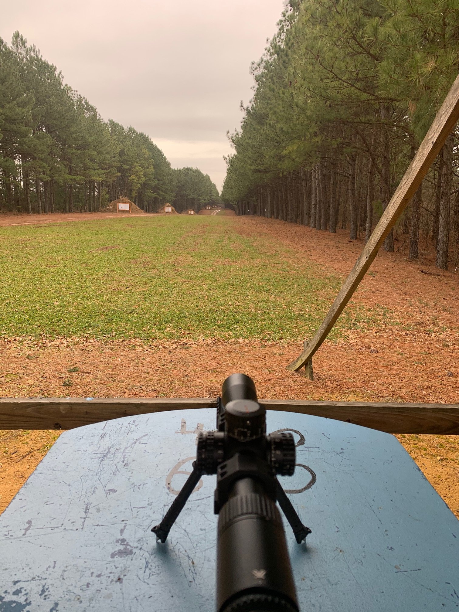

It's fun shooting 600y with a 10.5" AR.
First attempt with the 2575fps 73 eldm load was spot on for elevation, but I couldn't see splash from the misses (wind) via the 10x scope. Went 2 for 5 on the 8" plate @600y.
In reality though, the 2-10x was just on here for load development. I always intended this thing to wear a Vortex Huey & I'll just through a 3x behind it when I want to reach past 200.
The mid price Craddock was a bit of a pain to find good loads for & I suspect the signature series Bart would be a lot less picky.
Still It's a ton of fun and my 60gr Vmax load is stupid fast for a 10.5" using Tac.
Did I mention it's obnoxiously loud!!!

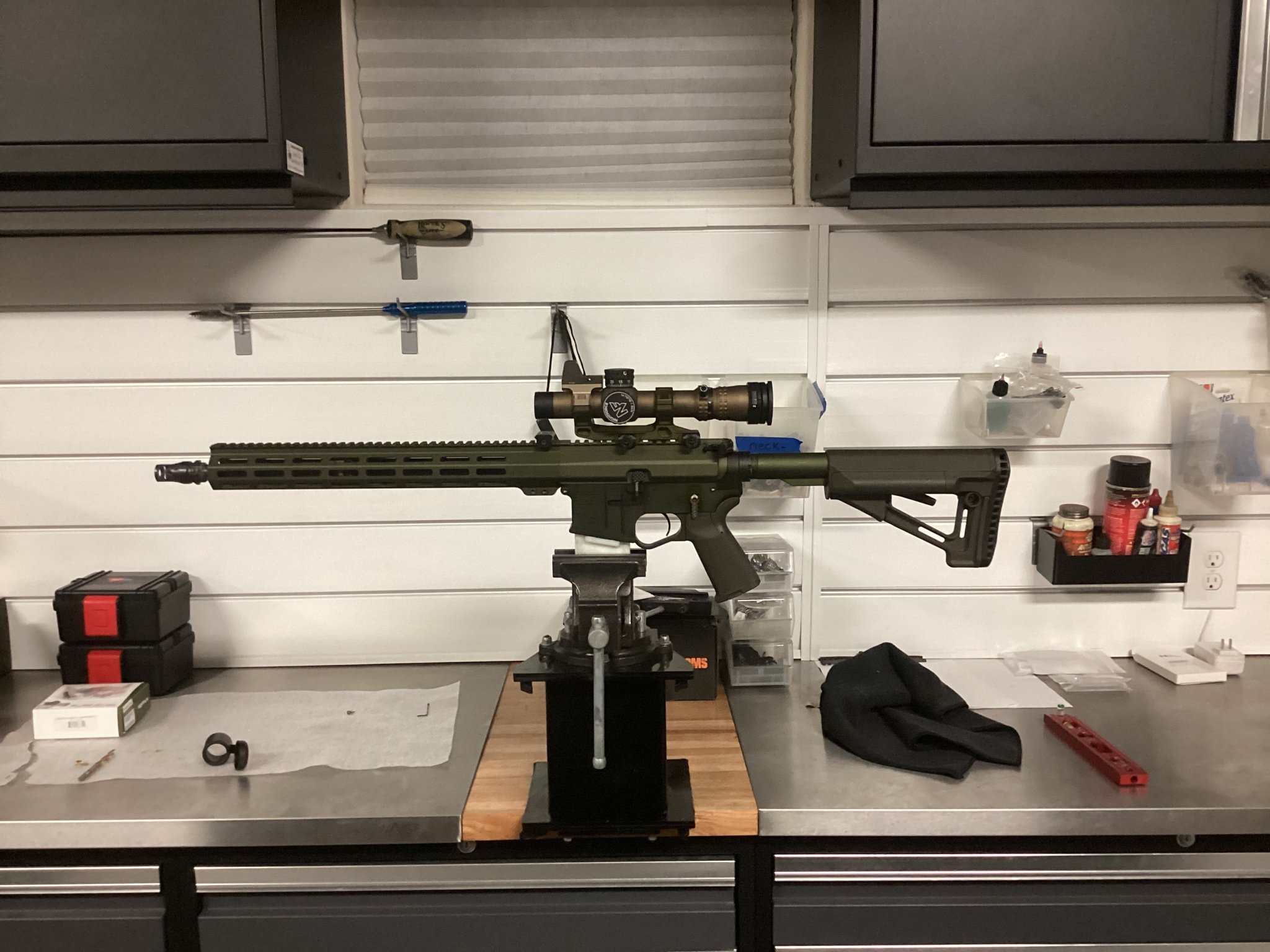

My current favorite:
Not sure it’s ’the best’ length, horses for courses and all, but it’s my favorite ‘do everything’ length for an AR chambered in 5.56mm. Long enough to stretch out to a couple hundred yards with ease, but short enough for pushing through brush with a can attached without getting too unwieldy. Or CQB work I suppose, though my only experience in that realm is in training
Have everything from 10.5”, and one 11.5”, all the way out to 18” on 5.56 uppers, but the ones that get shot the most are the 14.5” and 12.5” uppers. I prefer the 12.5” versions. Love my SBR’d lowers!
What length rail is that? Is the mlok useable by the suppressor?
15” rail over a 12.5” barrel. It’s a lot of fun to shoot, but yeah, a little limited on what accessories I can run in this configuration.
And haven’t attached anything there for exactly that reason…the nuts/attachment mechanism will clear, but the mount gets damn hot very fast. I’ll occasionally mount a light or IR designator a little farther back, but frankly this configuration is primarily, and best suited to daytime use only.
Still a lot of fun to shoot though!

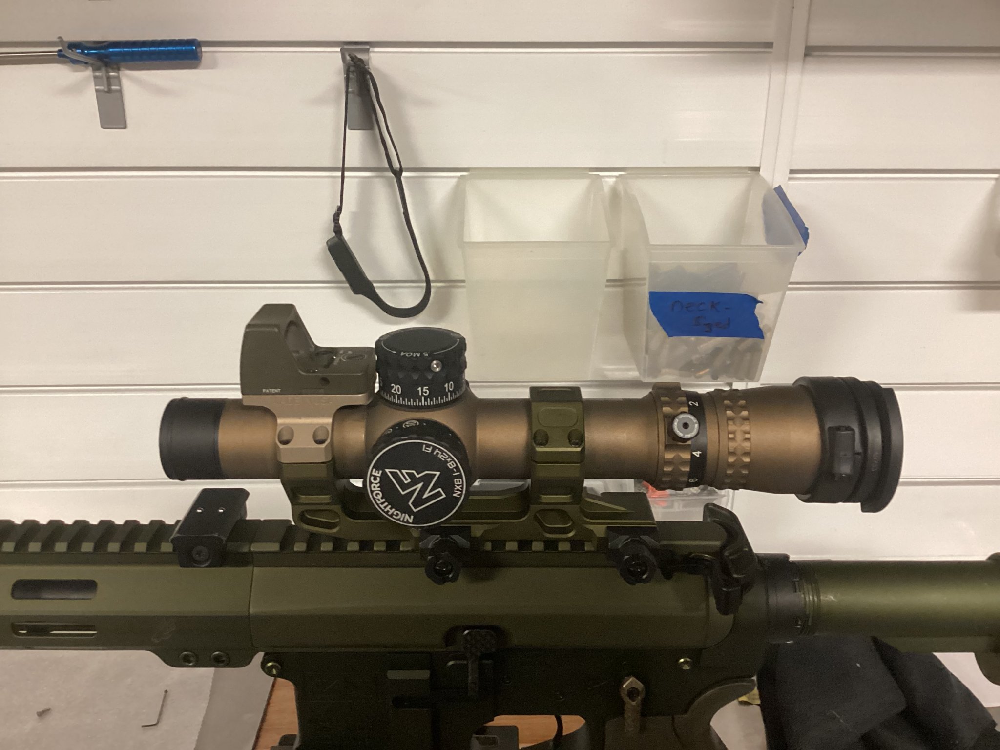

What color is the cerokote on the upper and handguard?
It was a custom blend trying to match the Reptilia AUS ‘FDE’ anodizing on that scope mount; I just really liked the way it looked. Mostly gold, but some FDE and a couple of tans mixed in as well as I recall. Plus a clear coat.
Nothing like having an accessory drive the major components of a build! LoL
