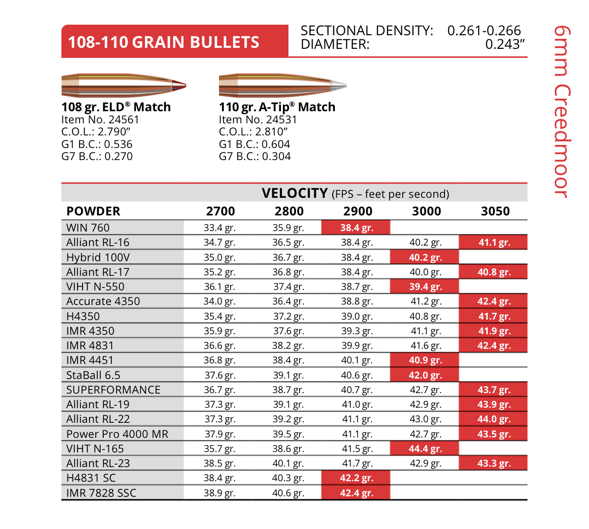

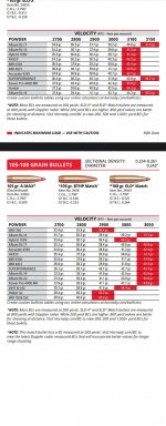

It's hard to believe that hornady and hodgeon would be that far out of synch. 41.7gr according to the hornady book.
Reactions: lash
I don't know how to take a screen shot, but Hodgon is showing 41.6 as the max with H4350 and 108's
Hornady's and Hodgdon's load data looks almost identical when comparing the same powder, case, and bullet.
BULLET WEIGHT
108 GR. HDY ELD-M
CASE
HORNADY
PRIMER
WINCHESTER LR, LARGE RIFLE
ManufacturerPowderBullet Diam.C.O.LGrs.Vel. (ft/s)PressureGrs.Vel. (ft/s)Pressure
Starting LoadMaximum Loads
HodgdonH4350BUY NOW0.243"2.770"37.82,80249,800 PSI41.63,00660,100 PSI
