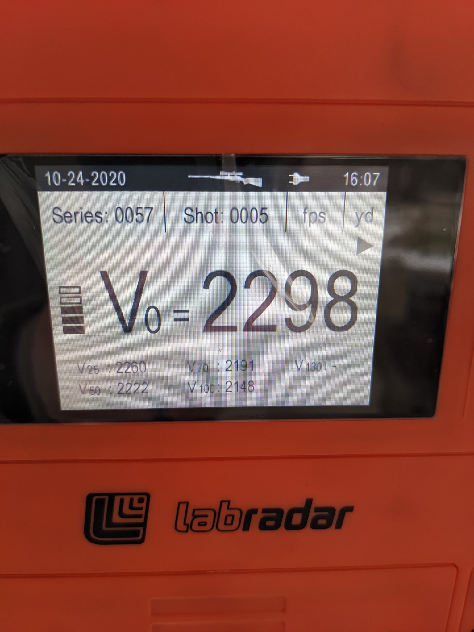

Thanks, I only recently found some LVR in stock so I'll be working on that more, hoping to get over 2400 fps. But yeah, this data (in 36 F) is a good match to G7= 0.283, and they've been great on deer. I'm not in a hurry to build an AR pistol given current possible regulation, but I love this round.

Are you willing to share what charge of LVR you're using with the 129s?
I've got both 12" and 16" barrels and with 30.3gr of LVR and a 129 ABLR I'm seeing ~2400fps out of my 16" but I'm only seeing ~2160 out of my 12", which seems slower than it should be. At 60 degrees I'm only seeing 2200 fps out of that same 12" barrel with factory Hornady 123 SST loads, so maybe it's just a slow barrel?
