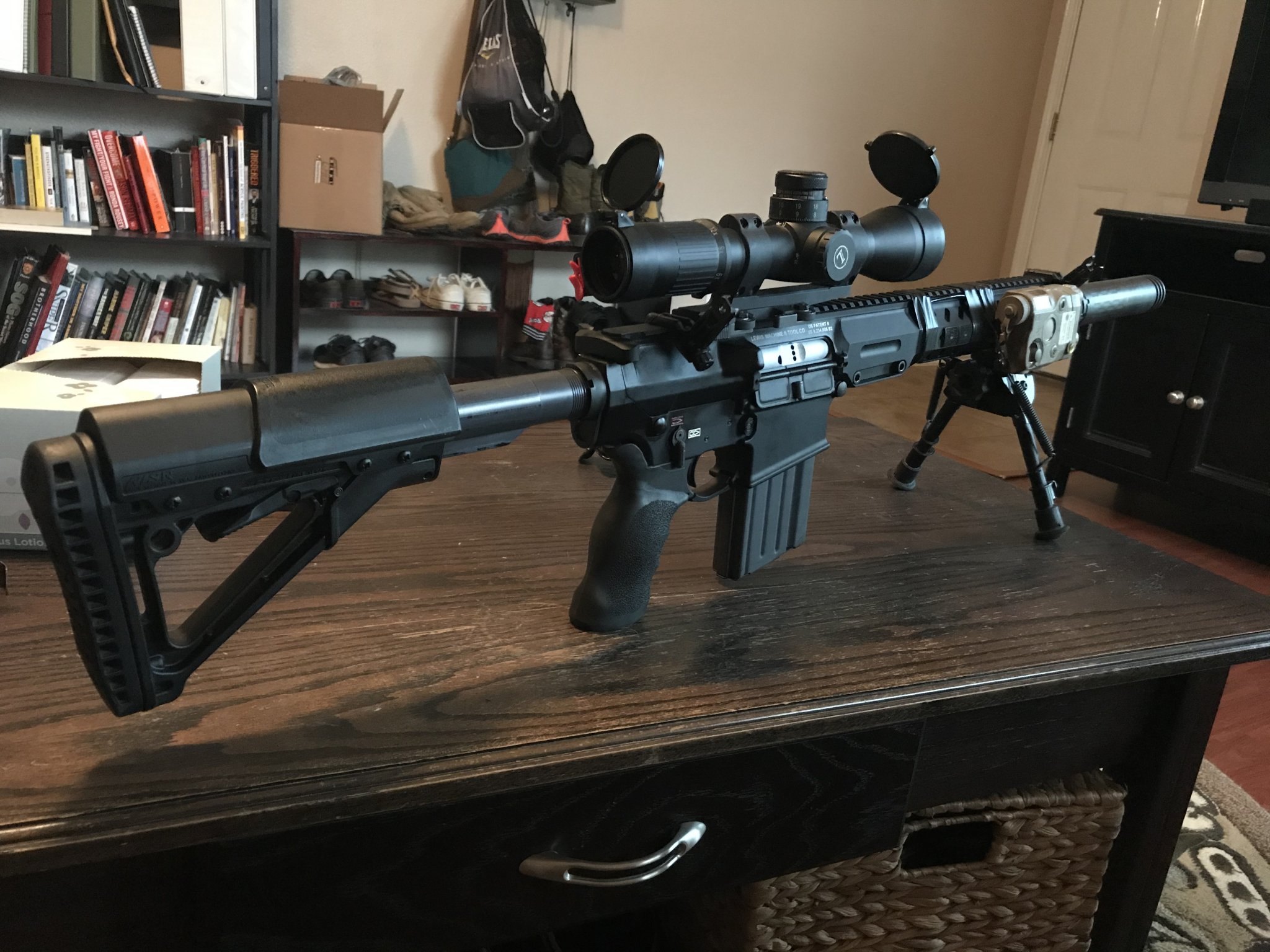

I have a 12" with mid length gas (POF), and run an AAC MK13-SD on it. I get fantastic accuracy from the 155 SMK and 155 GMX at 2375fps. I've only had it for a little over a year but have put a lot of time into making it run as smooth and accurately as possible. I do like it for what I use a compact 308 set up for. Drumming up your own loads to manage pressures and accuracy might be the difference in accomplishing that. I've taken it to 650 yds, rarely do I shoot it over 500. Beyond 600 - where I hit 130 inches of drop - it gets pretty difficult to put on 6x6 steel (for me it does). To put it in perspective, I have to adjust for a total of 130 inches all the way through 600 yds at which point the projo is still at 1450fps. The next 200 (600-800 yds) I get 152" of additional drop and lose an additional 225-230fps . That is just a huge degree of variation to adjust for every 25 yards not to mention how hard it is to manage wind at that range with a 155gr bullet at those speeds. Your ranging has to be perfect and your optic has to be best of breed. It's difficult enough that I just use a rifle designed for longer ranges rather than one that's set up for 500 and in for LR shooting.
At the end of the day, the specifics of your application should determine your needs. Is a 12" 308 a horrible choice? It could be. It's great for some and horrible for others. Depends. I love mine. It's accuracy is great at the distances I shoot with it, it's only 7 1/2 pounds, and the OAL with my can is what a 20" rig would be. FOR ME, those were important factors being weighed in the context of what I wanted to do with it as I made my decision.

I was apprehensive initially, but after talking with the guys out at AAC and describing loads, rate of fire (slow, no mag dumps) and some additional machining I had done to the POF receiver I was pretty comfortable with the set up. BUT, and it's a big but, I'm not running factory ammo. I'm hand loading specifically for this rifle to get max performance at lowest possible pressures and minimize excess powder hitting the blast baffle. It really limits my choices of loads, but it's a 308. It's going to sport a softball trajectory either way. Again, getting 9-10 ring hits at 400-500 yds is not very difficult with a 12" barrel - especially if you're running a top notch optic and can effectively range and correctly adjust for wind and drop. I'm running a Leuy MK 6 with H58. It's really a walk in the park unless conditions are really bad. If I want pinpoint accuracy at 750-1200 yds I'll take my 6.5CM. If I'll be shooting 1250+ yds I'll take my Lapua.
When I go hunting - black bear or mulie's for example - I'm usually humping along some tough terrain with a week's worth of gear. I haven't taken anything past 375 on those hunts. Taking those things into account, this 308 fit the bill for what I wanted in the context of my specific application.
Comparing a 12" 308 to an 18" (or hell, a 14.5", 16", 22" or whatever length you'd like to throw up there) with evaluation criteria limited solely to the best possible chance for a hit wouldn't really make sense. A 12" isn't meant to outperform everything at distance. It's value rests in an entirely different set of characteristics which would only be valuable to someone with use cases that matched those.
Anyway, that's just my 2¢ based on my experience...

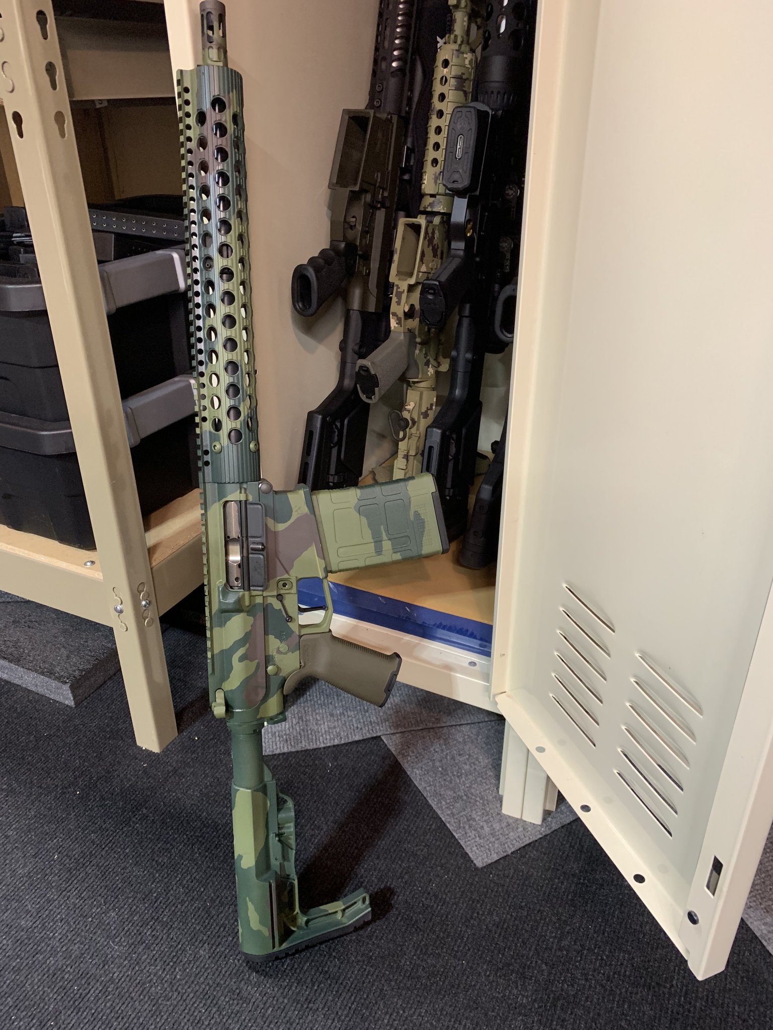

Here is a supressed 13.5 MWS next to a 16 inch SR25 ACC . Kac and LMT have both had short 308's down range for some time now.
