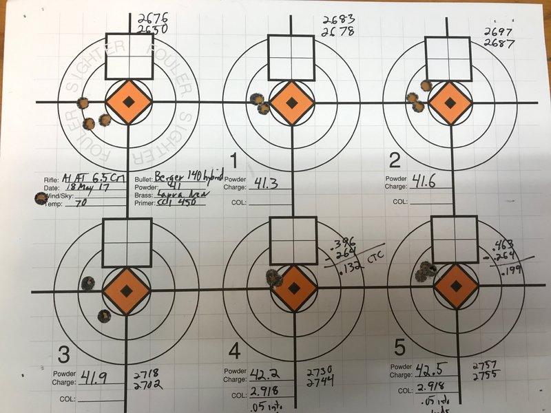

You can load as high as you want. You just need to be checking for pressure signs at each charge weight. When you get a heavy bolt lift and/or flattened primers then you can stop and not shoot any higher charge weights in your box. Take them home, pull the bullets and dump the powder. Simple as that. Only you will know how high you can go with your rifle....
OCW target in PDF and JPEG. http://practicalrifler.fr.yuku.com/topic/1269/OCW-OFFICIAL-TEST-TARGET#.WUrHmBMrIdV
I normally print these out on card stock paper so I get clean holes vs. tears in the paper. The grid with a consistent POA will normally show you when the barrel is at max whip and then begins moving back. I have found that using a Magnetospeed will change POI, but not change the results and having the velocity gives you an idea if that tight group that happens at a common POI will work or not.
